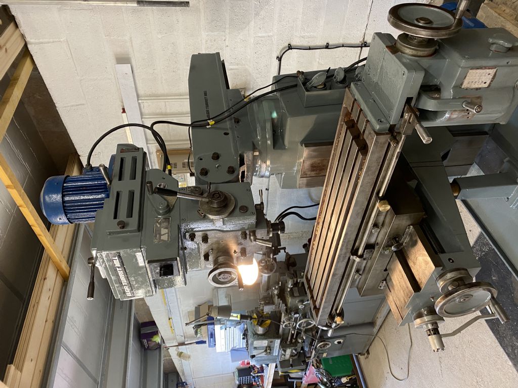

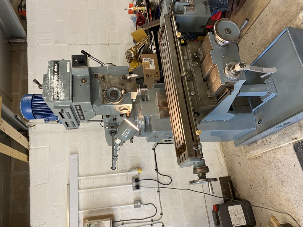

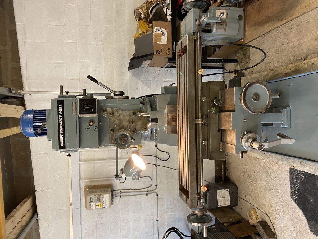

                            Steven Bray
                              @stevenbray71121
                              c791b233-48ef-4b4d-8166-592676151e92.jpegb7b1e88f-348f-4f39-9de2-2530255037be.jpeg9400a2c6-3fee-4a89-ba93-7191c731a3d7.jpegI took the plunge and bought the mill.
                              I replace every bearing including the spindle bearings, which cost a small fortune.
                              A complete strip down of the machine was required, every nut and bolt.
                              The slide ways cleaned up using scotchbrite
                              I rewired the machine new switch gear etc, stripped down the motors and re-varnished them.
                              Everything on the machine works as it should, the only thing wrong with the machine was a blown fuse in the antiquated wiring. 99% of the damage was because the machine was left outside.
                              A quick coat of paint and that was it.
                              With the price I paid for the machine and the cost of parts, it totalled around £1400
