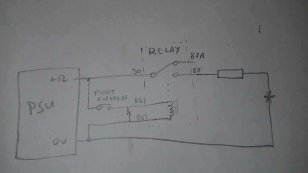

        I am trying to build a resistance soldering unit (RSU) for etched brass kits. I've managed to piece together all of the components, now whilst testing my electrical source, I've had an unexpected result… clearly my understanding is lacking!!
        The RSU requires max 3V DC (adjustable depending on size of piece) with a draw of order 10A.
        1. So I thought I can use my dcent DC bench top power supply (rated to 25A). However it's voltage adjustment is 8.0-13.8 V.
        2. So I then fitted an inline light dimmer on the mains input to the power supply BUT the output DC voltage is the same as before?! I can only think modern power supplies have some voltage regulation that maintains their stated output voltage range?
        3. Now I understand modern dimmers only function with AC, therefore my only option is to fit a variabe resistor at the power supply output, taking the wiper pin to the carbon electrode of the solderer –> I'm struggling to find variable resistors rated at ~ 30W
        Please can someone make suggestions. This is should be a simple task!

                    choochoo_baloo
                      @choochoo_baloo
                      Thanks all for the replies.
                      I actually managed to get hold of the electrical technician at the physics department. He kindly drew out this circuit diagram, and explained why each component (the relay is essential) is required for safe and reliable operation.
                      For simplicity of construction he recommends this design, obviously it's just a good ol' voltage divider. Attached his diagram below for reference in case anyone else fancies building an RSU.

                          Posted by choochoo_baloo on 22/06/2018 17:55:14:
                          Except he's not covered the tricky bit which is the value of the resistor. It's going to get hot! What value should it be and is it practical? (Hope I've got it wrong – back of my envelope says 11 ohms radiating 350W to get 5.5A into a 1ohm electrode. )

                                  choochoo_baloo
                                    @choochoo_baloo
                                    Posted by SillyOldDuffer on 22/06/2018 18:25:29:
                                    Thanks for your contributions Dave. I shall update this thread once it's assembled and I've done a few trials!
                                    He did describe the resistor value etc – I forgot to mention it above. I've ordered this 1.8 ohm power resistor (50W rating)
                                    https://uk.rs-online.com/web/p/panel-mount-fixed-resistors/1074096/?relevancy-data=636F3D3126696E3D4931384E525353746F636B4E756D626572266C753D656E266D6D3D6D61746368616C6C26706D3D5E285C647B362C377D5B4161426250705D297C285C647B337D5B5C732D2F255C2E2C5D5C647B332C347D5B4161426250705D3F292426706F3D3126736E3D592673723D2673743D52535F53544F434B5F4E554D4245522677633D4E4F4E45267573743D3130372D34303936267374613D3130373430393626
                                    Should also say (arguably the most important parameter of the RSU system) that I measured the carbon electrode to brass sheet resistance to be 0.4 ohm. Therefore:
                                    The nominal current is 12/2.2 = 5.5 A, yielding a dissipation across this ballast resistor of (5.5^2)*1.8 = 54W. The technician reiterated that small duty cycle (given that the circuit is only live for ~< 2 s at a time) means that the ballast resistor's rating of 50W is adequate.
                                    Finally, the "flyback diode" across the relay coil prevents a large voltage spike (and therefore arcing across the foot switch) by providing a way for the current flowing in the coil (which is an inductor) to dissipate harmlessly upon breaking the circuit.

                                      Posted by choochoo_baloo on 22/06/2018 21:22:18:
                                      Posted by choochoo_baloo on 22/06/2018 17:55:14:….
                                      Whoo whoo, looks good, your maths beats mine! One way of improving the cooling is to mount the resistor in a sealed 5L paint can full of new engine oil. Transformer oil is best, but any heavy oil (preferably without additives) will do. H&S common sense applies – don't boil the oil!

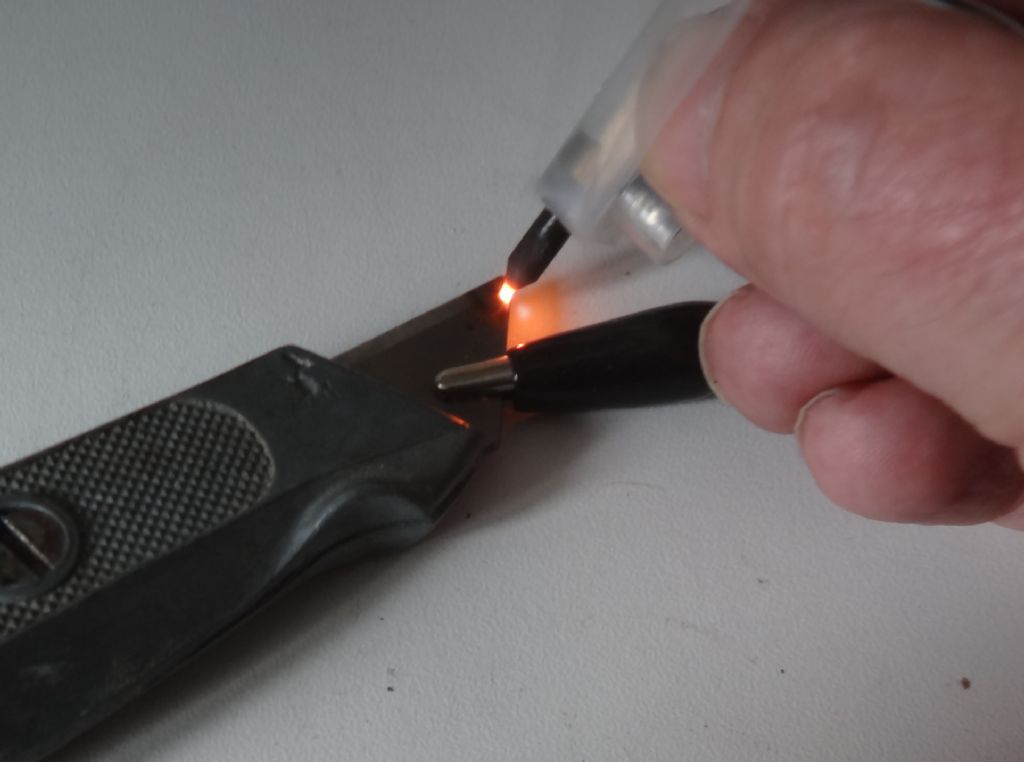

                                                    Here's something for you to contemplate, Dave:
                                                    Decades ago, I was given an 'XP Welder' <phew, glad I didn't pay for it>
                                                    This contraption, which was also marketed as the 'Rawlplug Welder's Mate' , allowed one to arc weld [using flux-coated rods] using car batteries … The handle included a buzzer solenoid which kept the arc going, and avoided sticking.
                                                    The interesting bit is that it also featured the facility to mechanically lock-out the buzzer … a carbon rod then replaced the welding rod, to allow resistance brazing.

                                                      Posted by Michael Gilligan on 24/06/2018 07:10:30:
                                                      Here's something for you to contemplate, Dave…
                                                      Yes, I believe you. Used with care, I think it could be done safely.
                                                      Nothing to to with Resistance Soldering, but reading about arcs led me to this fascinating paragraph on Wikipedia:
                                                      Arc flash is distinctly different from the arc blast, which is the supersonic shockwave produced when the uncontrolled arc vaporizes the metal conductors. Although both are part of the same arc fault, and are often referred to as simply an arc flash, from a safety standpoint they are often treated separately. For example, personal protective equipment (PPE) can be used to effectively shield a worker from the radiation of an arc flash, but that same PPE may likely be ineffective against the flying objects, molten metal, and violent concussion that the arc blast can produce. (For example, category-4 arc-flash protection, similar to a bomb suit, is unlikely to protect a person from the concussion of a very large blast, although it will prevent the worker from being vaporized by the intense light of the flash.)
                                                      Health & Safety gone mad! In the good old days chaps were protected by nothing more than a flat cap, and they were happy to be vaporised at work. Apprentices were blown up twice a day unless the foreman fancied them.
