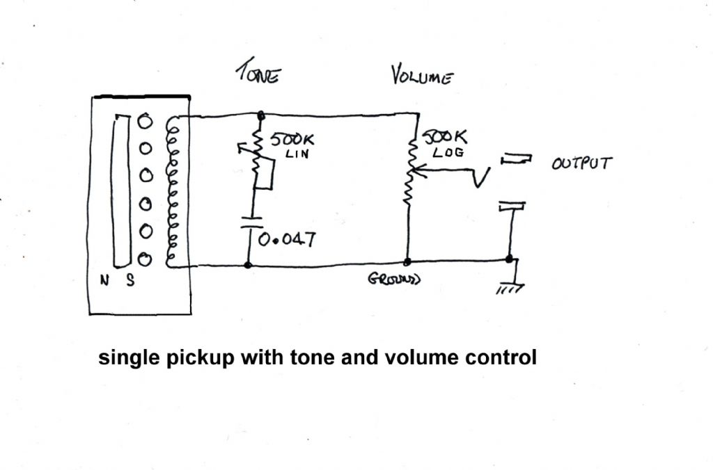

                          we need both photos of the guitar and detailed photos of the wiring from Dave Trafford
                          but it could of been the guitar from Every Day Electronics Nov 72
                          photo from advert
                          example wiring

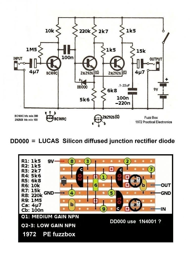

                            I have seen a post which mentions the Treble boost and Fuzz box which I remember were built into the Guitar

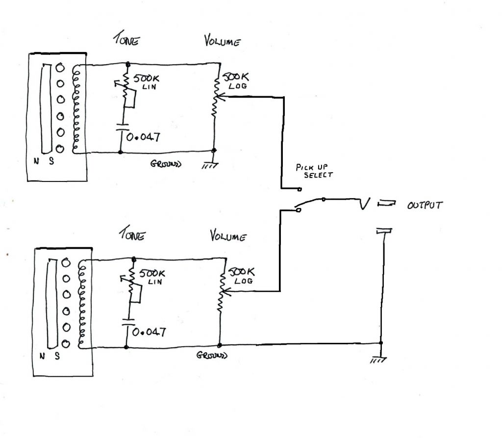

                                without the blue print or detailed photos to be able to reverse engineer your guitar
                                I can only guess the guitar is wired like this
                                with this fuzz box built in – circuit found on the net
