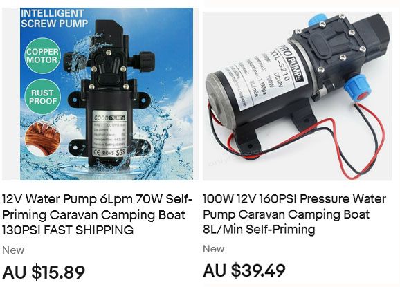

                  Fizzy,
                  These are the pumps that I am referring to that are used in caravans and RV's. Available with pressures of 130 and 160 PSI.

                    They are not the same sort of pump as used in the UK. Our pumps are submersible in a 40 litre barrel. I have one fitted to my driving trolley for topping up the saddle tank on the loco but it would not have anywhere near enough power to overcome boiler pressure.

                        Michael Callaghan
                          @michaelcallaghan68621
                          Posted by Paul Lousick on 04/09/2022 10:10:10:
                          Fizzy,
                          That’s the sort of pump I have in my tender under the water tank. Works very well. And I am in the U.K.

                            I wonder what it's like to shower under a 10 bar pump.
                            Just because it says Caravan Camping Boat doesn't mean it's really suitable.

                                " what it's like to shower under a 10 bar pump" These are low volume pumps and no problem if you use the correct shower head.
                                Like the multi-purpose nozzles that you use on a garden hose. Select a single hole for a high pressure jet of water or one with many holes for a soft shower. The pressure in the water supply to the house remains high but the pressure at the nozzle discharge is lower because of the larger surface area.
