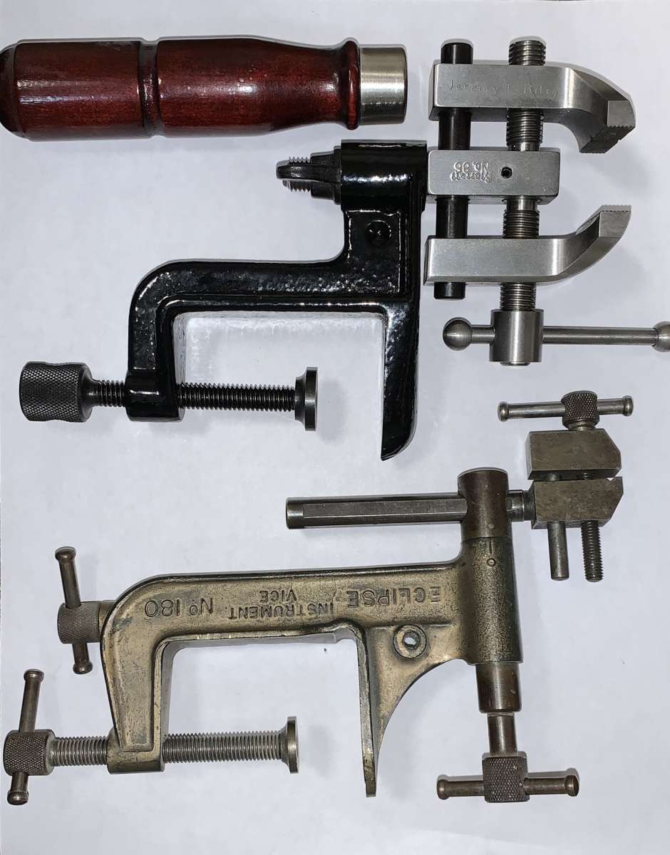

      During our enforced clear out we are digging into stuff that we bought years ago and have never got around to fixing, this includes some of these ECLIPSE No:180 instrument vices which are absent the actual small vice section as ringed in the photo.
      I wonder if anyone might have one that they could take some measurements from for me so that I can make a couple to complete the tools.
      Just a "back of envelope" sketch with sizes and thread size etc would be really helpful
      The castings are a real work of art as can be seen but the rest of it should be within my limited capability. I would make the jaws from a low carbon steel and there is a small firm near me who can heat treat and surface grind them for me.
      BTW if anyone does have one of these do look after it as they are quite a valuable tool, often making £100 or more if boxed!

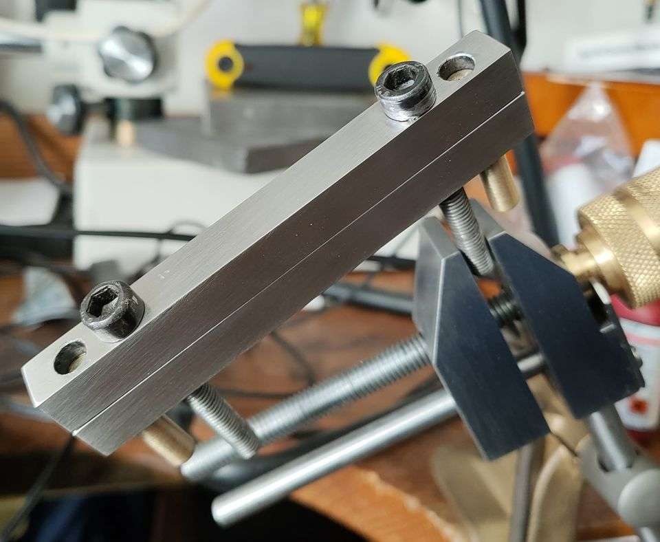

            Hope you don't mind but I just had to dig out my old masterpiece from school GCSE metalwork class. Not quite up to the same standard as the eclipse but not bad for a spotty kid! I always wondered where the school got the design from, must have copied it from the eclipse model.

                              Was given an Eclipse  235 Vee vice., as illustrated by Nicholas
                              A very nice piece of kit, beautifully made.
                              Not used all that often, but how useful when needed! And joy to use.
                              Howard

                                What is the extra small horizontal hole for (next to the cast “Eclipse”).
                                I like the composite Vee tool; clever extra use.

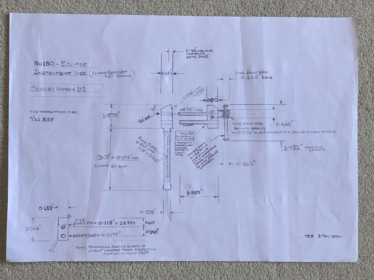

                                  Hi Martin
                                  Here is a sketch with some measurements and notes made from my Eclipse Instrument
                                  Vice No.180.  Hope it helps.
                                  Best of luck with your project.

                                  jaCK Hobson
                                    @jackhobson50760
                                    Nice sketch TimIfileguidevice
                                    I made mine a little larger

                                    Hopper
                                      @hopper
                                      That is a good question. No obvious answer occurs. I see the Starrett version in Toolnut’s pic above has a dimple in the casting in the equivalent place, but no hole. Interesting. Some sort of location hole for holding the casting during factory machining perhaps? Or not.

                                                The 235 composite Vee vice is beautifully made, mine is still in it’s original wooden box. Noel.

                                                  P.S. __ It seems that none of us has yet found an ‘official’ answer to Bazyle’s intriguing question about the cross-hole in the No.180
                                                  … I’ve wasted a lot of time searching, but found nothing.

                                                      It must be to hang it on a nail on the wall then.
