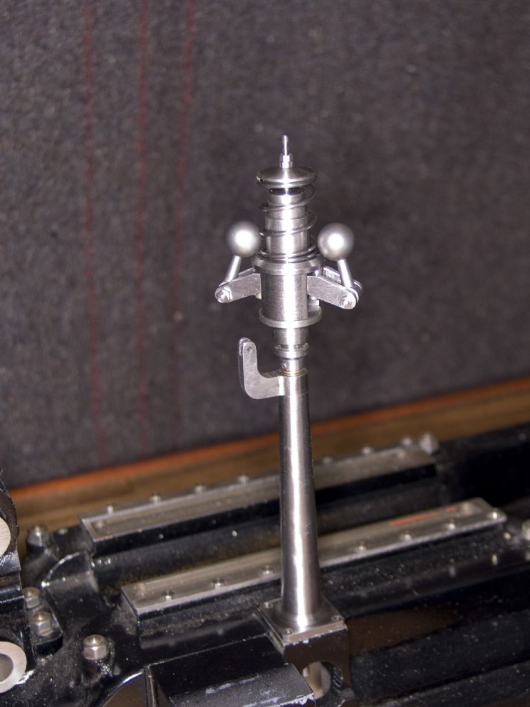

      I am about to finish a model that has a governor using two 5/16" diameter stainless steel balls as bob weights. These are highly polished and far brighter than the rest of the steel work. I want to reduce their shine without using paint or damaging them (each has a tapped 10BA hole for the governor arms).
      At the moment I am seeing if citric acid (the strongest acid I have and am prepared to use) will etch the surface (using a spare ball). However this does not seem promising.
      Does anyone have any ideas?

          Scotchbrite if you want a matt finish. Steel wool and oil if you want a dull lustre. Spin the balls at high rpm and apply.

                                    I bead blasted mine with a fine glass bead.

                                                  I put a spare stainless steel ball in Harpic Original Limescale Remover for 18 hours and the result is a nice light gray satin finish.
                                                  Many thanks for all the suggestions.
