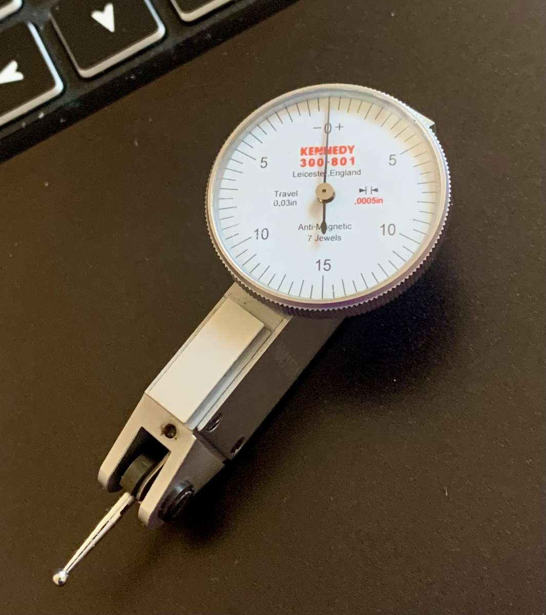

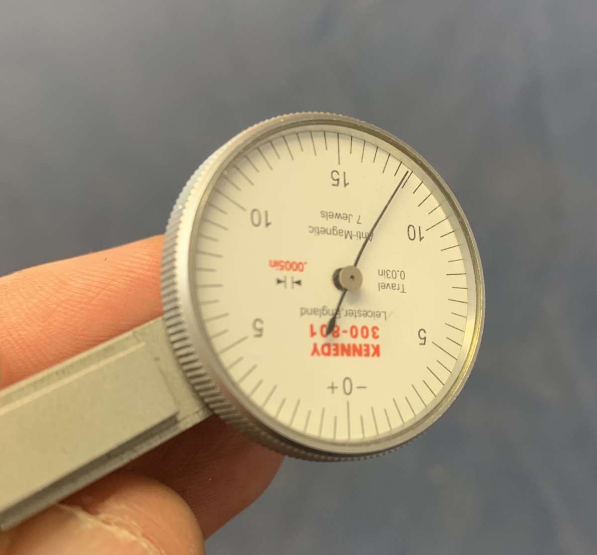

      All, Does anyone know how to remove the glass/bezel from this DTI?
      The needle is bent and I’d like to straighten it if possible.

              Mine’s re-branded Kennedy, which isn’t on the list. No idea who made it.

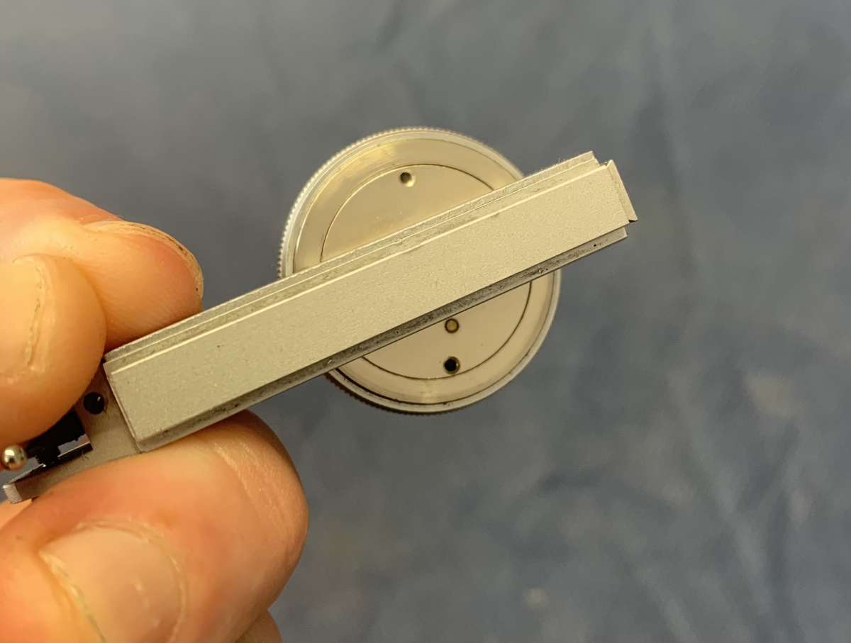

              I noticed that looking from the back, the outer silver ring moves round with the bezel, so assuming the bezel is fixed to that, there’s no way it’s coming off.
              I tried prying the bevel off, but it’s clear that much more force would result in damage.
              Removed the side plate to see if that revealed any securing method, but only a couple of screws holding the face on (which I assume in turn traps the outer ring in place).
              So…I’m stumped. I assume that the bezel is assembled first, then the glass (plastic) is pressed into the bezel. So I need to pull the glass out of the bezel. I wonder if hot glue on a stick would do it? how difficult is it to replace the glass – does it need a special jig?

                  Thanks Dave. I admit that sometimes as a relative newcomer to model engineering, I’ve done daft things that have resulted in “non-optimal” situations with various tools!
                  I think in this case it must have been an acceleration of the needle that possibly casued it to bend.
                  It appears to work fine and is still smooth.

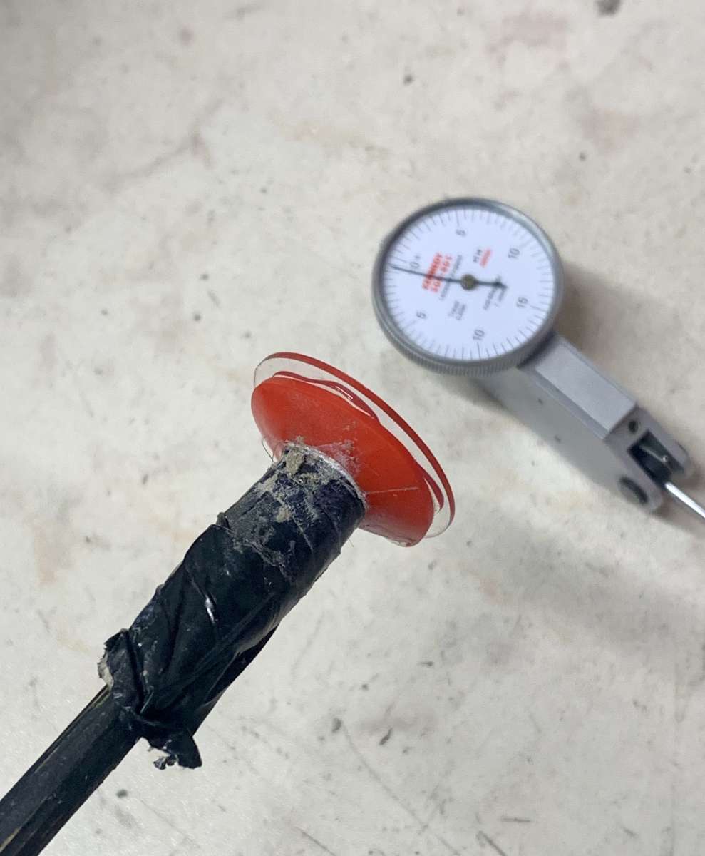

                        Mission accomplished.

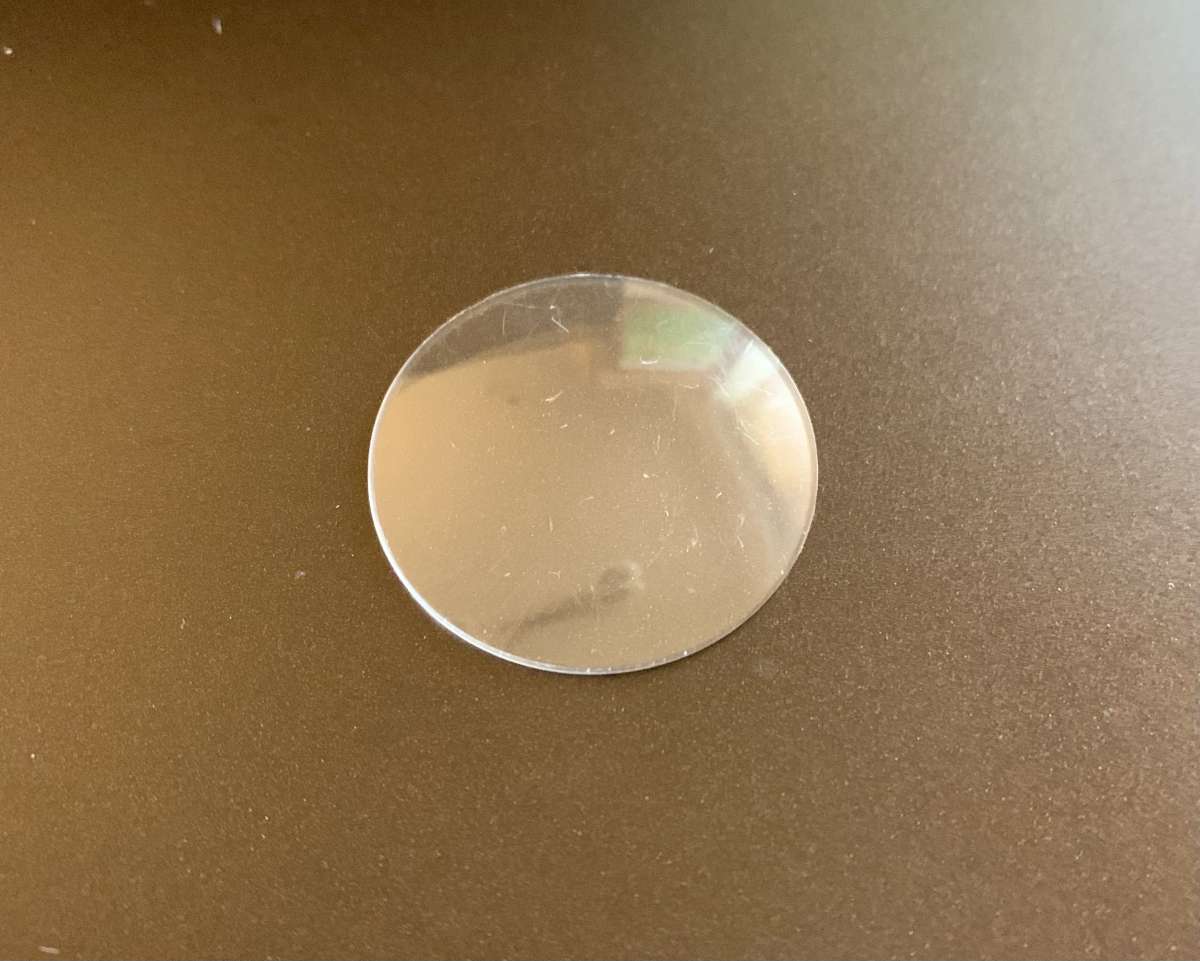

                        I found an old arrow with a sucker on the end. The sucker wasn’t strong enough to do anything, so I used hot melt glue to help it. Pulled straight off with no problem:
                        IMG_7774
                        The glue took some removal with a blunt knife and some IPA, but cleaned up fine:
                        IMG_7775
                        Straightened the needle as best I could (it’s angled down slightly towards the face I think), and re-fitted the plastic, which was pretty easy after working it back into the bezel by rolling and working it against the kitchen table:
