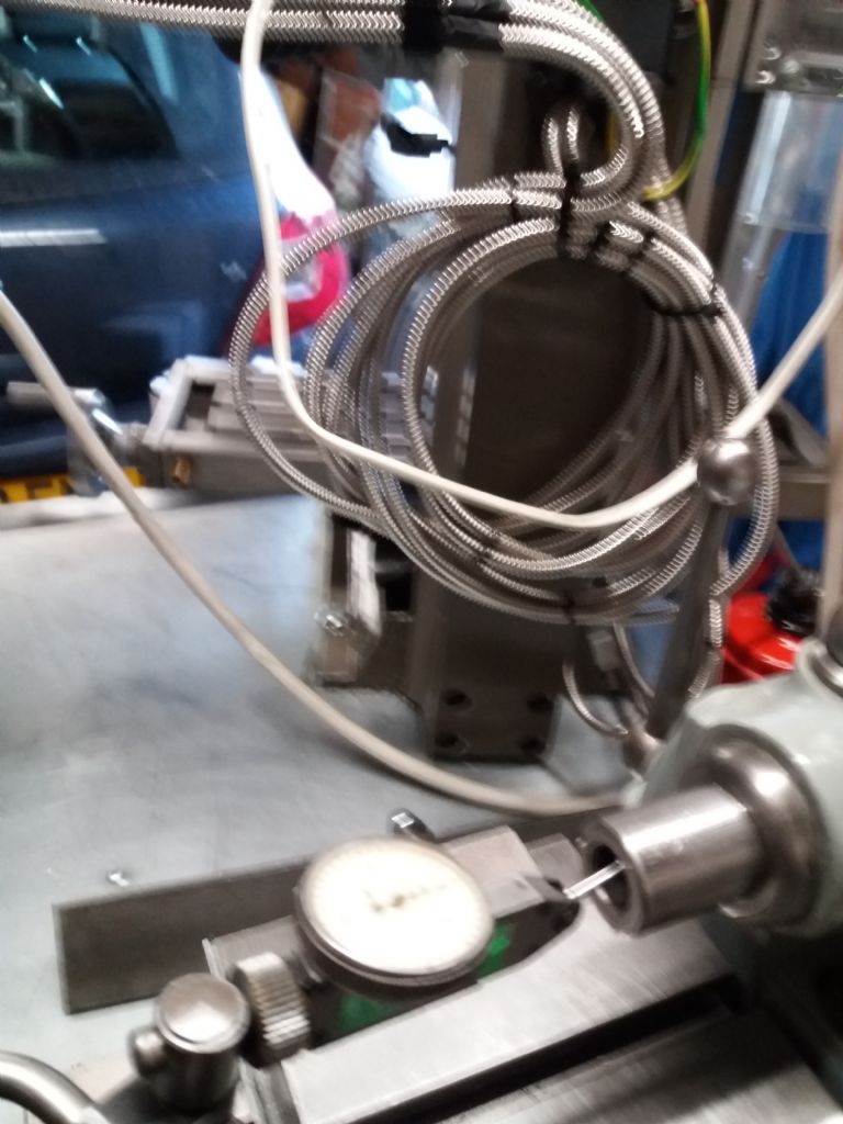

              Hi Daniel you should be able to repeat the alignment of your tailstock unless as it is not adjusted correctly or you have significant wear. I set my tailstock by mounting a lever type dial indicator in the chuck on a bar so it can be rotated and adjust till I get s zero reading, top to bottom and side to side.
              I then clamp and unclamp and repeat and look at dial indicator to see if it moves. I recently modified my M Type to Morse No2 taper and had to make a new quill and when I had checked the center the second hand casting I used was about 5 thou low so I had to shim between the top and bottom castings. I hope this helps and as previously mentioned check the clamp down bolts are tight when checking, slacken to adjust with cross bolt and check that the base clamp is adjusted to clamp on the bed angled piece.

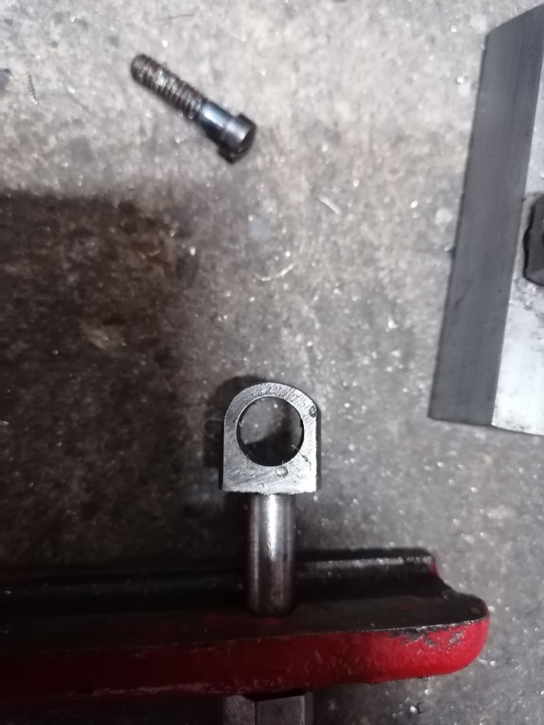

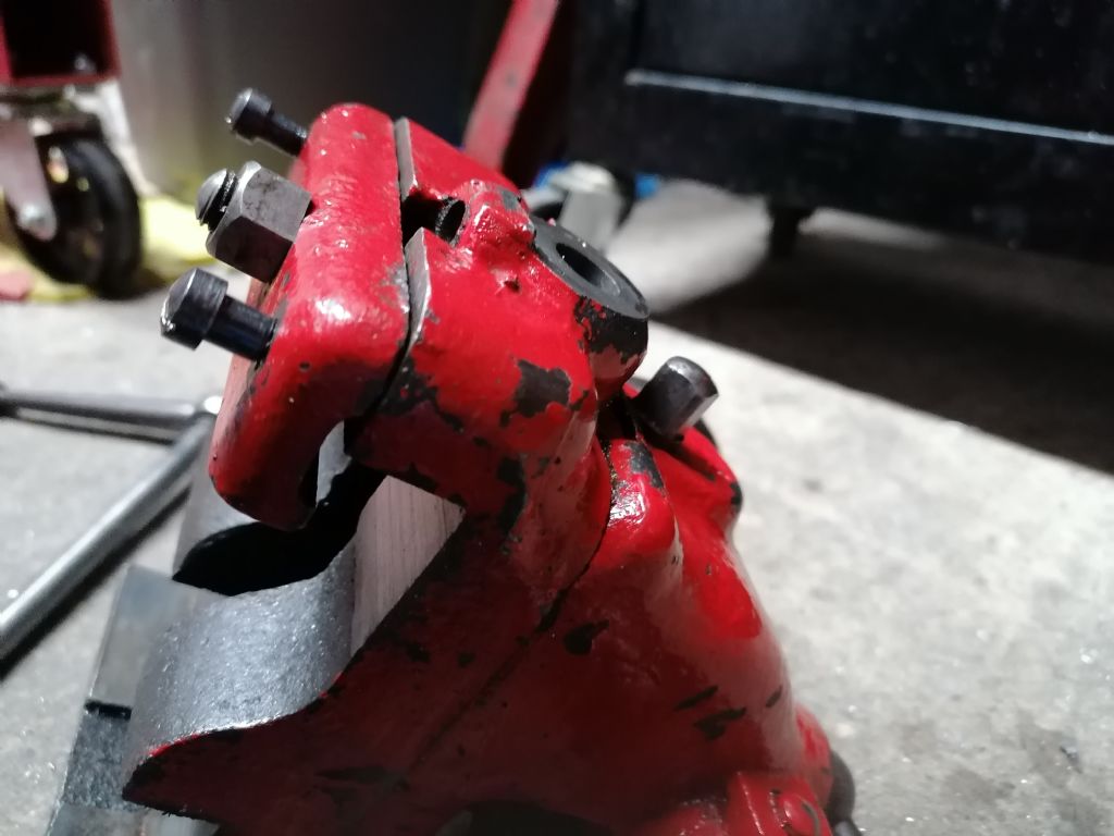

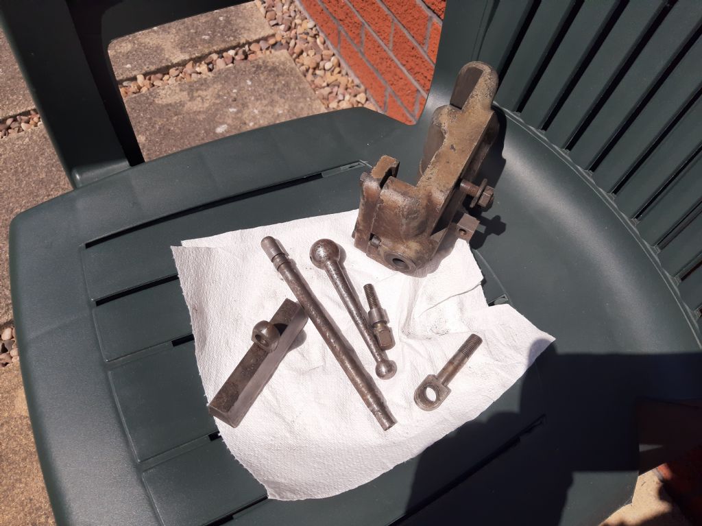

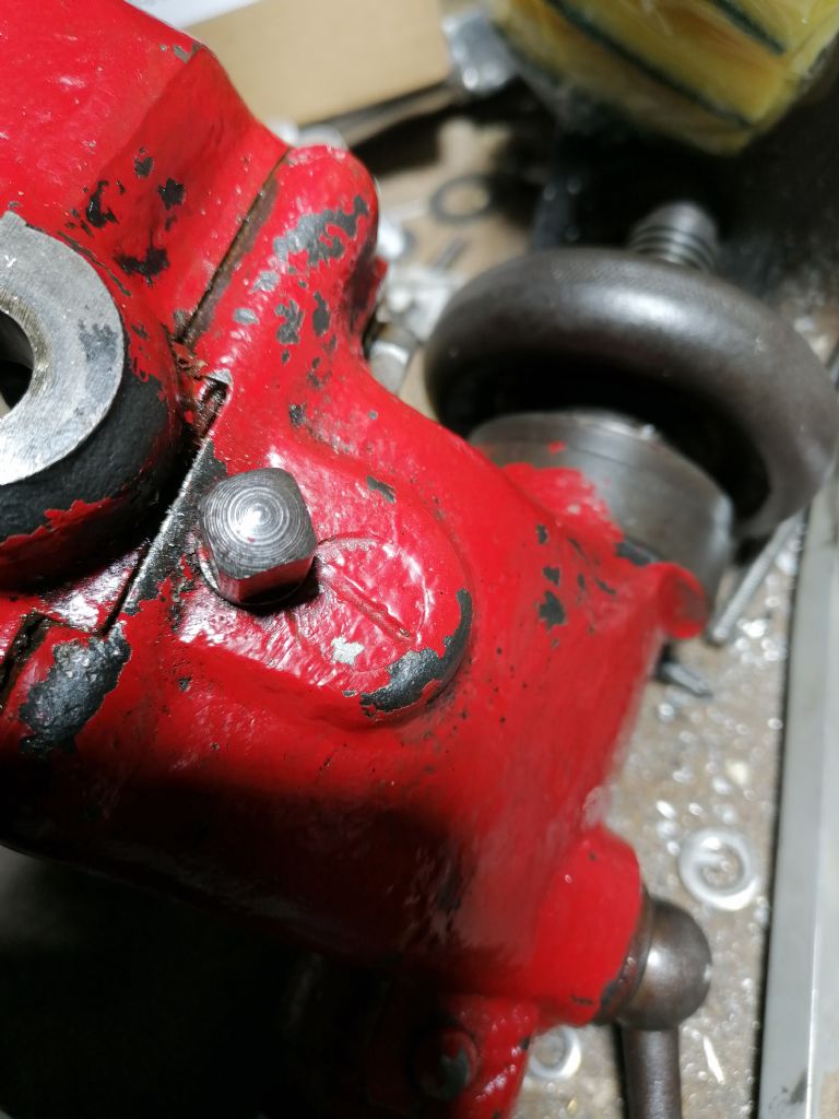

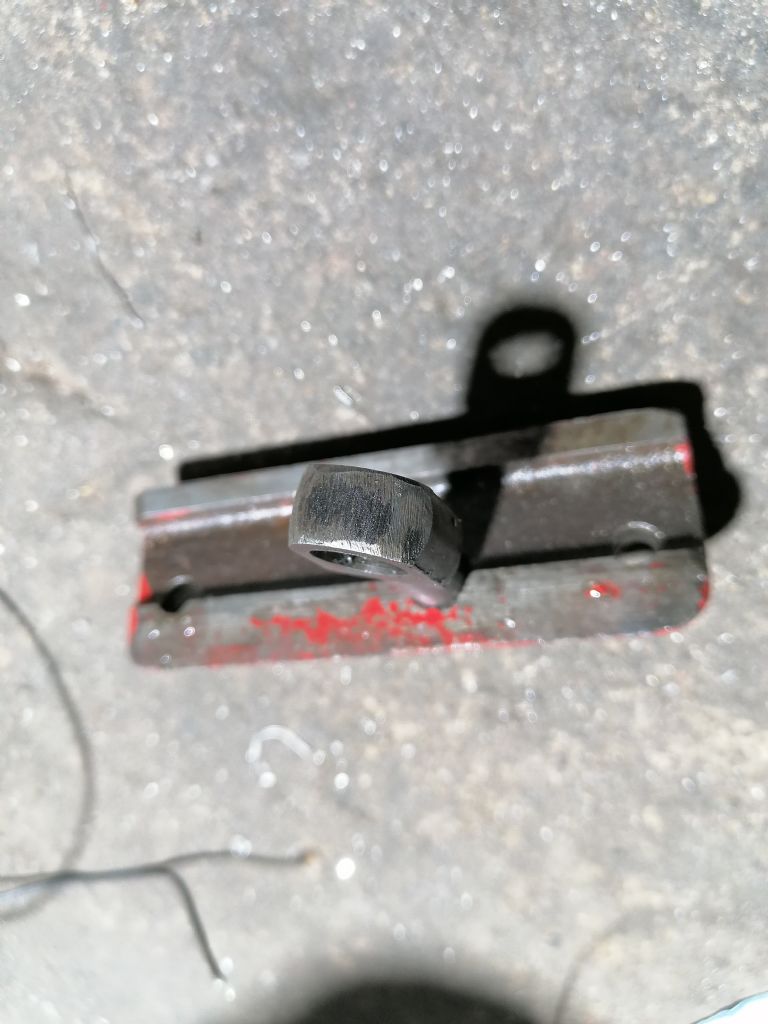

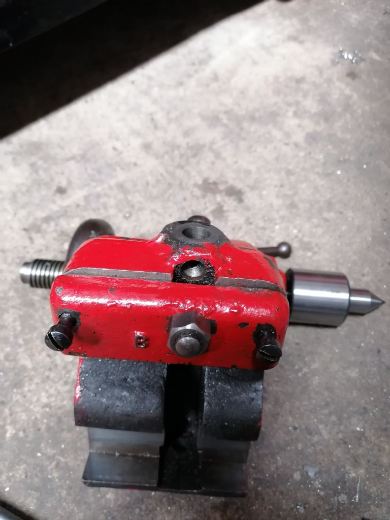

                                So here are some pictures. As you can see the eyed bolts are home grown and that cast plate doesn't look one bit right to me. Also a helpful previous owner has painted over that flat head screw above the square headed alignment bolt. Anyone know what this is? Oil hole?
                                With regard to wear using a straight edge and feelers I'm seeing a .003 dip on the top flat of the ways and using a caliper square against the 45 degree flat at the side I'm seeing about 0.010 difference between various points up the bed

                                  The two screws under the gib locking plate should not be there. I would remove them, that plate is meant to float independently of the upper section
                                  The bolt under the gib locking plate adjusts the tension of the plate for the main tailstock release/lock lever
                                  The cheesehead screw "locks" the square head bolt in place so it can adjust the upper tailstock section across the base of the tailstock, to the left or to the right, (once the upper tailstock locking down nuts have been slackened )
                                  So you can adjust the upper tailstock with the lower section locked to the bed
                                  The main gripping point is across the main angled shear gib nearest the user, just like with the saddle, and the square gib plate merely tightens down onto the back of the bed, like with the saddle
                                  The bit you've removed and is not in the picture, the 60degree gib, is the bit that actually aligns your tailstock  along the main shear)

                                    Looks about like mine. The eye bolts and cast plate included. Mine does not have the screws in the cast plate but has the holes where they once went. As Ady1 says the angled gib block at the front not showm in your pics is the main locator and requires careful adjustment so it clamps firmly . Then adjust the plate at the back to match it.
                                    If you have 10 thou bed wear that may be part of your problem.

                                      Thanks. I think it's due a strip down and cleanup then if the parts look to be the correct ones. I'll free up that locking screw and re lubricate everything. There could be grease in there from 1921
                                      Messrs Drummond didn't seem to be overly troubled about castings not matching up did they. The headstock to bed match up is quite a thing to behold too smiley
