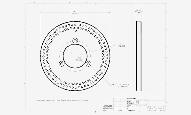

                              Zebethyal
                                @zebethyal
                                Tom Lipton has a neat solution to this problem on his Blog where he made a 127 hole plate for his spindexer using a method similar to that described by JasonB but used 3 different PCDs and the same angle for all holes:
                                #327084
