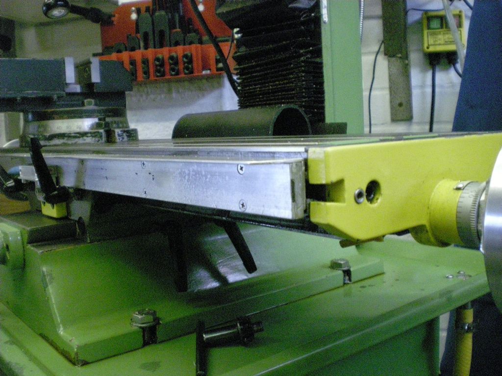

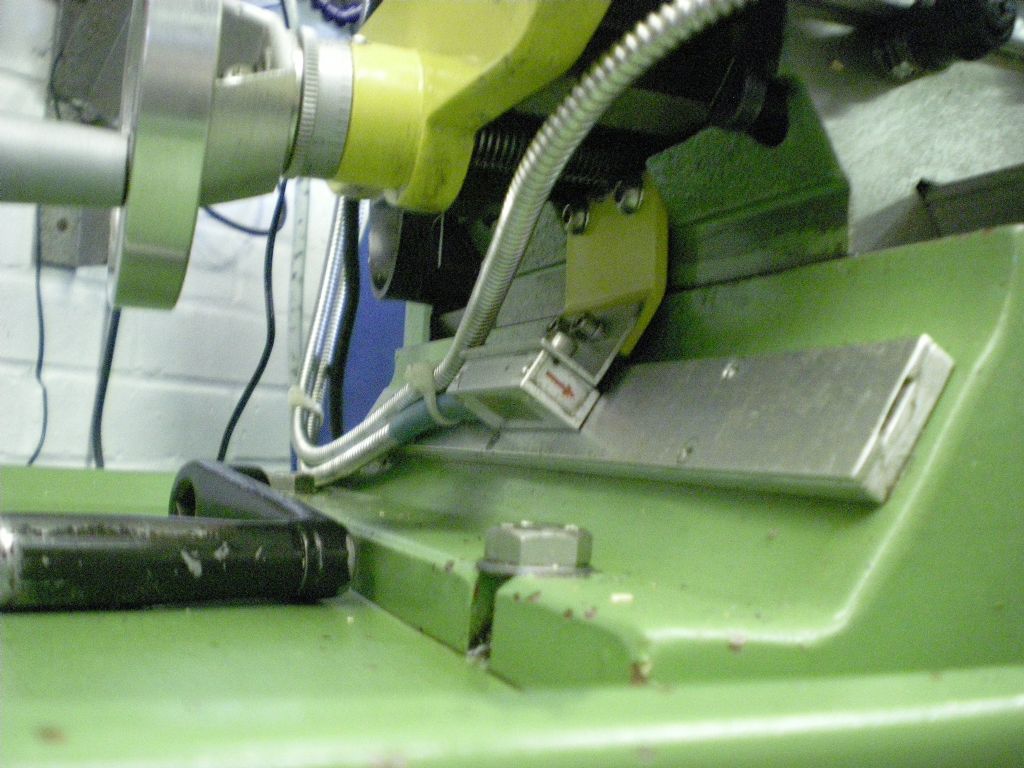

                        Jim Nic
                          @jimnic
                          Once again, a picture paints a thousand words. I fitted a 2 channel M-DRO magnetic DRO to my mill 8 years or so ago and I wouldn't be without it now. I have a numerical readout which works well for me but I understand that a graphical display is now available (probably a bit more expensive).
                          Here is the Y axis scale:
                          The backing piece is held to the machine base with a couple of M5 countersink screws and then the magnetic strip is placed in to it and the cover plate attached. A mounting bracket for the read head was made up and bolted to the table base.
                          The X axis:x axis scale.jpg
                          This was attached to the table in place of the stops and the read head is where the stop was. I put a piece of aluminium angle behind the scale to keep swarf from getting jammed in between it and the read head.
                          The system works well and has never missed a beat despite the scales and read heads being regularly doused in coolant and other miscellaneous fluids. Also, being mains powered there is no faffing about with flat batteries at inconvenient moments.
                          It wasn't the cheapest system for sure but I think it was well worth what it cost my good lady wife and was a great Chrissie present.
                          Jim
