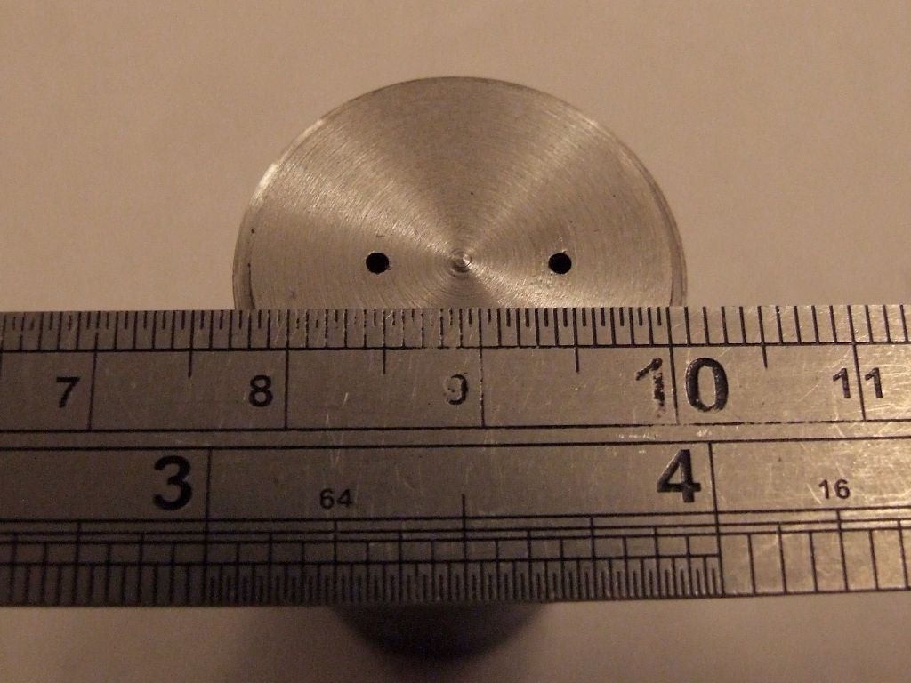

              If yoiu're careful when starting the drill you can get away with a 2-facet drill. Shown here are 1.2mm holes drilled 8mm deep in tungsten alloy on the Bridgeport with no spotting (tungsten carbide drill):
