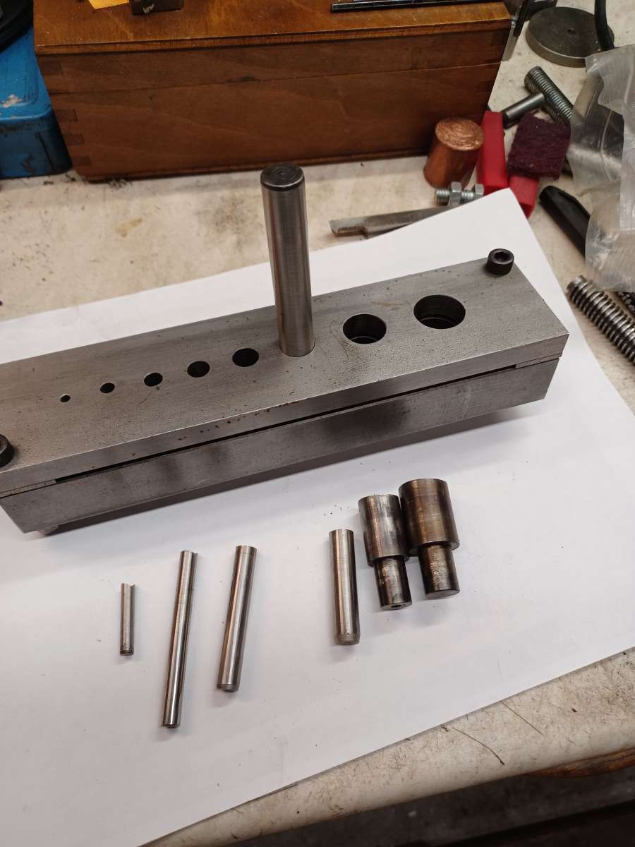

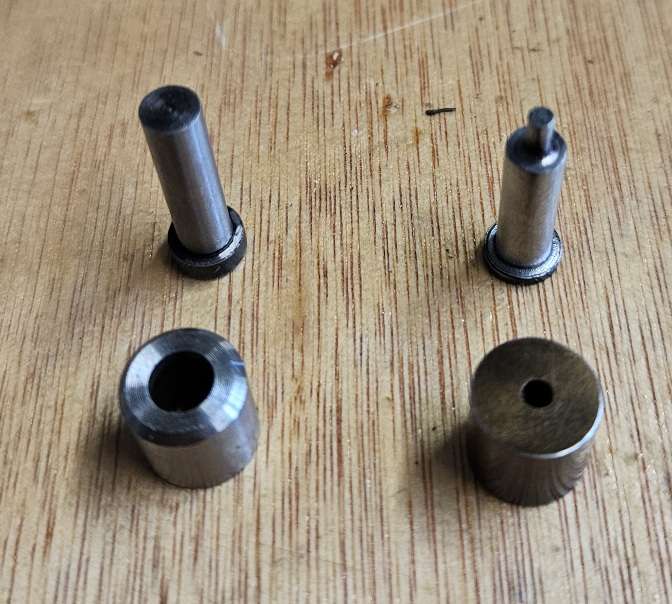

                                  This is the punch set I made whilst I was an apprentice. The top plate guides the punch if just waking washers or shims and with with top plate removed I hold the punch in the drill chuck locate the hole clamp and then just put metal over hole and press out. It has a range of hole sizes. 1/8″ to 5/8″ I think. The most of punches are just hardend dowel pins with the end sharpened  with slight angle to cut easily.
                                  20240620_175029

                                    David, that is not unlike the one I had for plastic. Circlip, it also worked on lead foil and photo etch so not just new fangled plastic.
                                    The one difference was the top plate was perspex or similar clear plastic so you could see where you were punching the hole. Ok if you just want a hole as the first part of making a washer or say buttons for a model figure but how would you easily place a hole central and 1.5mm in from the end of a 3mm wide strip on that one particularly if the material is thinner than the spacer between the top guide plate and bottom die plate?
                                    This is the sort of thing I had, clear plate and the guide dowels are separate to the thumb screw threads so a closer alignment of top & bottom plate and it allow the plate to clamp the work and hold it in position while you make the hole. Not sure about the toffee hammer with that one.

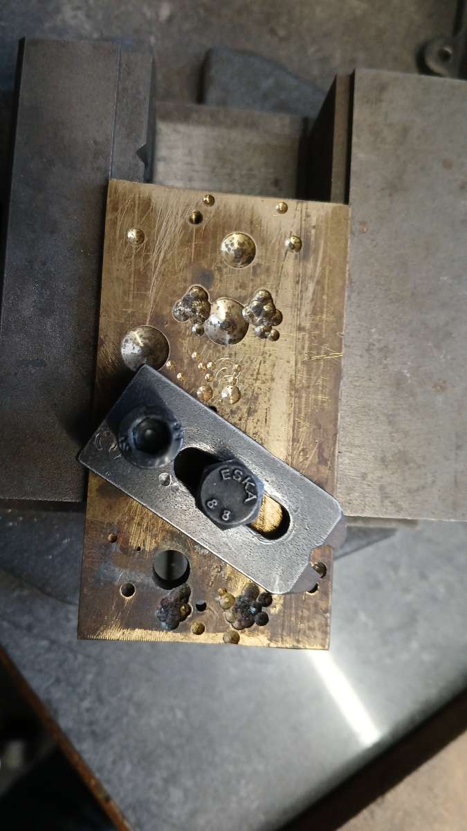

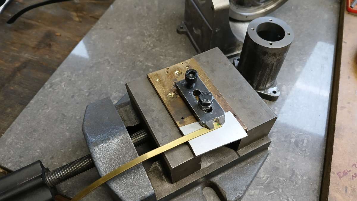

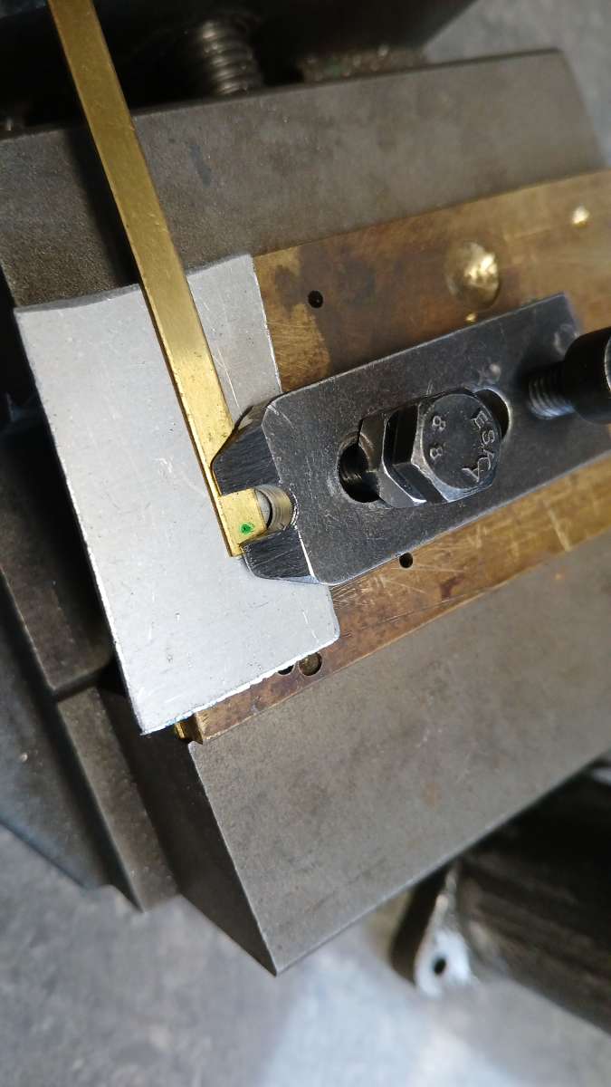

                                      Bit of flat bar at the bottom in this case looks like 1.5″ x 1/4″. Tapped M6 for the nut and screw. Modified Unimat3 Clamp plate with thinned and notched end. A piece of 20 x 5 flat bar or whatever you have will do with a slot and hole at the end tapped for a M6 jacking screw at the far end
                                      In use a bit of scrap is placed under the work (sometimes!) and the work clamped in place. The notch allows you to see your marking out and punch mark ( green dot for the photo) and allows room for the drill bit. The scrap at the bottom and the clamp plate effectively “sandwich” the work and the scrap helps stop the drill pulling into the work as it exits.
                                      Hold it in the drill vice to give it a bit of weight and security.
                                      Think it’s about time for a new bottom plate, as you can see it has had some use!
