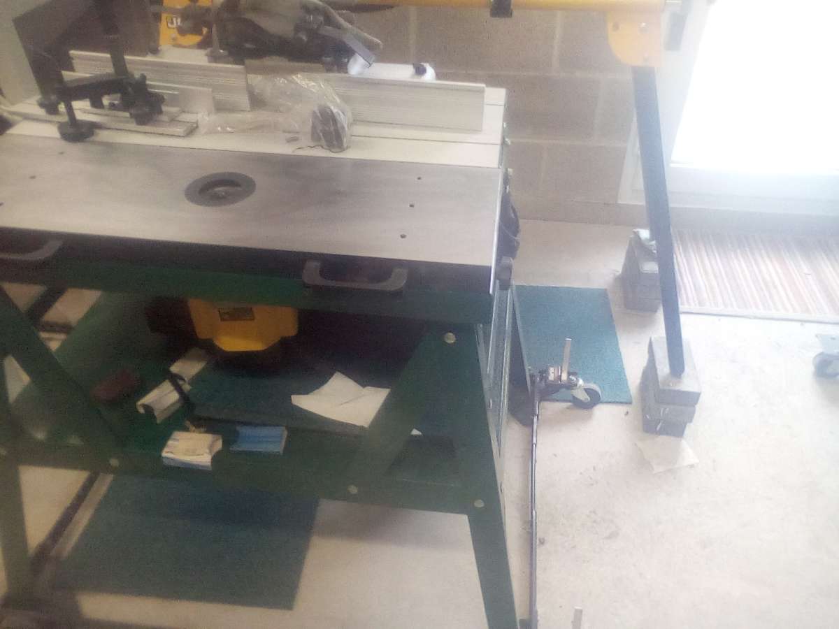

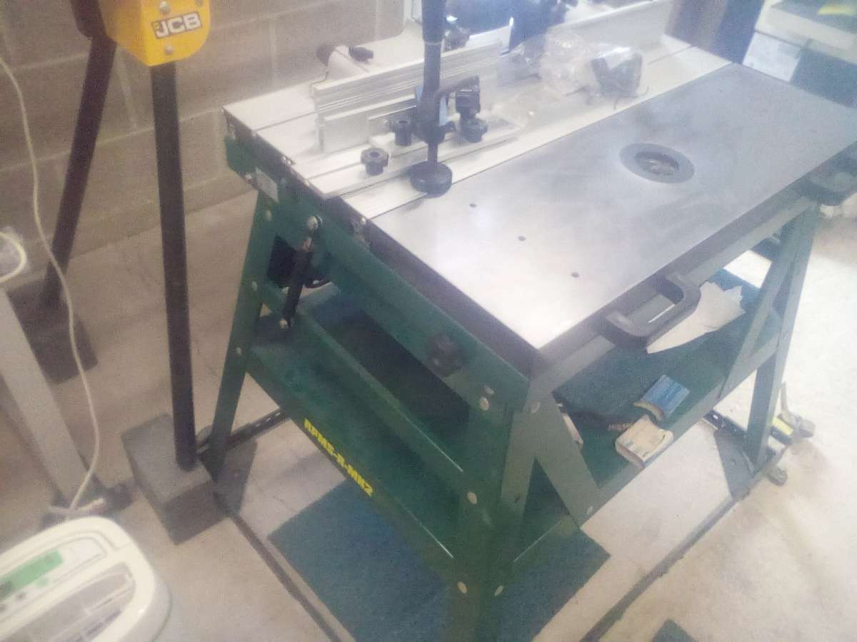

      Due to limited space I’ve had to put my router table under my mitre saw stand, see photos. As you can see I’ve raised the stands legs up on bricks, this is not ideal but will do just for the time being to free up space. I’m intending to add hollow tube bolted to the legs to increase height, make more stable, secure. How do I go about drilling through the tube and legs, please explain method for a newbie to understand. I’m also thinking angling the end of the tube where they meet the floor, how would I get the correct angle and actual cutting the tube?
      The diameter of the legs is 38mm and the aluminium tube I’m looking at getting 4 x 300mm lengths has an ID, bore size of 41.28mm. That should be a close enough fit over the legs?
      Ebay UK item number 276844073589 seller also says can supply the tubing as grade 6082T6, which is suitable for drilling.
      Any help advice, appreciated.
      Thanks.

        NO this will not work ! If I understand your dimensions your leg OD is 38 mm and your tube ID is 41.28. This is far too slack. You need the 2 tubes to be a good fit. One option is to use 38OD and fit a plug may be of wood between the 2 tubes then drill through and and use a screw to secure in the lower part. You do not say what gear you have access to, I would crimp the lower to fit inside the upper – but I have the gear to do this. Good luck. Noel.

              Rather than faff around cutting the tube to an angle, look instead for rounded rubber feet that will fit over whatever size you select. Variously described as “chair feet”, “end caps” or similar.

                38mm is suspiciously close to 1.5″. If I’m right you could just buy longer lengths of tube and replace the whole length

                  Looking again at the bench the legs are bent sheet metal. Extend with steel angle iron. Far easier to work. use a substantial overlap and put in extra holes while you are about it to change the height if it doesn’t suit first round.

                        The thing with the angular legs is ths router table, not the thing which wants raising
                        #802503
                          Yes it is the folding dewalt mitre saw stand with ROUND legs that need extending. The one jacked up on bricks. There are sprung pins in the tops of the legs as well as pivots so a bit more work involved than just getting a longer tube.

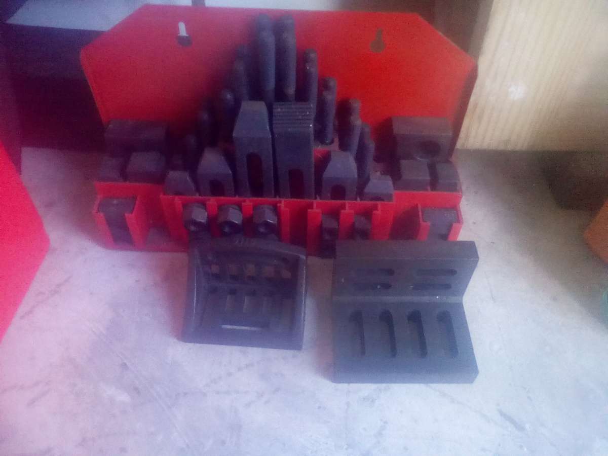

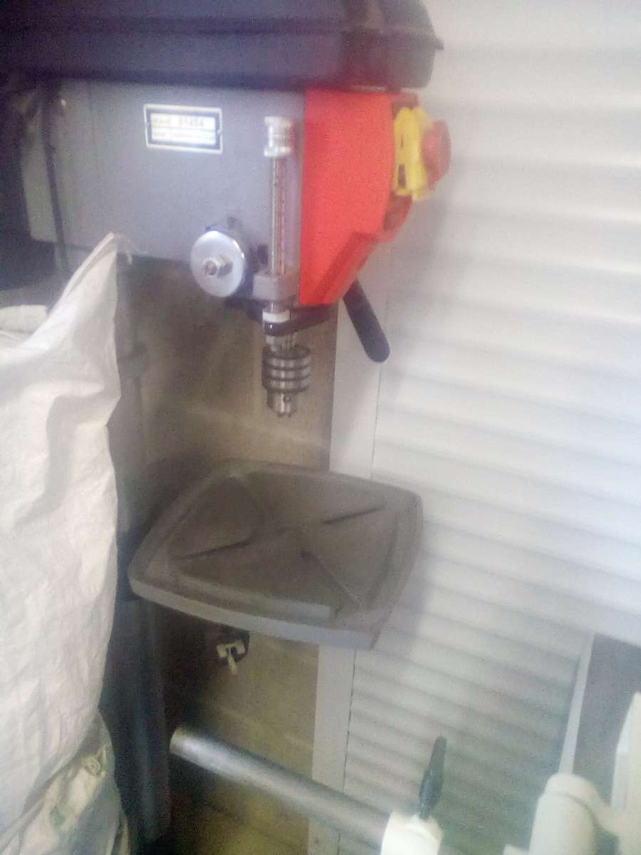

                            I have a floor standing pillar drill and some Vee-block clamping stuff, see attached photos. photos Will see if imperial ID tube closer to the OD of legs. 12

                                Aha – looking at your two photos you have an appropriate drilling-machine, angle-plates and clamp-set.
                                Clamp the tube in the corner formed by an angle-plate and the drill-table, with a thick sacrificial pad under the tube and the drill’s depth-stop set so you don’t damage the table.
                                Scraps of old laminated-chipboard make good pads for work like this. You may anyway need fairly deep packing so the drill will go right through the tube without the chuck hitting the angle-plate. I do a sort of dummy run with the work-piece out of the way and machine off, to verify such clearances.
