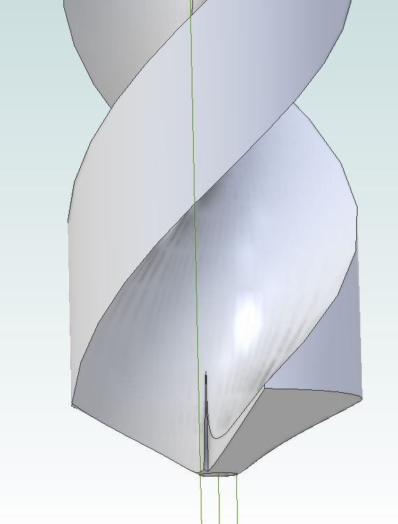

                                          @madmike
                                          As usual lots of good advice but sadly mainly of the "stone" the edge variety to "blunt" the drill
                                          I have seen reference to Rake and suggestions that you can alter this easily. Rake is the angle of the spiral relative to the cutting edge. For brass this can be an important factor. Slow helix/spiral drills have the rake required for drilling brass. Modifying the point by stoning or honing simply alters cutting edge clearance which is not the same as rake on a spiral drill.
                                          If you intend to drill brass, of any type, I would suggest an investment in some "Brass Drills" (not made from brass obviously. LOL) and these are readily available at no great expense from our friends at Tracy Tools. These will have the helix, point and clearance required in a single drill bit. HTH.

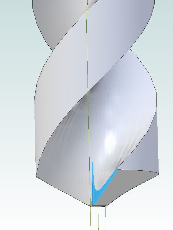

                                            #575412
                                            Martin Kyte
                                              @martinkyte99762
                                              Posted by MadMike on 14/12/2021 13:20:00:
                                              You have clearly not understood the process, or so it seems. The material is removed from the face of the drill (inside the flute) which alters the rake. As I said I use a diamond credit card slip to achieve this and obtain a sharp drill with the same rake as a straight flute brass drill. I do agree with you that blunting the drill doesn't really get you where you want to go. I also agree that brass drills and slow spiral drills designed to cut these materials are the ideal. For my clockmaking though which is generally dealing with holes below 6mm I have a set of drills modified for brass as I have described and as they work well for me is cheaper than buying a complete set of specials.
                                              regards Martin
                                              #575414
                                                As Martin says run the stone up the drill's axis so that the leading edge of the helix becomes vertical. The cutting edge will still be sharp and the helix able to remove the swarf.
                                                Clickspring shows it quite well
                                                Edited By JasonB on 14/12/2021 14:48:53
