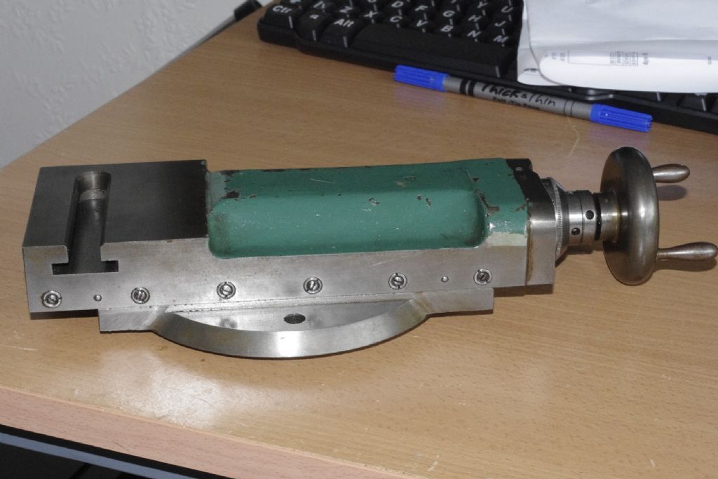

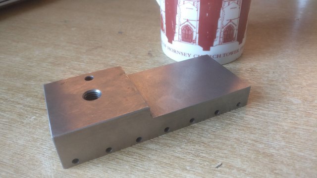

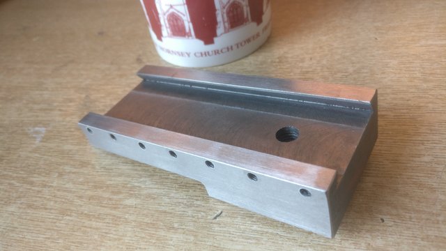

      Hi. Whilst I had my carriage apart I thought I'd add extra gib screws as this seems to be a common modification. I used a pillar drill and sharp bits and all went well but I've just noticed that the bearing surface of the carriage is no longer flat where the holes have been drilled.
      Have I done something wrong?
      In one of the images below you can see the distortions where I've started to flatten them with a flat stone.
      Edited By Philip A on 12/11/2020 15:45:20

          Looks like compound slide? Three of them look OK.🙂

            Tapping the threads so close to the edge probably caused the metal to bulge slightly where it isn't constrained.
            The question is; why on earth would you want to drill and tap the extra holes? It might be a common modification, but I've never heard of it before. I don't see that the extra screws add anything. The slide is fully constrained with three screws, assuming the outer ones might go past the end of the fixed slide. The top slide on my lathe seems quite happy with three screws.

              Bad luck, I would never have guessed that cast iron would do that. The light stoning that you have carried out should have remedied the problem, though.
              If you have a surface plate, a sheet of 600 wet and dry and a couple of rubs will sort it out easily. Before getting the 24" cast iron table, we used a glass plate made from thick float glass. It is about 12" square and is an excellent poor mans plate. The one we have is still in use for smaller jobs.

                  Dave Halford
                    @davehalford22513
                    Posted by not done it yet on 12/11/2020 16:03:51:
                    The originals wink

                          Something that I've mentioned before in the context of bed warping is that cast iron behaves very like chipboard . Tight hole close to an edge , in goes a screw , result bulge on the edge.

                            Following what Lee says above you should insert the screws before finalising the corrective action.

                              I don't think any harm has been done, I would not have been content with only three screws. The high points are easy to deal with and its a compound, which gets less used than other parts of the lathe and can be kept a little on the tight side anyway. This NOS compound I picked up recently has six, and also two dowels, right near the edge.
