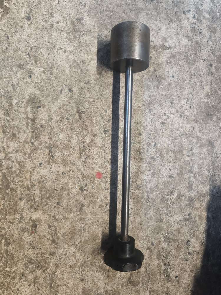

          20241116_161901made a new chuck to hold drills smaller than 3mm.

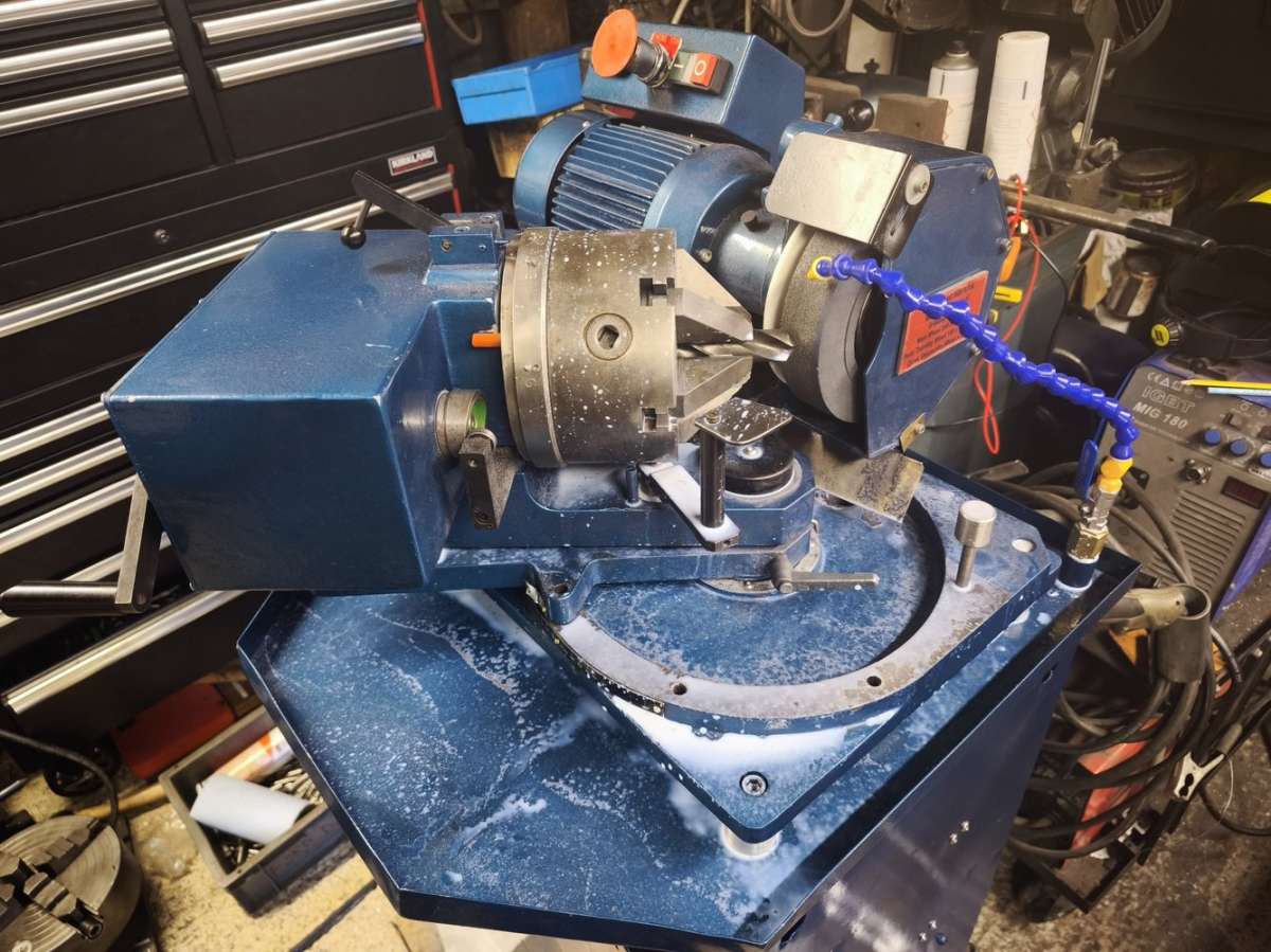

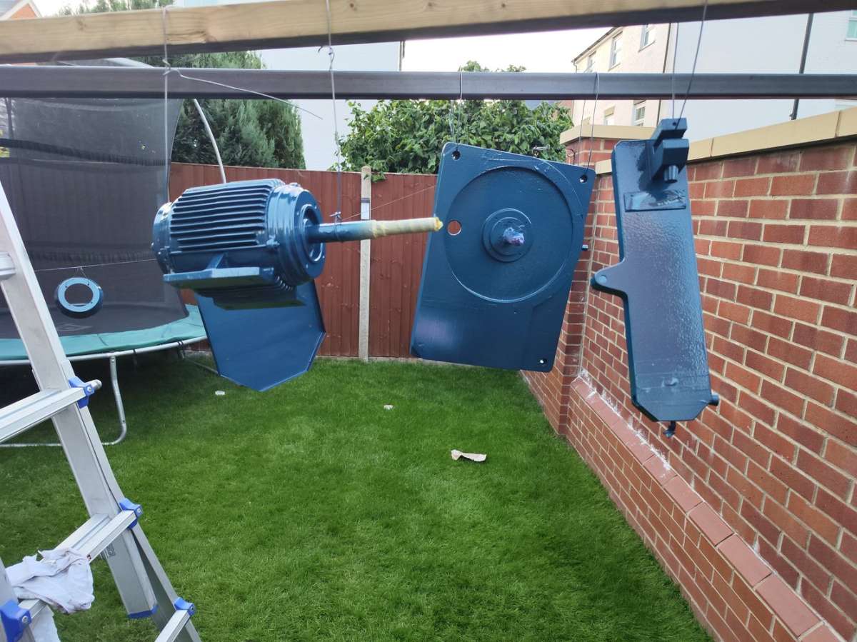

              @janraap84676
              Interesting thread.

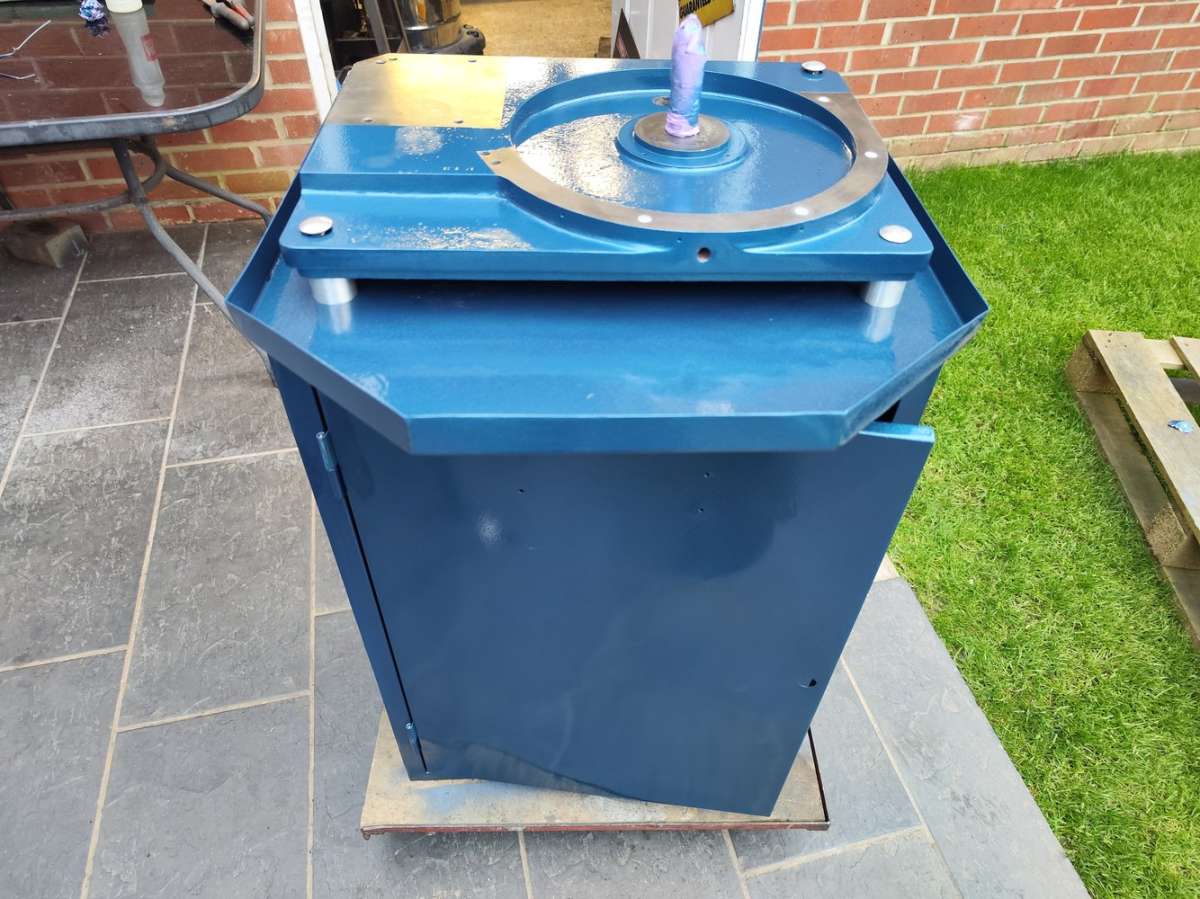

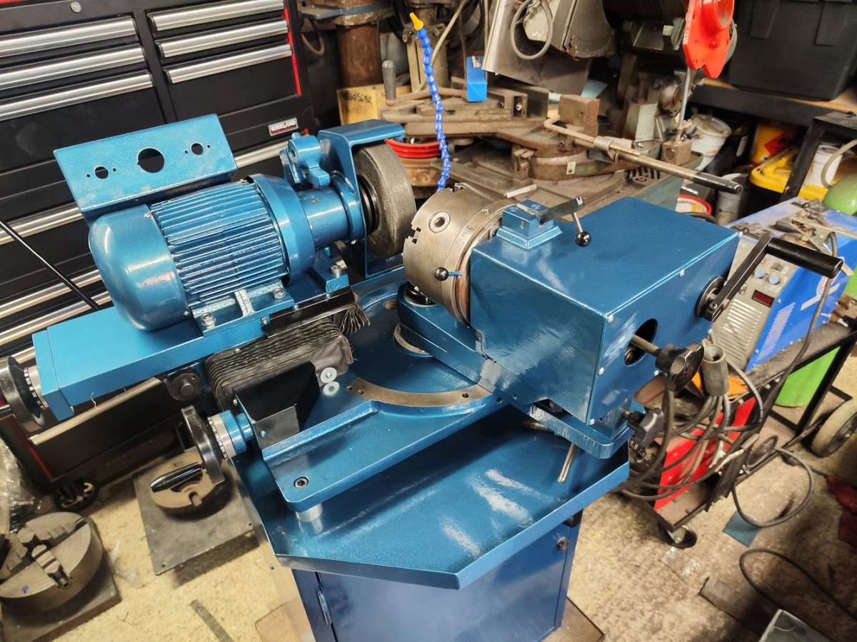

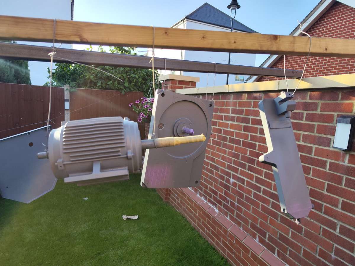

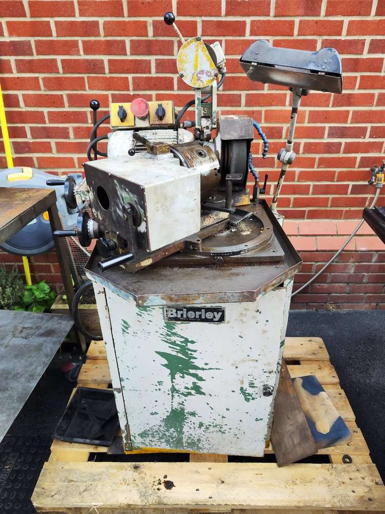

              I have a Brierley ZB50 which I have just got working in the last week. It is not completely finished yet, I still need to refurb the light with magnifying glass and also clean and paint the optional motor (I believe it is for split pointing).
              I bought my ZB50 in 2023 and it looked like this.
              IMG_20230813_100524 (2) (1)
              It was completely stripped off paint and repainted.
              IMG_20240519_214452
              The additional motor that still needs to painted.
              IMG_20240526_155601
              1000055661

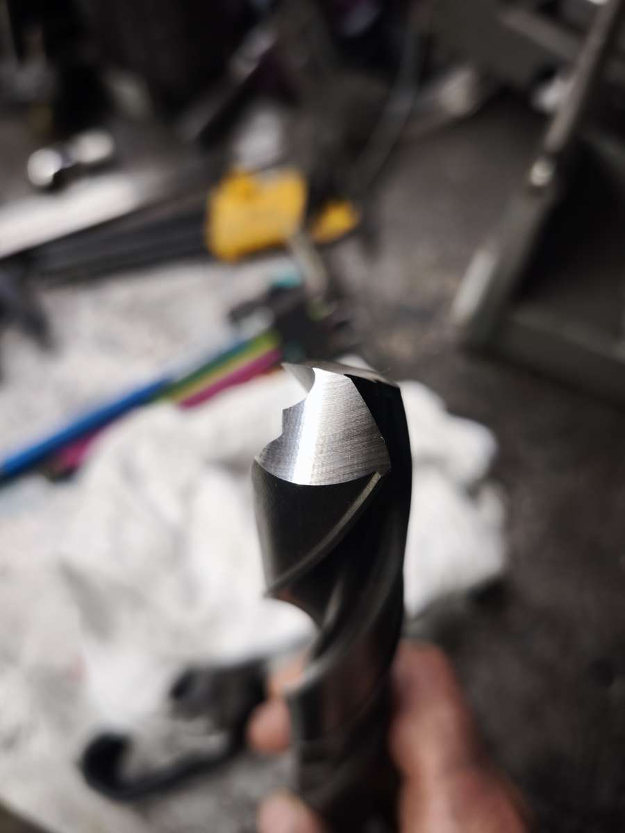

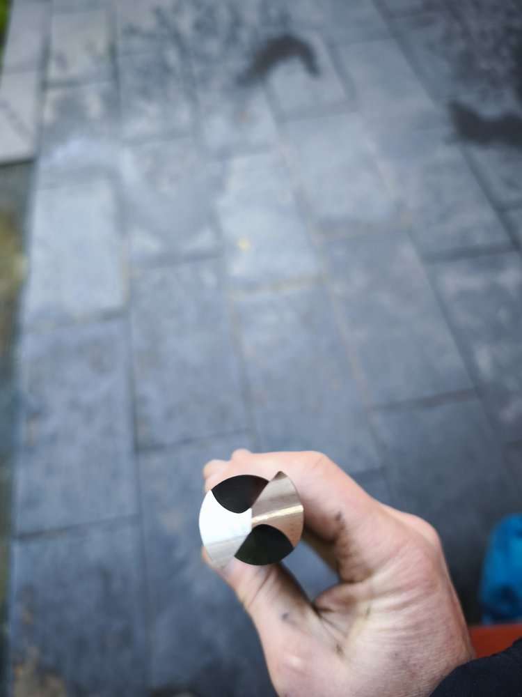

                  First drill bit.
                  1000079400
                  1000079437
                  1000079438
                  #774422
                  noel shelley
                    @noelshelley55608

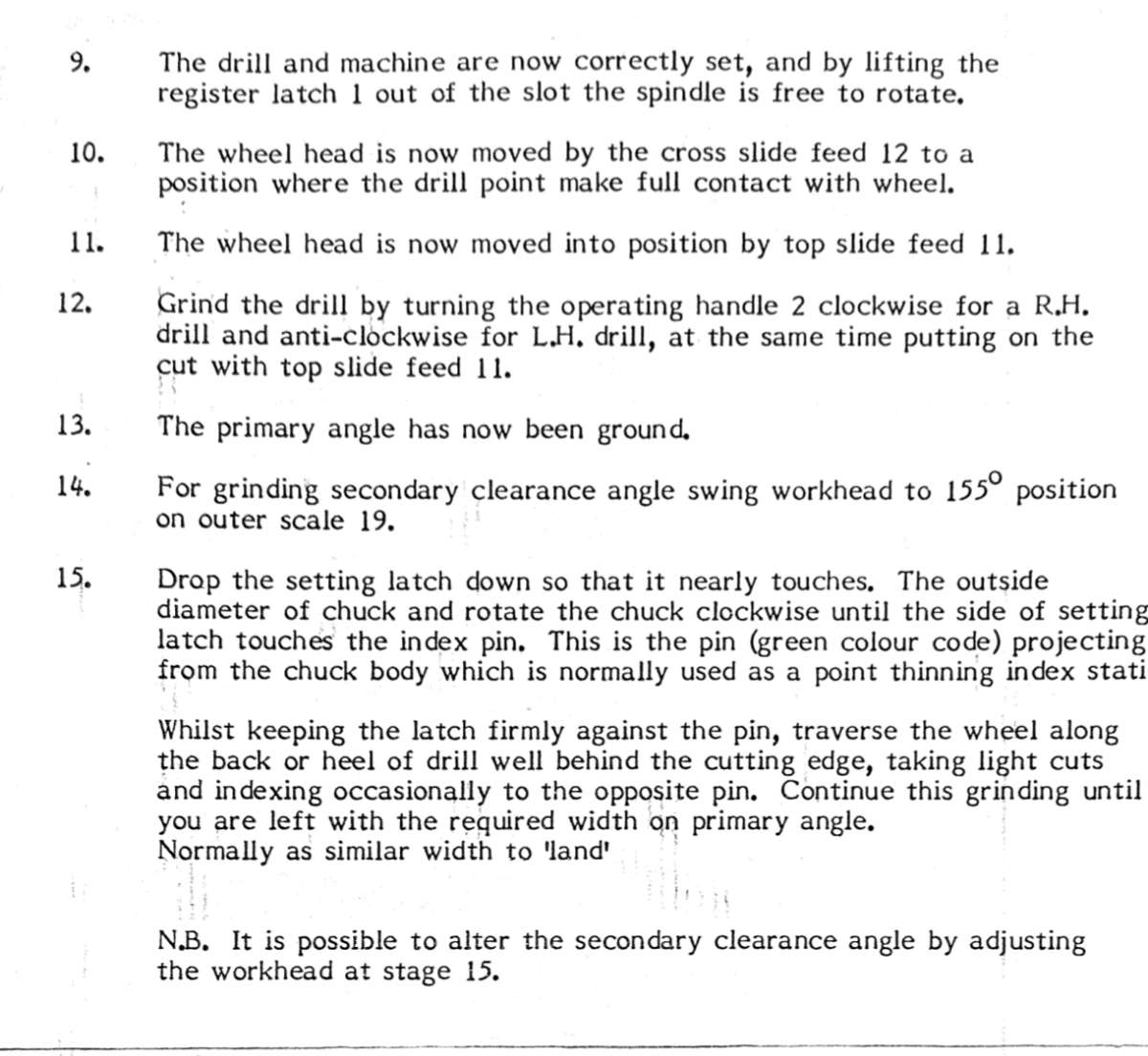

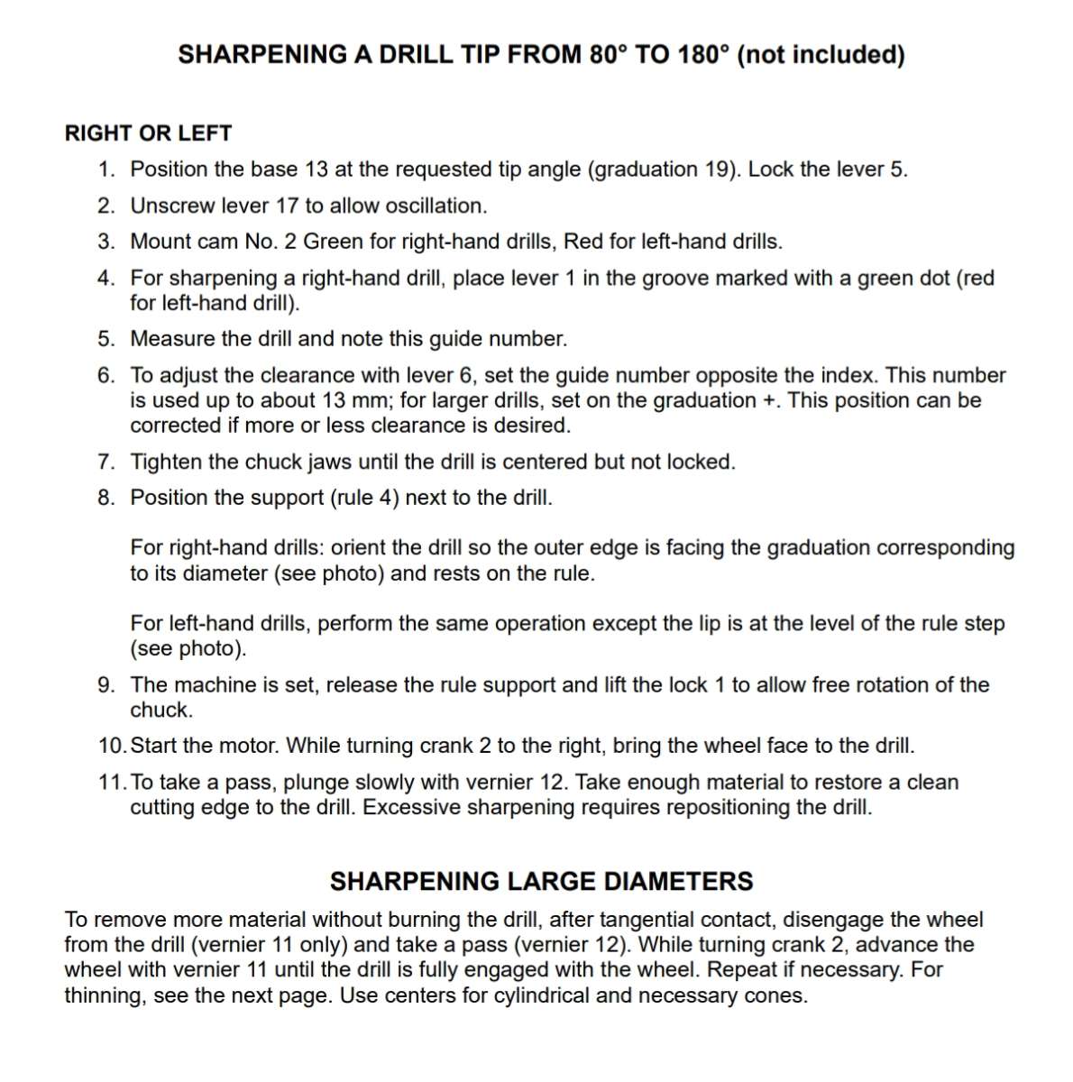

                    Hi Jan, I have a ZB25 and a ZB32 and the instructions for their use. They look very similar to the ZB 50. If they would be any help to you let me know. Noel.
                    #774437
                    Jan Raap
                      @janraap84676
                      Hi Noel, thank you.
                      I have a selection of manuals and they all differ slightly.
                      I have the two ZB50 manuals from here (I uploaded one).
                      http://vintagemachinery.org/mfgindex/detail.aspx?id=12088&tab=3

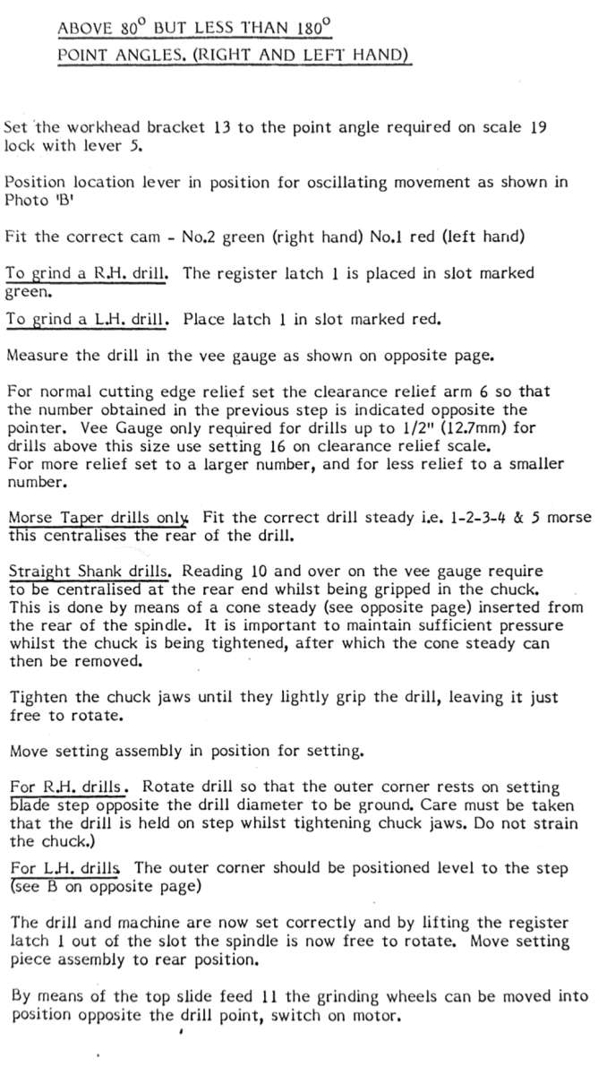

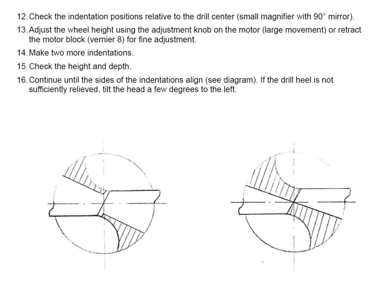

                      It seems like the basic principle between the ZB32 and ZB50 are the same. However, it looks like there is a key difference in setting up the drill for grinding.
                      As far as I can tell you need to lock the ZB32’s head (no oscillation) and place the stop in the Green stop (for a RH drill) on the chuck.
                      On the ZB50 it specifically states that the head needs be unlocked to allow oscillation when setting up the drill bit.
                      The ZB50 instructions:
                      Screenshot_2025-01-04-19-41-13-085_com.google.android.apps.docs-edit
                      Screenshot_2025-01-04-19-48-06-592_com.google.android.apps.docs-edit
                      #774441
                      Baz
                        @baz89810
                        Seems the wording for ZB 50 is slightly different but it all boils down to the same thing, the drill land rests on the blade, the chuck is locked in either red or green slot and chuck is tightened. The operation of all machines is the same, I believe the cams will fit all machines. Have you got or are you aware that a special wheel is available, three quarters of it is coarse grit for large drills and the other quarter is fine grit for small drills.

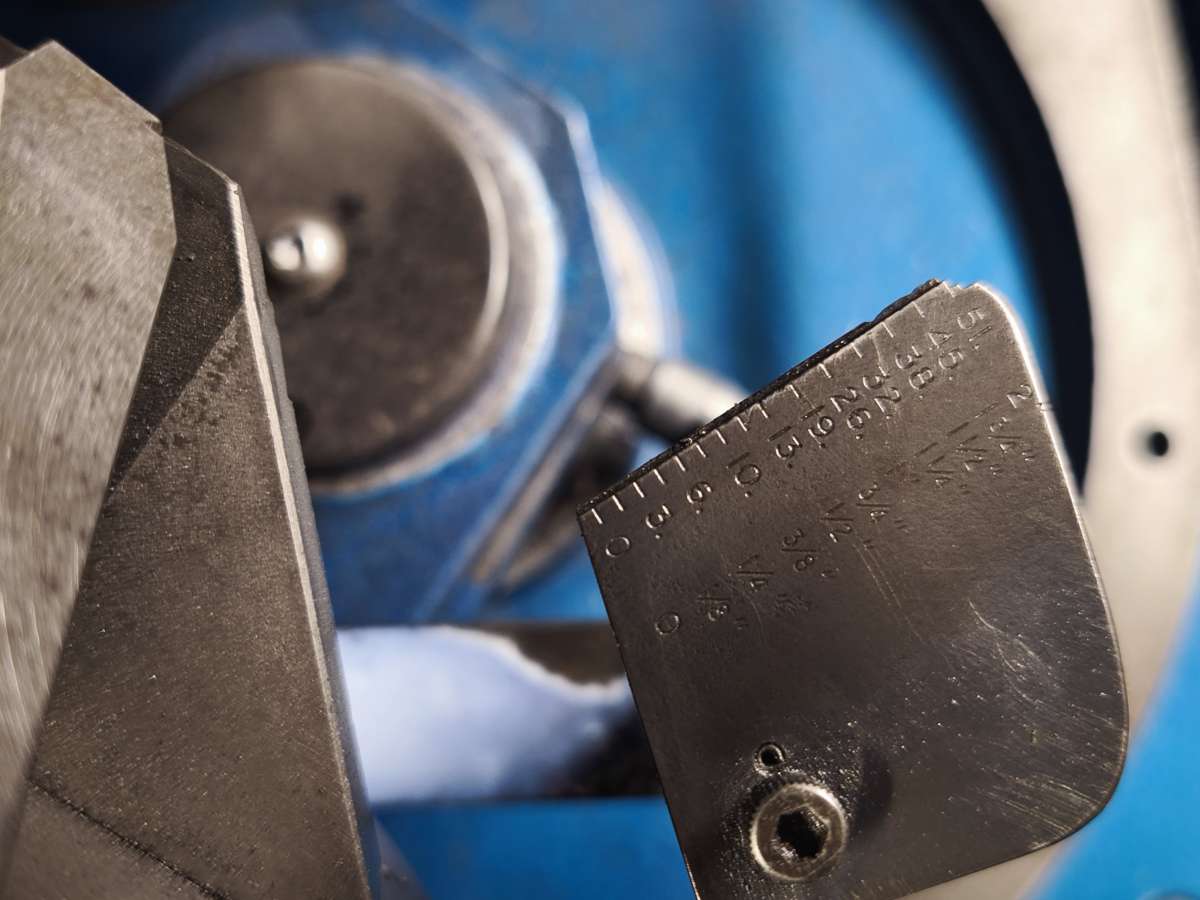

                            My drill setting guide is also different.
                            I think on mine, you just set the drill to the nearest marking on the setting guide according to the drill’s diameter.
                            IMG_20250104_205141

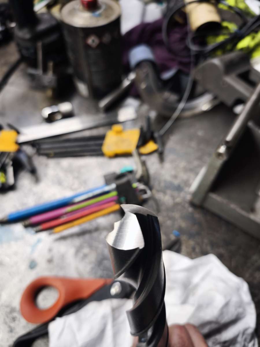

                              Reading the translated manual, it is confirmed. No Vee gauge is required on my machine.
                              Screenshot_2025-01-04-20-56-45-282_com.google.android.apps.docs-edit
                              I should have read the ‘Sharpening large diameters’ bit before I tackled my 2″ drill bit.
                              Maybe it wouldn’t have overheated so much…..
                              IMG_20250102_130706
                              IMG_20250102_130715

                                Hi Jan, The V gauge is not really needed as all you do is express the drill dia in 1/32″s eg 3/8″ (10mm) is 12, above 1/2″ (13mm) just use 16 or a figure that give the clearance you need. I take it your wheels are new ? The lines on your regrind are caused by the wheels being out of balance, common on old and worn machines. Only by careful balancing will you stop this and some wheels can be a long way out. There is also the risk an out of balance wheel will come off. Do you have a set of cams, and the steadies, plus the diamond dresser that normally come with the machine ? Best wishes Noel.

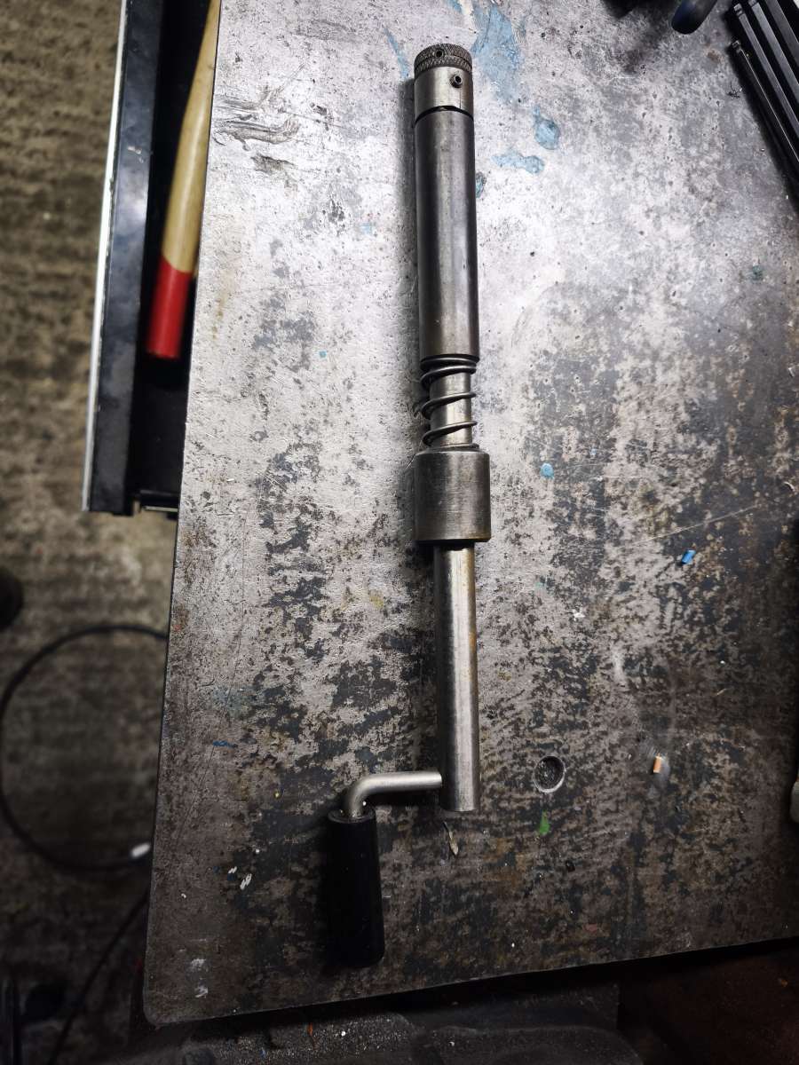

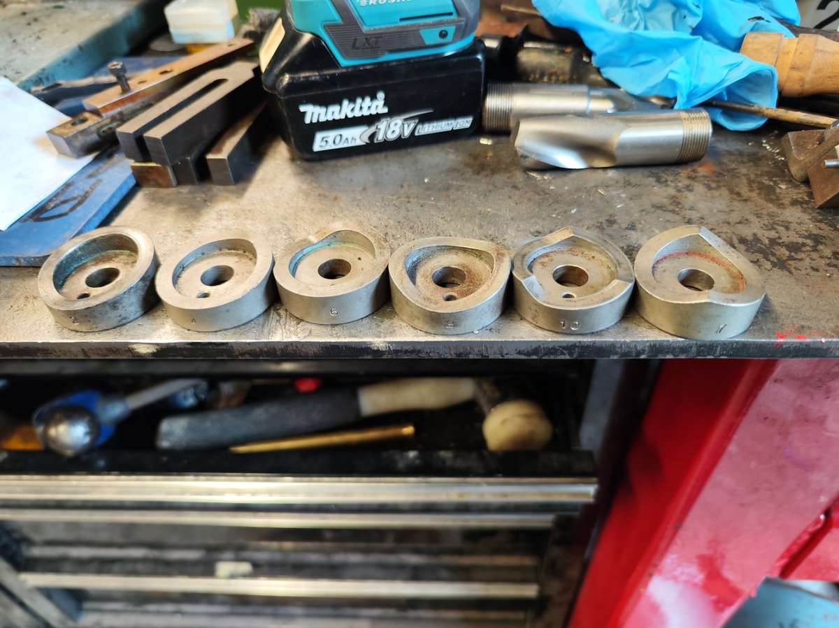

                                  I do have a few cams.
                                  IMG_20240519_115517
                                  2,4,6,8 Green and 7 red.
                                  I also have the round shank drill steady.
                                  IMG_20240519_094933

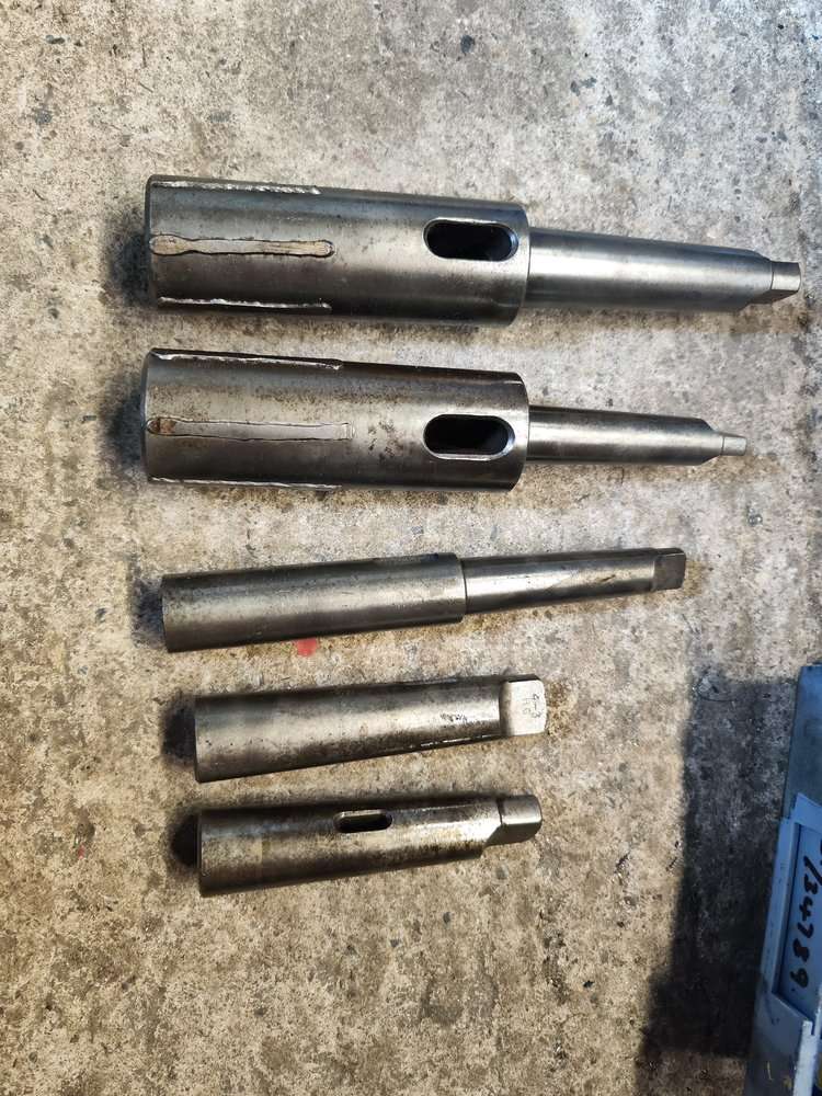

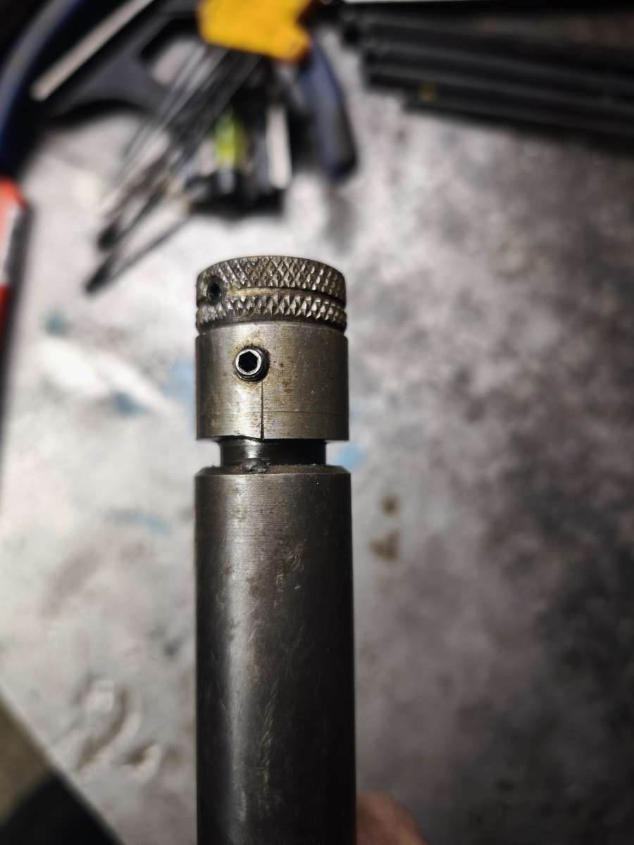

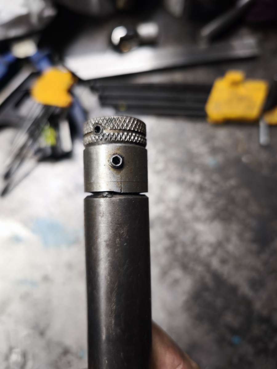

                                  I do not have the original MT holders – my machine came with shop made MT holders and sleeves.
                                  IMG_20240519_095022
                                  The OD of the MT holders have been welded and machined down so that they fit in the Brierley head.

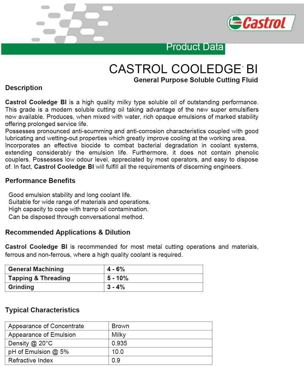

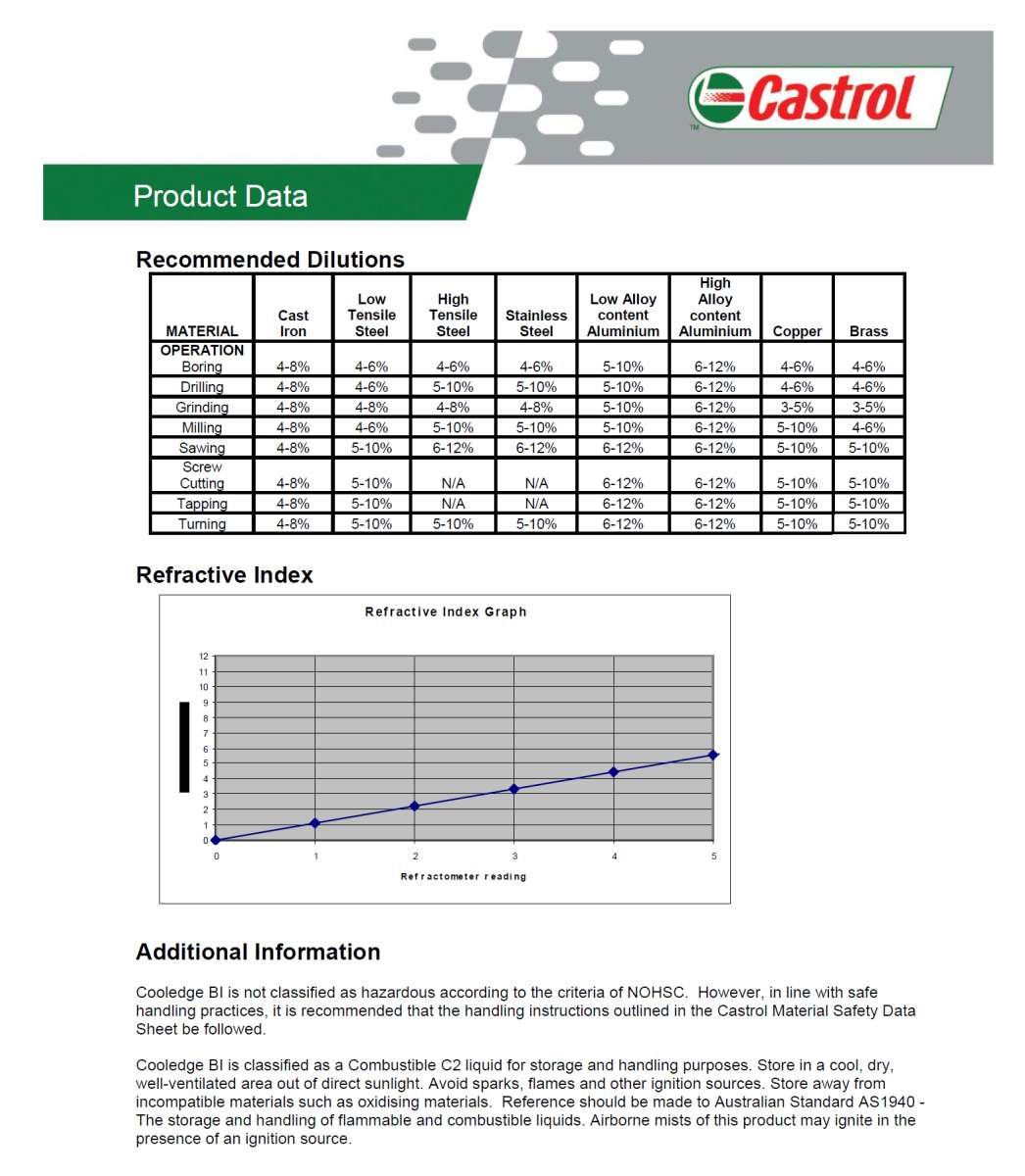

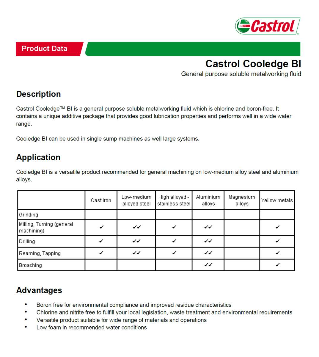

                                    I see you are using coolant, is this specifically made for grinding ? On the smaller machines a spray mist was used and I thought it used water. The hole in the top of the extended motor shaft cover was to mount said equipment. My ZB32 did not have the spark catcher ‘ so I made one of light gauge 25 x 50 box section. I also had trouble holding the motor shaft to tighten the wheel mounting due to the hole in the shaft cover being badly worn. The hole in the cover was near enough size to tap 1/4″ BSP and I cut one side off a steel male x male 1/4″hydraulic adaptor and screwed it in, the hexagon enabled it to be tightened . This held the lock pin true.
                                    Are you in the UK ?  Noel.
                                    #774558
                                    Jan Raap
                                      @janraap84676

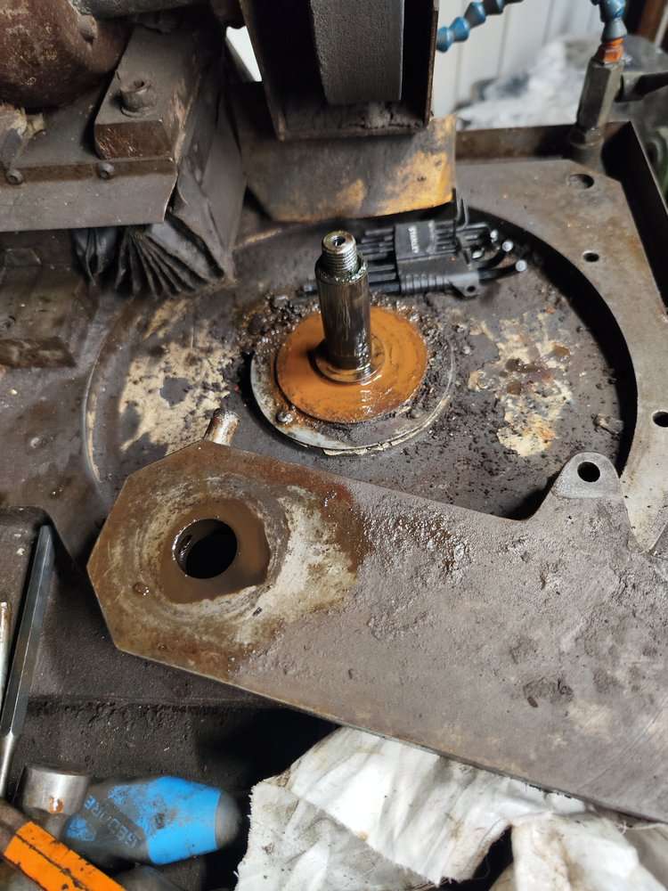

                                      Yes, I am using coolant. My machine came with a coolant pump and tank (it was filthy, probably never been cleaned).
                                      In regards to the coolant being specifically made for grinding, it depends on which datasheet you read 🙂
                                      I have some Castrol Cooledge BI coolant so I used that.
                                      The first data sheet would suggest it is not made for grinding.
                                      Castrol 1
                                      The second datasheet
                                      castrol 2
                                      The third datasheet
                                      Castrol 3
                                      So maybe it is not exactly made for grinding, but it seems like a general-purpose coolant that could be used for grinding. I am using the same coolant on my Jones & Shipman 540 grinder.
                                      Luckily, the hole to hold the shaft was all good on mine.
                                      IMG_20250105_125519

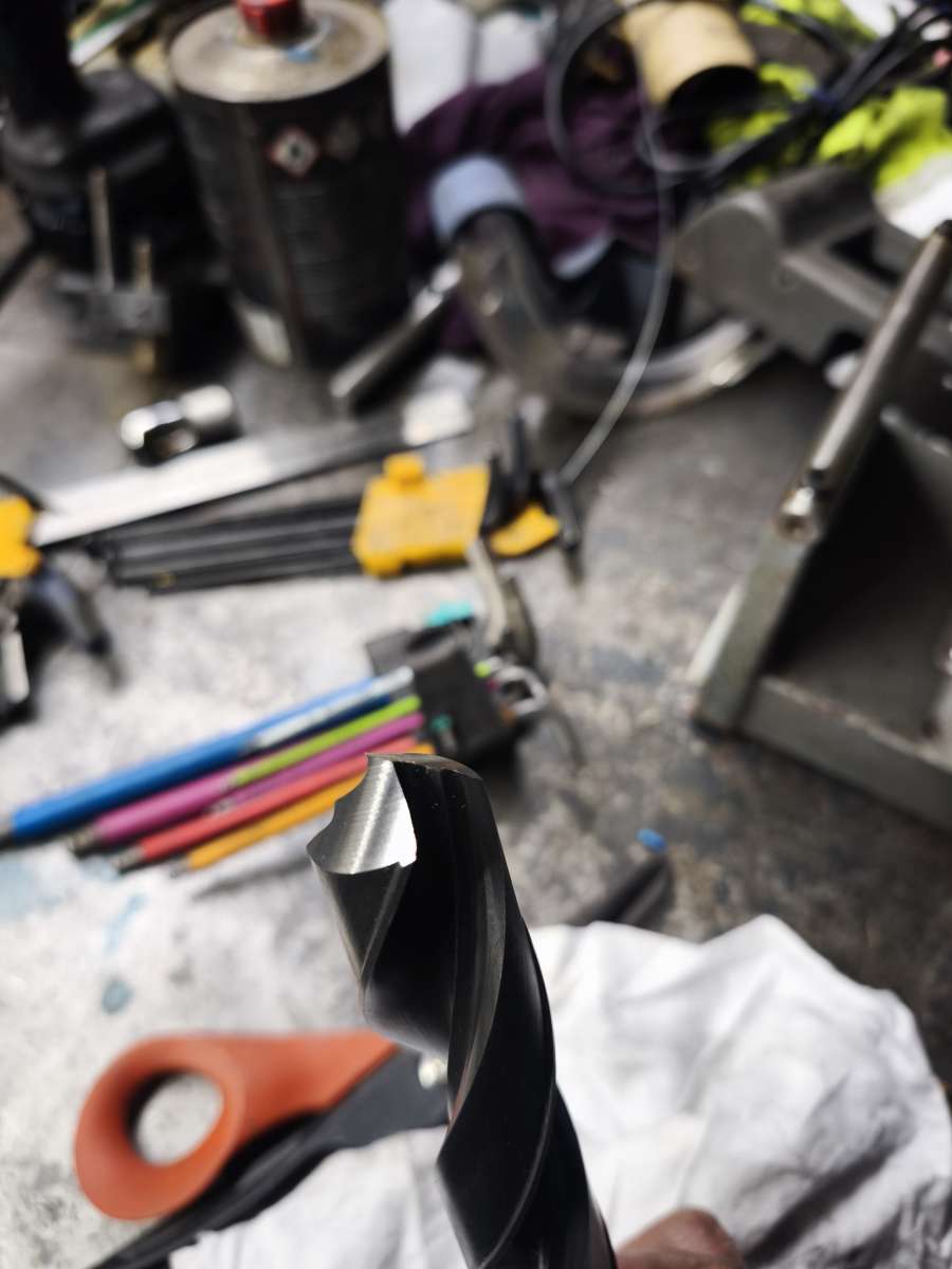

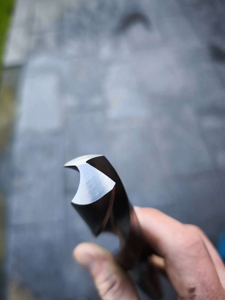

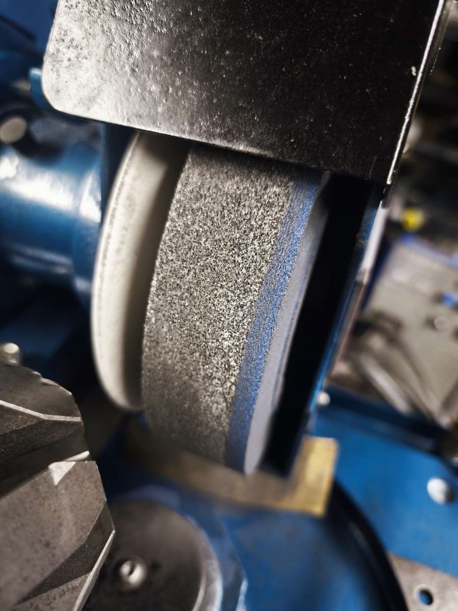

                                      Today I have rebalanced the wheel.
                                      IMG_20250105_124435

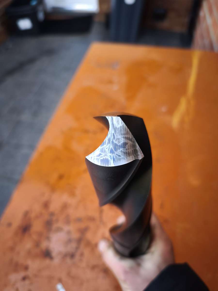

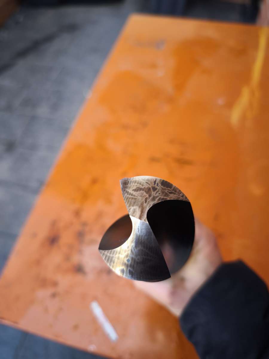

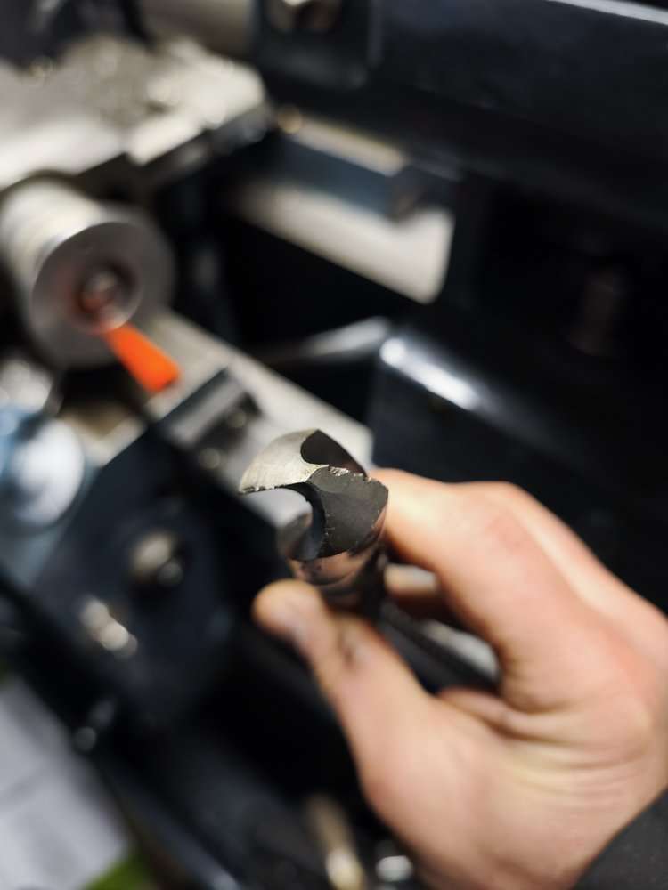

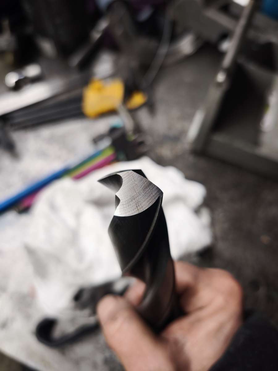

                                      I took photos of a drill I had previously sharpened (with the grinding lines) and then reground it again after the wheel had been balanced.
                                      Before
                                      IMG_20250105_125708
                                      IMG_20250105_125723
                                      After
                                      IMG_20250105_130337
                                      IMG_20250105_130356
                                      A bit of an improvement but there are still slight grinding lines/marks. I don’t think it will affect the drill’s performance.

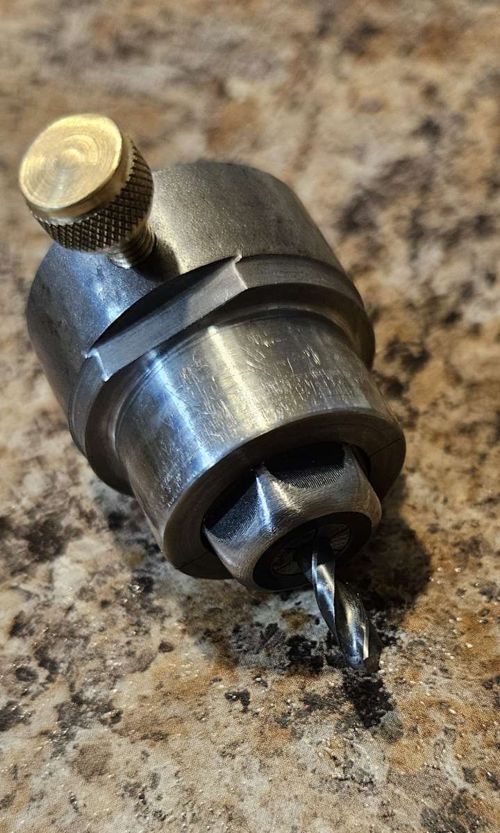

                                        The promised photos of the countersink attachment.
                                        IMG_20250105_130442
                                        IMG_20250105_130459
                                        With the sleeve pulled back (the operation is similar to the wheel dressing attachment).
                                        IMG_20250105_130511
                                        It seems like it has got its own ‘built in’ cam. I guess you tighten the attachment in the chuck and then rotate the countersing attachment’s handle instead of the machine’s head handle. I am guessing the mark (line) on the attachment must be used for setup.

                                          Castrol Cooledge will be fine for the Brierley, regarding the countersink tool it is held in the chuck with the chuck locked from rotating, from memory it only does single flute countersinks, conventional three flute ones can be sharpened using the appropriate cam and the lowest setting on the relief dial. Your latest drill sharpening looks good. Do you have any of the other accessories with your machine?

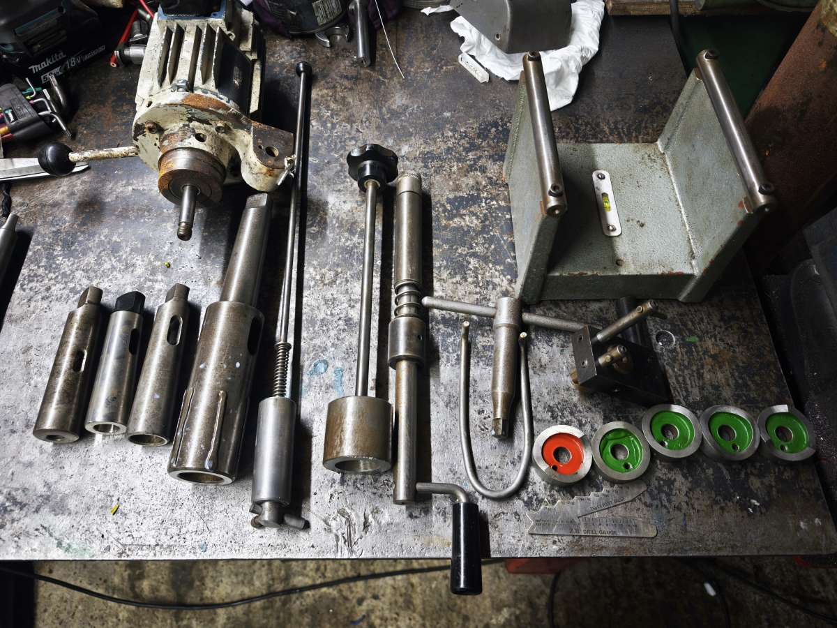

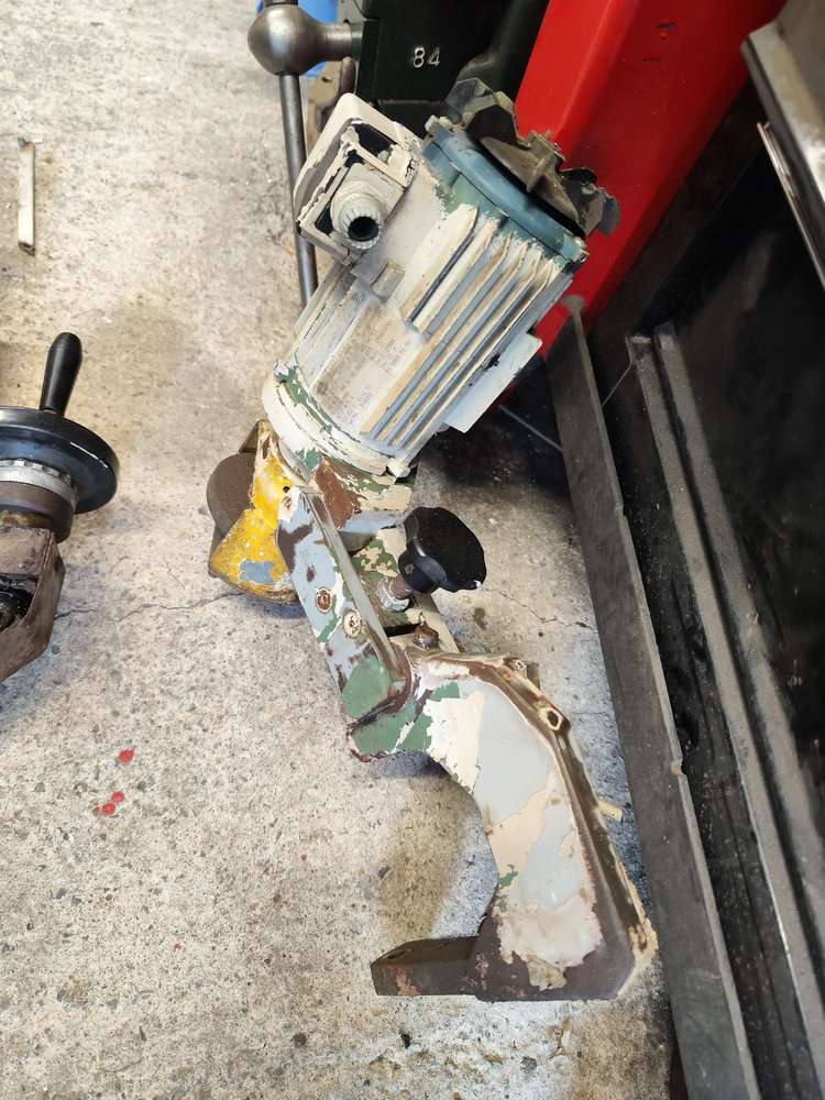

                                            @janraap84676

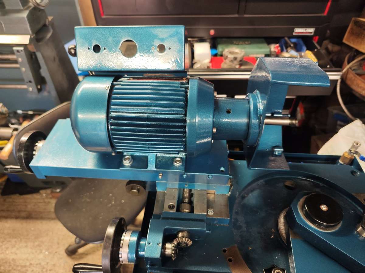

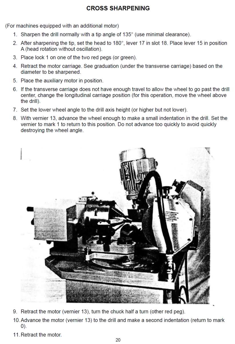

                                            This is all the accessories I have.
                                            IMG_20250105_165650
                                            The No 2 Cam is still on the machine.

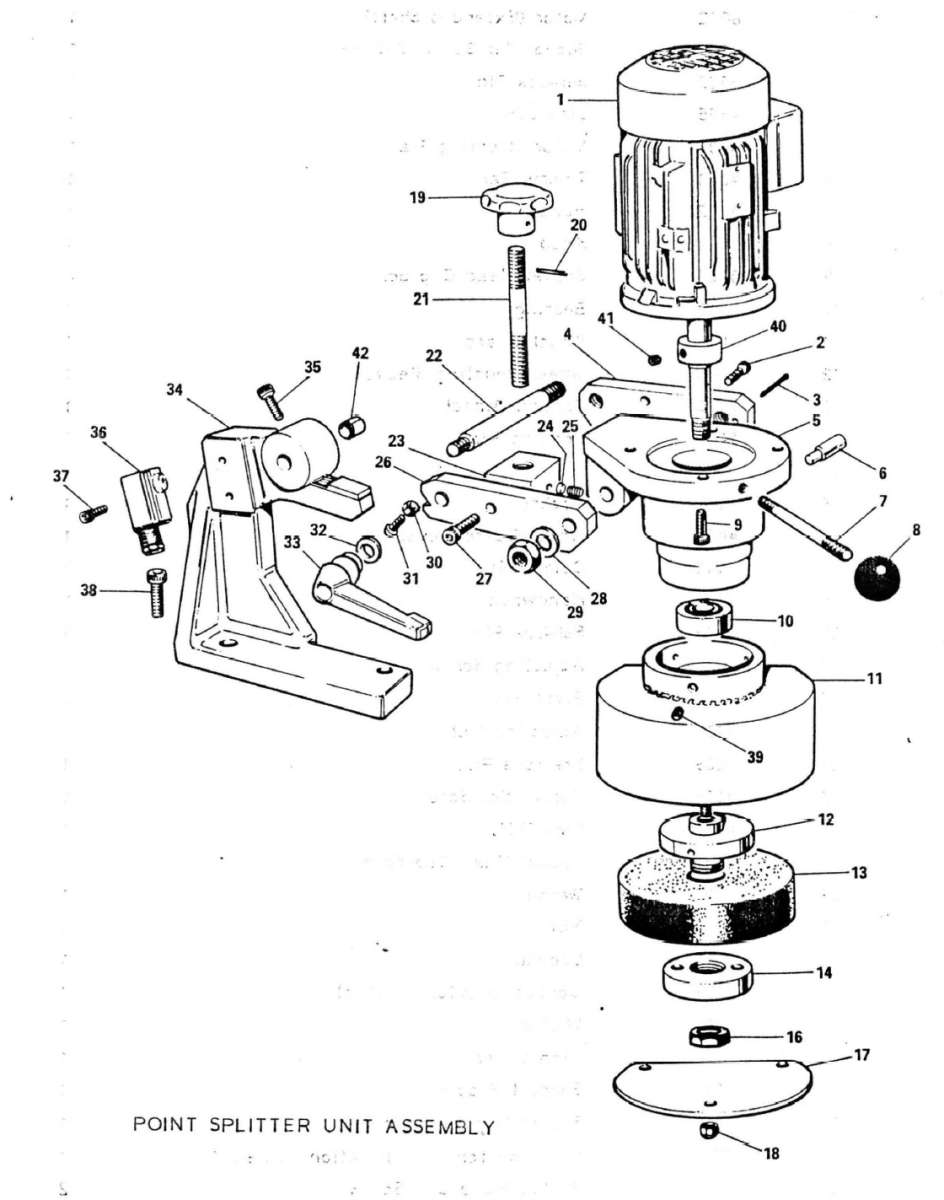

                                            Also shown is the additional split point motor that still needs to be paint stripped, painted and refitted.
                                            In the translated manual, it is called ‘cross sharpening’ probably a translation error.
                                            Brierley Split point 1
                                            Brierley Split point 2
                                            Brierley Split point 3
                                            #774603
                                            Baz
                                              @baz89810
                                              Looks like you also have the sub land grinding attachment, the black thing just above the row of green cams, this is handy for grinding lands on step drills.

                                                Concerning the single lip countersink sharpener I’ve often wondered whether the necessary feed on a device conceptually similar to the Brierley could be produced via screw thread of appropriate pitch.
                                                Basically the idea is that by turning the device through a full circle the cone behind the cutting edge would be ground back to provide functional relief angle. Obviously the starting point needs a certain offset to generate the tip. My imagination isn’t up to visualising the 3D geometry needed to get the offset right so I’ve never had the bottle to try. I think the actual feed needed over almost a turn could be measured directly.
                                                After several sharpenings the cutter would need to be re-gashed but judging by the life of mine I can’t see it being pressing problem in the home shop.

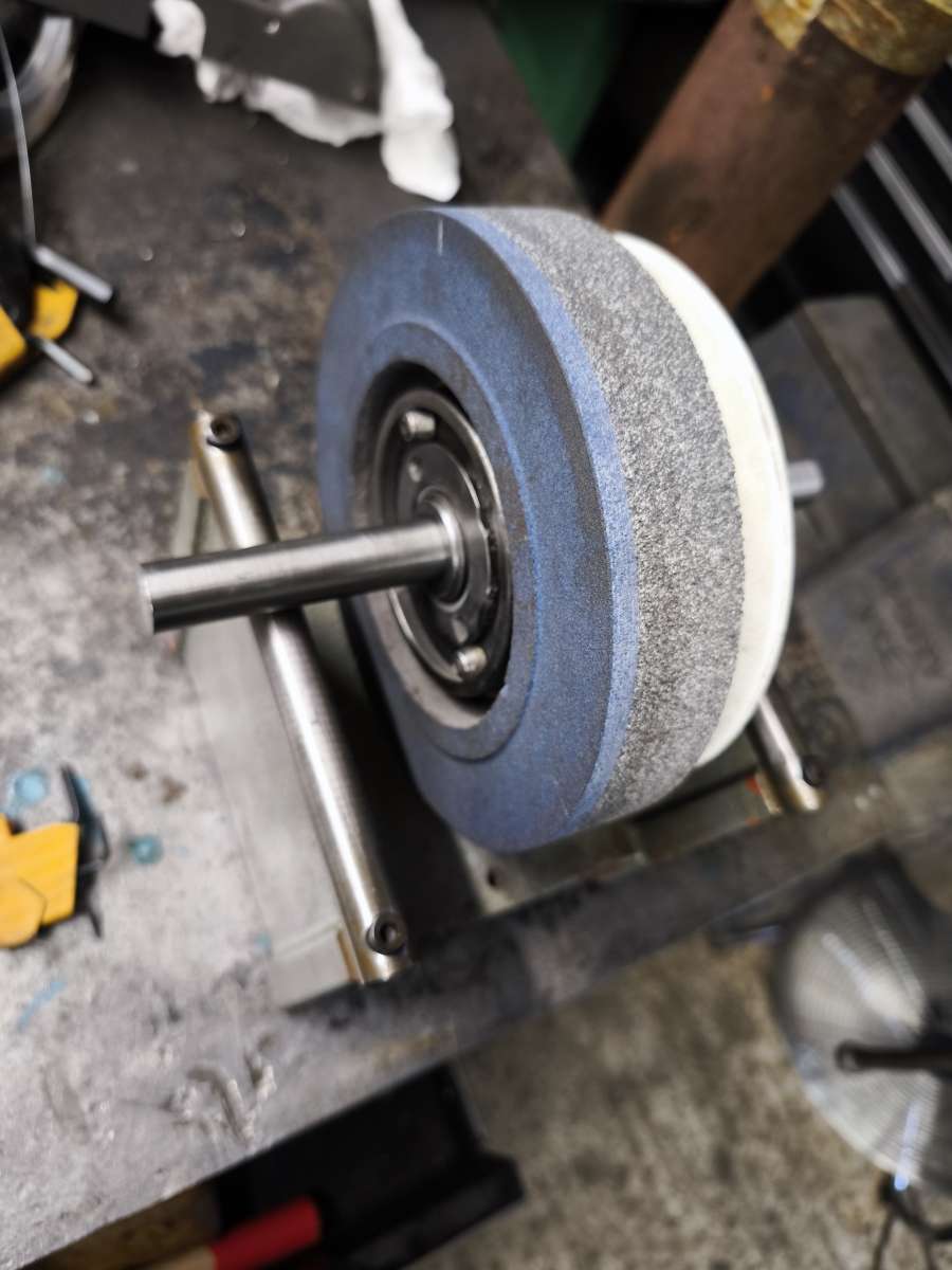

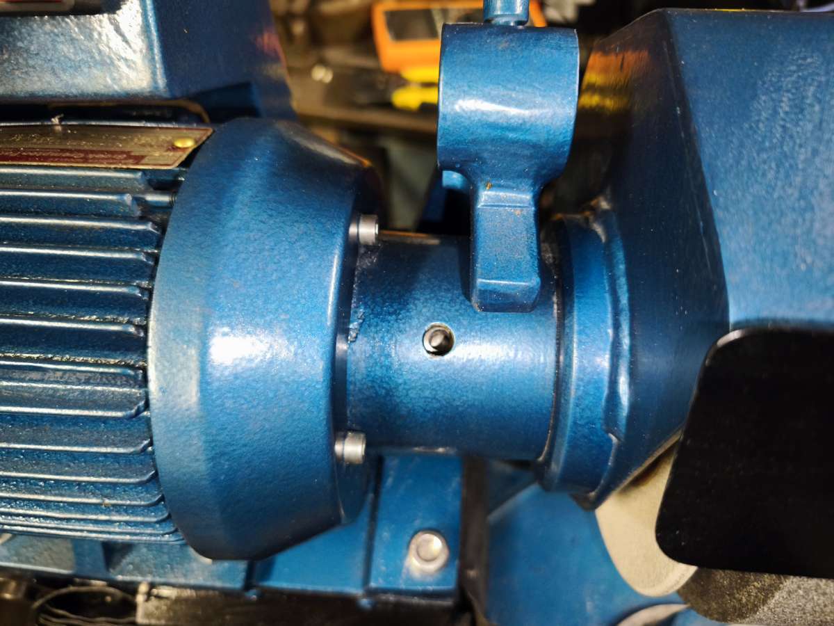

                                                  So, gather round, fellow tinkerers, as I recount a tale of excitement, questionable decisions, and one spectacularly bad idea.
                                                  A few days ago, I took a look at the old grinding wheel from the point-splitting motor on my trusty Brierley ZB50 drill grinder. It had that “seen better days” look about it – the kind of look that makes you think, “This probably shouldn’t spin at high speed near my face.”
                                                  Naturally, I conducted the ring test. Hung it on a screwdriver shaft, gave it a light tap, and… nothing. Not the reassuring ting of a solid wheel, but the dull thud of something that might want to kill me. To confirm, I grabbed another (larger) wheel and tapped that – ring-a-ding-ding! Just as expected. Tried the suspect wheel again – no ring. Conclusion? Wheel’s bad. I ordered a replacement from Zoro. So far, so good. Safety first, right?
                                                  But then, mistake number one: I didn’t immediately destroy and bin the old wheel. Instead, I set it aside, where it silently awaited its chance to shine in this tragic comedy.
                                                  Fast forward to yesterday. I finished wiring up the VFD and got the point-splitting motor mounted. A moment of pride! Naturally, I wanted to show off this fine piece of engineering. Took a video of the startup, but without a wheel or holder installed, it just looked like… well, a motor spinning. A bit anticlimactic, really.
                                                  Enter mistake number two. “What harm could it do,” I thought, “to pop the old, KNOWN BAD, grinding wheel on just for a quick video?” Surely, the universe would grant me this tiny indulgence.
                                                  Spoiler: it did not.
                                                  The wheel, unsurprisingly, came apart.
                                                  Thankfully, I emerged unscathed, though my dignity remains in pieces alongside the wheel. In hindsight, this was one of the most idiotic decisions I have ever made. And that’s saying something for someone who owns a VFD and thinks “quick video” trumps “basic safety.”
