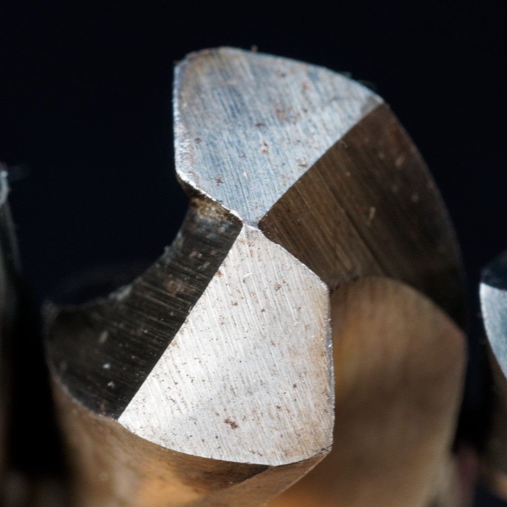

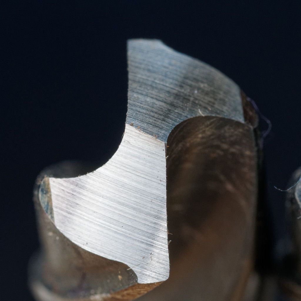

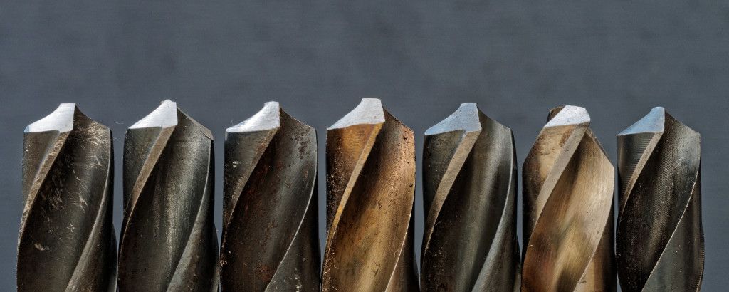

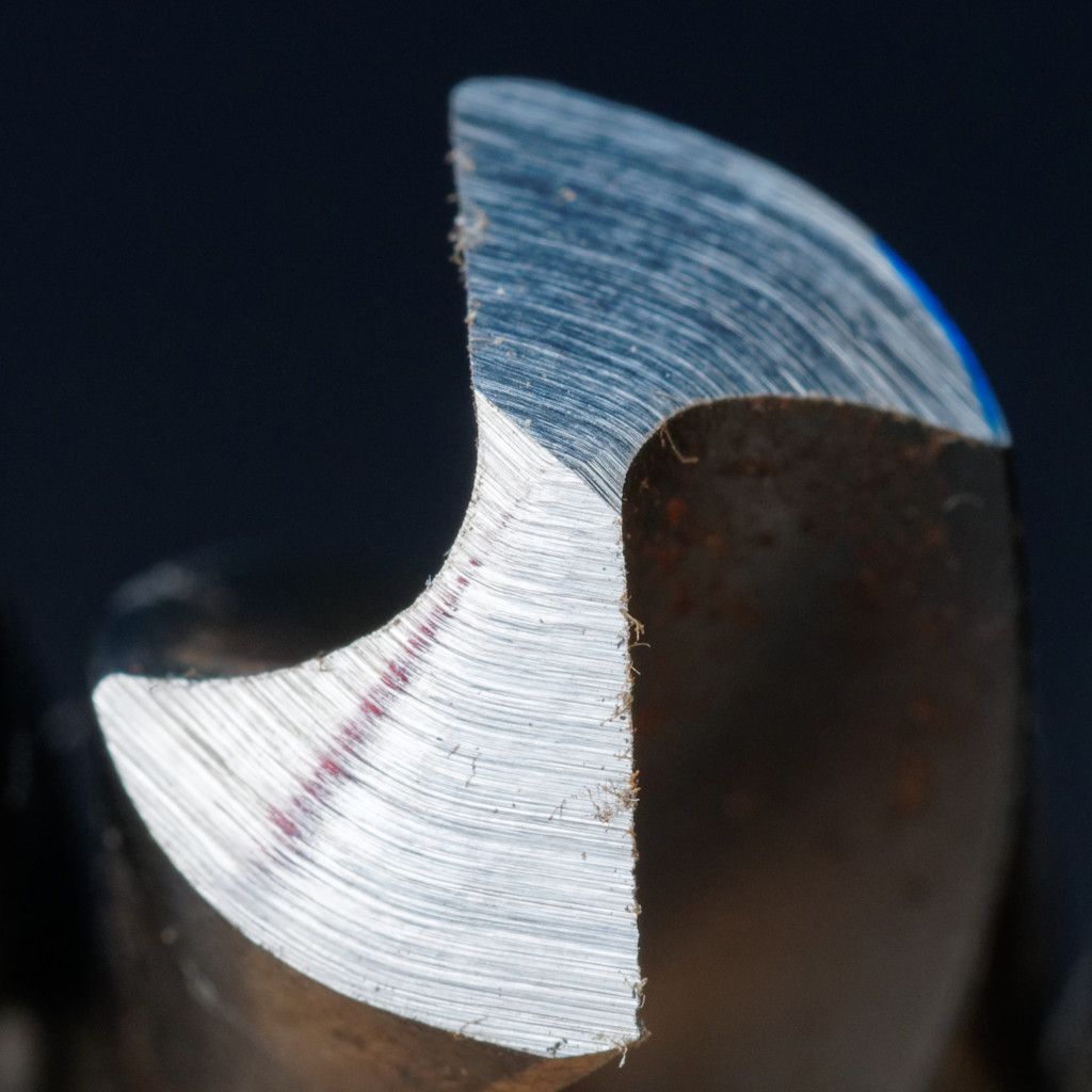

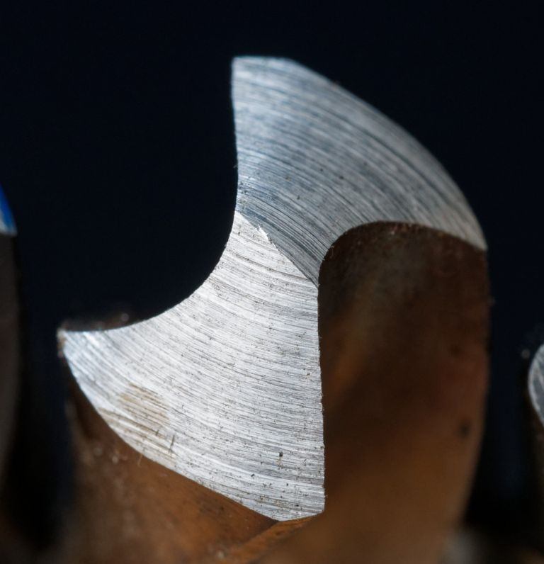

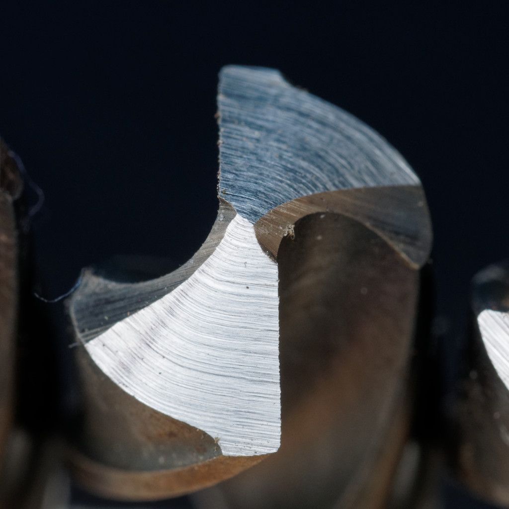

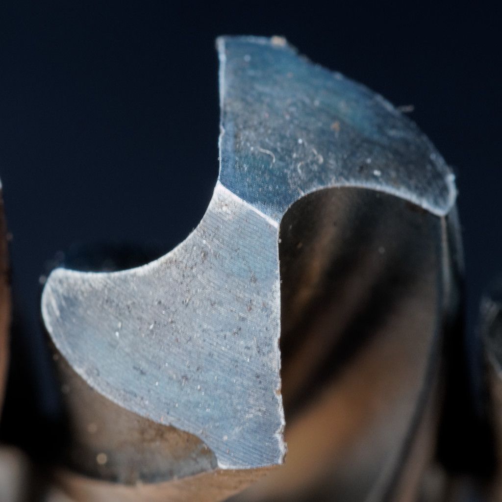

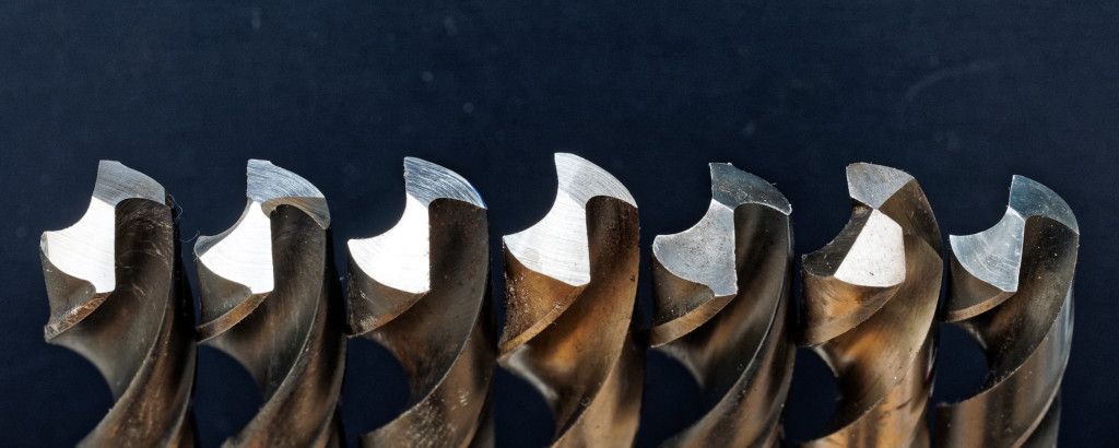

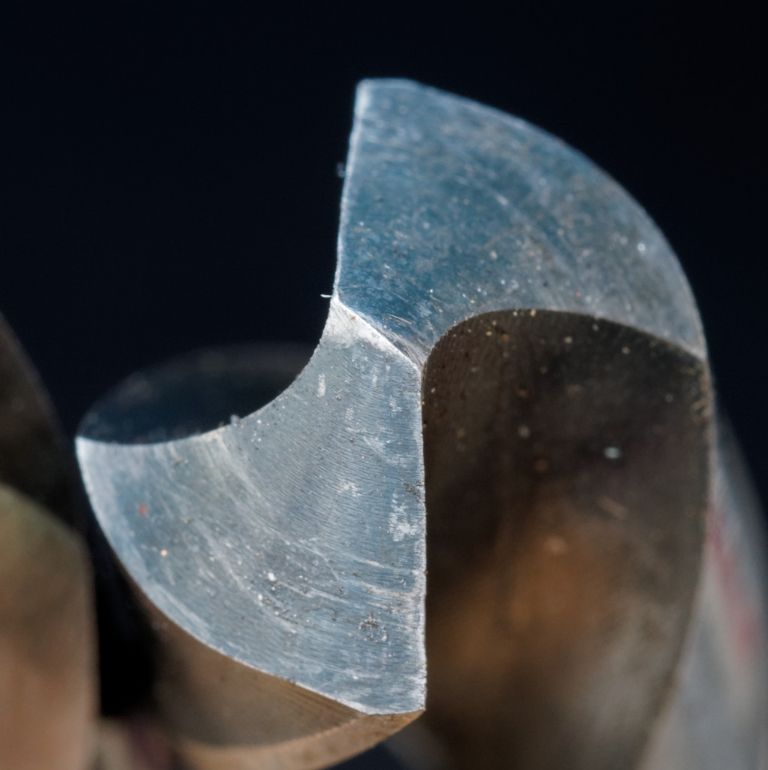

      I've been having a bit of a play this afternoon as the weather wasn't up to much.
      Rather than hijack the other thread, which was asking specifically about the Sealey SMS2008 drill sharpener, I thought I'd start a new one for a quick comparison.
      Maybe others could contribute some ideas and photos to this thread, so that it could be used for reference and learning.
      Doubletop-Pete commented, in the above thread, that he felt that his Sealey was taking off too much metal; so was mine out of the box, albeit a second hand box.
      Sliding the wheel towards the motor, will reduce the depth of cut on the primary grind, as it's a tapered wheel.
      It's a bit of a fine line as moving the wheel also affects the split point grind.
      As you can see from my efforts, I've not quite got it right yet, but even 1/2" bits ground like this, will start off without a pilot hole or centre pop, though I accept the latter's bad practice.
      Sorry about the quality of the photos. I was trying to do it in natural light in the conservatory, but it was starting to get a bit dark.
      The whole project took rather longer than planned blush
      I sharpened several 1/2" bits using;
      A Sealey SMS2008,
      A brand new genuine Picador jig; Note that the Picador jig has the vertical pivot, and in theory at least, should work OK out of the box. Drill bit orientation is set by a movable detent on the flute to be ground.
      I used 1/4" projection beyond the end of the jig, as recommended for larger drill bits.
      It's a different geometry  to the various clones with the tilted pivot.
      A Reliance No.2 (which needs the bit cutting edge setting by eye). On this one it's recommended to use a projection of three times the drill diameter, so in this case  1 1/2"
      The two jigs (Picador and Reliance) were used on a cup wheel on a Clarkson cutter Grinder. (As you can see, the wheel's a bit coarse really, but it's all I had available at the time.)
      The new Picador had a bit of play in the mounting foot, as it's only held together with a cask Mazak name plate, so I temporarily nipped it up a bit with a little toolmakers clamp.
      I don't claim to be any expert at drill sharpening, but am generally considered reasonably dexterous. I'm sure many on here get perfect results freehand; I know can't crying
      Left to Right, Picador, Sealey Split Point, Sealey Plain Grind, Reliance, New Unknown Make, New Unknown Make Four Facet, and lastly a New Presto 7/16" ( I didn't have a new 1/2" one).
      The middle one, ground on the Reliance, was an older Morse tapered one which doesn't look to have had the flutes ground very well from new, hence the odd side view of the relief.
      Unknown Make New(ish) Commercially Ground;photo-5 commercial bc260107_dxo-small.jpg
      Unknown Make New(ish) Four Facet Commercially Ground;photo-6 commercial four  facet bc260104_dxo-small.jpg
      New(ish) Presto 7/16" (enlarged to similar size for comparison);photo-7 presto bc260105_dxo-small.jpg

          Interesting results.
          I also did the "take out the pivot play" thing on a Picador. Discovered that the darn thing worked better with things "as delivered" slack. With the play taken out there isn't quite enough clearance angle at the a back of the flute with larger drills. From memory the effect starts to bite around 3/8" – 7/16". 1/2" drill ended up really sharp on the edge but barely, if at all, cut once fully engaged due to the back of the flute rubbing. Poor thing got a 5 years + stay in the box after that before I decided to give it another go following the instructions rather than improving things. Sometimes the maker does know better and sometimes crude works where precise doesn't.
          Essential to make arrangements to accurately and easily adjust the distance between drill jig base and grinding wheel without things twisting and sliding every which way. Mine sits on a scrap of 1/4 plate bolted to the bench with 10 gauge side-plates to keep the jig straight. Wort thing then is getting the projection and angle of twist right. That darn location finger is rather un-useful. Mine gets done more or less by eye with the finger as a reference rather than a stop. I found a narrow, 1/2" or so, cup wheel more reliable than just using the side of a normal wheel.
          When it comes to drill setting and location the cheap plastic, but rather decently performing, one in the original Plasplugs multiple sharpener set is the best I've seen. Positive stop for the projection with a sliding Vee gauge to set the angle of twist. "Grip the drill gently in the Vee holder and lightly push it forwards against the stop then turn until gauge is at it's lower point. Then tighten up the drill holder so that it is firmly held." Drill holder fits in the grinder proper both ways up so none of this business of trying to set the second edge exactly 180° to the first. Just grind one side, flip the whole darn thing and do t'other one. Genius. Why aren't they all made that way. Pity flexi plastic construction and trying to make the thing for thruppence three-farthing when fourpence ha-penny would have been a better budget makes getting best results a minor art.

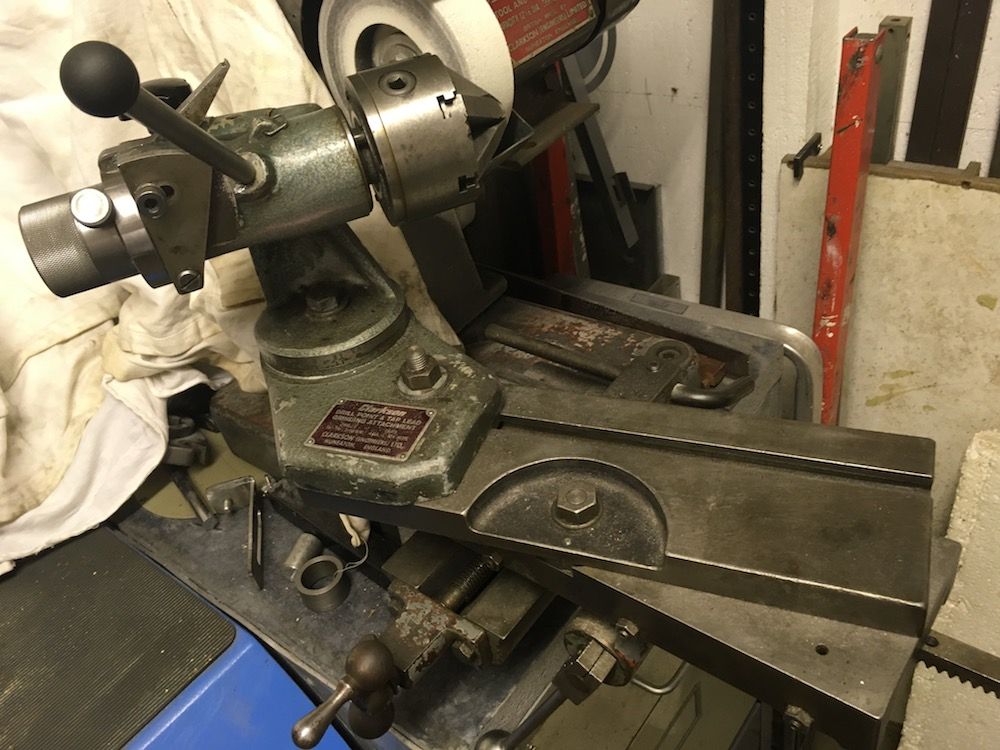

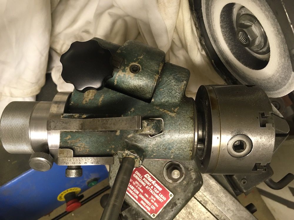

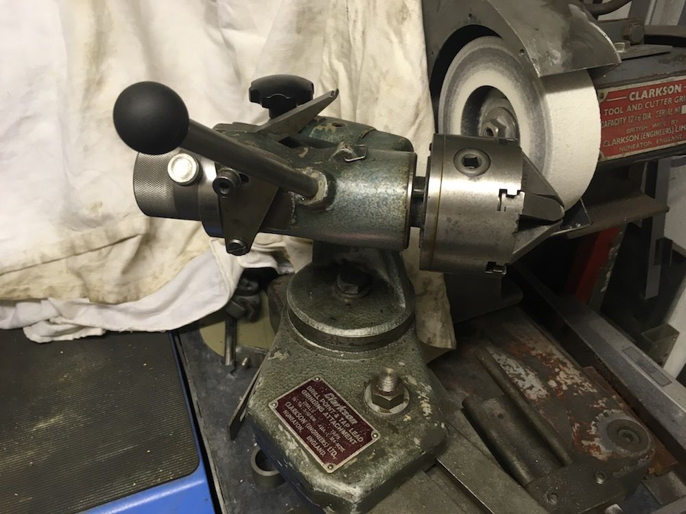

                  As requested shifting Clarkson drill sharpener discussions from Dereks Cup Wheel thread of 12/08/2020.
                  Starting at the beginning the Clarkson system uses a 6 jaw chuck with long sloped jaws to hold any drill from about 2.5 mm to 16 mm, 1/8" to 5/8" diameter. The chuck jaws are about 2 1/2" total length so as to grip the spiral lands in a stable manner.
                  Setting up merely requires the cutting edge on the wheel side to be set level with its outside end, i.e the full diameter of the drill, 1/2" proud of the chuck jaws. The instructions say that there is a setting gauge to make this easier. I've never seen one or a picture of one. The chuck mounting shaft is free to rotate in its carrier casting with an indexing device at the other end to select the second edge. Obviously it is bored out to give the drill shank somewhere to go. The carrier casting pivots up and down on a shaft fixed into the main support post. The pivot shaft is set at an angle to the chuck carrying post so that swinging the cutting edge upwards grinds the correct clearance on the drill.
                  Assuming the chuck carrier shaft is set to as to give the correct point angle the only requirements for a correctly backed off drill are :-
                  1) the pivot shaft and chuck carrier shaft be at the correct relative angles
                  2) the drill cutting edge is the correct distance from the intersection of the shaft centre lines.
                  So far as I can see the shaft centre lines are in the same plane which is perpendicular to the cup wheel face.
                  Hence given the shaft angles it should be relatively easy to replicate the sharpening geometry with a simple post support. Some means of applying controlled small cuts is essential. Already present if fitted to a T&C grinder. Otherwise some sort of screw or micrometer controlled slide will be needed.
                  The actual Clarkson implementation is angularily more complex to incorporate tap lead grinding.
                  Photos show the device moved clear of the grinding wheel so a drill can be put in the chuck. Grubby wheel is still flat so not due for dressing. Yet!
                  Whole thing on Clarkson
                  Side View
                  Top View showing indexing device, shaft angles and spring loaded pin that sets chuck position
                  The calibrated cam-plate device next to the pivoting handle isn't used for drill sharpening.
                  Clive

                    Thanks for that Clive, the top view makes things a bit clearer.
                    I do have a Mk1 Clarkson T&C grinder that I obtained from a neighbour who runs the local skip hire company.
                    I've never seen their drill sharpening gizmo in real life, nor spotted one at a justifiable price for hobby use.
                    I've also got a Speetol tap lead attachment completely separate, so no real need for incorporating it into a drill sharpener.
                    We've discussed this before, but I'll post a link for other readers.
                    I've still not used it properly yet as I spent most of the local lockdown fettling the Herbert.
                    I get the idea roughly now, in that you set the drill cutting edge's included angle on the top table of the grinder and the pivoting action of the chuck off-axis provides the curved relief.
                    A short reply as I'm between courses of our tea.
                    Cheers
                    Bill

                      Not quite. The grinder table angle is irrelevant. All that matters is that the drill is at the right angle to the grinding wheel to give the desired point angle.
                      The factory Clarkson set up has the table at 15° for drill sharpening because that makes calibration easier for the tap grinding function which has the table at a different angle anyway.
                      Clive

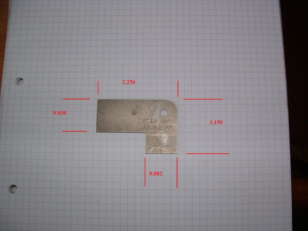

                            CLARKSON SETTING GAUGE.
                            poor photo attached, gauge is 1/16" thick, legend reads "STANDARD CLEARANCE" with + to lhs of the line and – to rhs.

                              The lands look too wide to me on the Unknown Make New(ish) Four Facet Commercially Ground; pictured above, also I understood the grind lines between clearance angles should be parallel on a correctly ground 4 facet drill.
                              Emgee

                                If you can access a cutter grinder, the four facet method is by far the best method of drill sharpening.
                                Effectively an end mill ground at an angle.
                                Very effective, and reputed to be self centering, and so no need for centre drills or spotting drills.

                                Clive Foster
                                  @clivefoster55965
                                  Great picture of the setting gauge. Many thanks.
                                  All drawn up and ready to make next time I'm on t'mill.

                                            @neillickfold44316
                                            Great thread and pictures.
                                            Your split point is what I call a web thinned drill.
                                            Your 4 facet is what I call a split point drill.
                                            The 4 facet drill grind, is when it is sharpened like the new plain ones, but then an extra relief is ground on each side, that aligns very closely to the very centre of the drill. I sharpen mine mostly by hand. The 4 facet that I mentioned, is not easy to do manually but, if I sharpen on a weekly basis it keeps my eye in. The relieved standard grind or the 4 facet as I call it, seems to last the most number of drilled holes.
                                            The split point drill geometry takes the least amount of pressure to drill a hole. Even with a 32mm drill, can be used without a smaller pilot drill in a large enough machine. On the S7, a split point 5/8 drill will drill very well without a pilot hole.
                                            Work has an old Darex drill sharpener that will create the std grind, the web thin option and the split point option as well. It won’t create what I call the 4 facet option and sharpens drills from 3mm to 3/4 inch. It will not hold a 20mm spot drill.
                                            I use a very small centre point/spot drill/centre drill to create the initial starting pocket. Usually only about 1mm deep or so. Then I drill at a slower rpm and a very fine feed rate until about 1 drill diameter deep. Then increase the speed for that size drill and drill at a modest feed rate. Normally no more than 2 thou per rev (0.05mm). I end up with mostly straight holes that are very close to the correct size. Sometimes a hole will wonder , and have found that to be in the cheaper material stocks where quality control is not the best, or it has got hot and effected the material being drilled. Use ample cutting fluid and if it gets hot, drill bit or work piece, then slow down the rpm.
