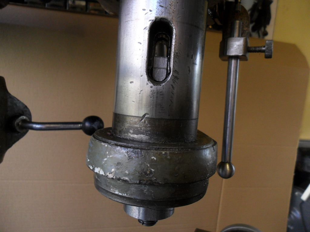

      Now a question. Does anyone know which back geared drill used a pin in the bull wheel like some lathes and had a pulley cover that moved up and backwards while staying parallel to its closed position? Just that we had one at work and curious as to what it was. My intro to that workshop was using it to trepan 3 in holes for moving coil meters.
      Hello Bazyle.
      I think the drill you might be thinking of is the Kerry Super 8 back geared pillar drill. I used to own one of these and it had the features you mention, I wish I had never sold it.
      John.
       I have an Elliot Progress 2G back geared pillar drill now. This has thick heavy castings with a solid round steel column, a quill lock and a quill that is a precise fit in the bore of the head casting and with a speed range of 45 – 2500 RPM. But even this protests when used for milling although it is just about possible with small cutters, but is still a bit dodgy.

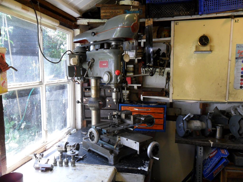

            Hi Lathejack & Guy
            Here is a photo of my Kerry Super 8with guard up also showing some cutters on bench

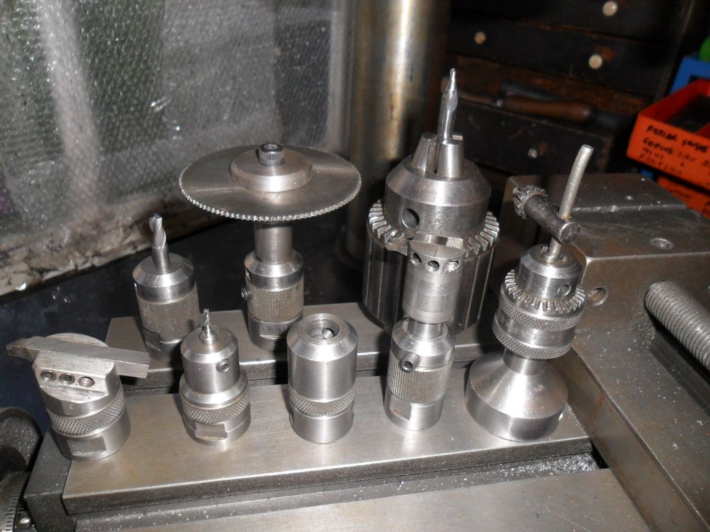

                  various cutters6 m.m cutter holderHi Yngvar
                  I fitted a mandrel that I screw my drill chuck., cutter holders, fly cutter ect to as you know it has a morse taper 2
                  Please see photo or my album No morse taper Nobbytry this

                    Thank you.
                    That is a clever solution. You have given me some ideas how to proceed with mine.

                      Hello Nobby.
                      Your shorter bench top drill with the milling table on the drill base casting looks more suitable for milling. My Elliot Progress is a taller floor standing type, so I had to mount my milling table on the drill table. I bought exactly the same milling table as the one you have modified, I got it from Axminster Tools almost twenty years ago, I think it was called the CT1, Home And Workshop Machinery sell them now.
                      I used a 2MT milling chuck, for threaded cutters, from Modeloy, remember them? With a simple but effective mod to the milling chuck and drill spindle to keep it in place.
                      I only experimented and used it briefly all those years ago, as once I restocked my workshop with more machinery it was returned to just a drill, the milling table is still under the bench somewhere.
                      You seem to have the whole thing well sorted, and it obviously works very well.

                        Nobby
                        I am envious of the location next to the window. Beautiful light; at least during the daytime. I have many lights in my basement shop. Sometimes I wish had more windows. Then again, if I had more windows, the neighbors might occasionally catch me scratching my extremities.
