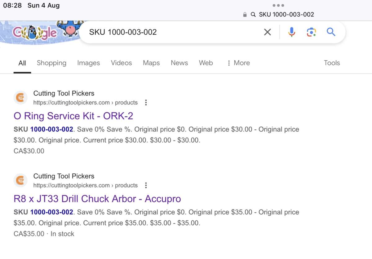

                                        #745059
                                          This would seem to suggest Accupro are made in South Korea
                                          #745065
                                            Although one might be wary of the Vendor’s Stock-Keeping system:
                                            IMG_9993
                                            #745067
                                              Note: __ I think this exhausts my interest in the matter, but someone else may wish to dig deeper:
                                              https://www.prnewswire.com/news-releases/msc-expands-accupro-metalworking-portfolio-300072013.html
                                              My reading of that ^^^ is that MSC uses Accupro as  ‘brand name’ for some of its higher-end products.
                                              So our faith in the quality of the product relies upon MSC
                                              … in much the same way as it does when we trust ARC
