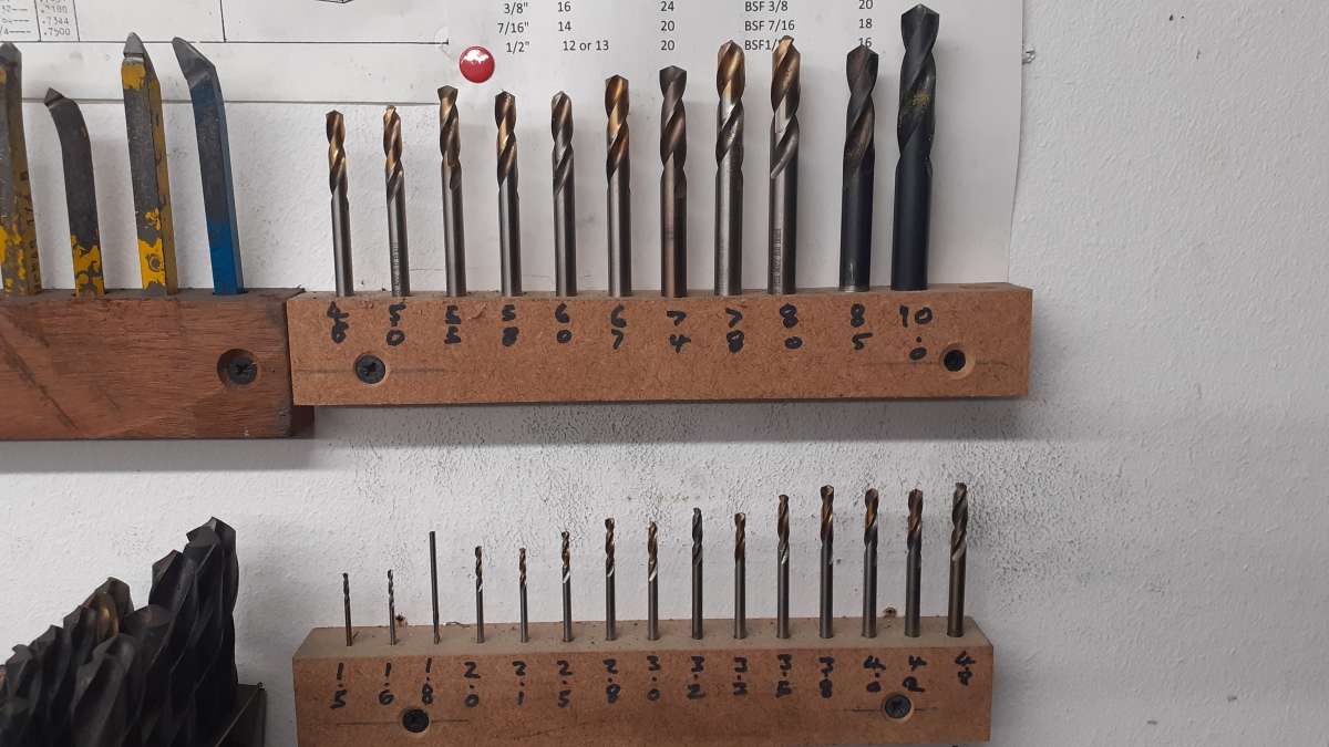

                              Best thing about cheap sets is they then provide a box for you to put your better quality ones in as you replace the cheap ones!
                              I have sets of 1-5.9 and 6-10 in 0.1mm steps and 1/16 -1/2 in 1/64th steps, the common one shaving all been replaced with Dormer over time plus blacksmiths from 9/16 -1″ in 1/8″ steps.
                              But these are my most used drills, more or less what I said above with a couple of extras as I had a box of those sizes, there is another row underneath of imperial. All are stub drills.
                              20231222_133748
