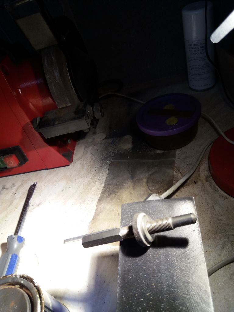

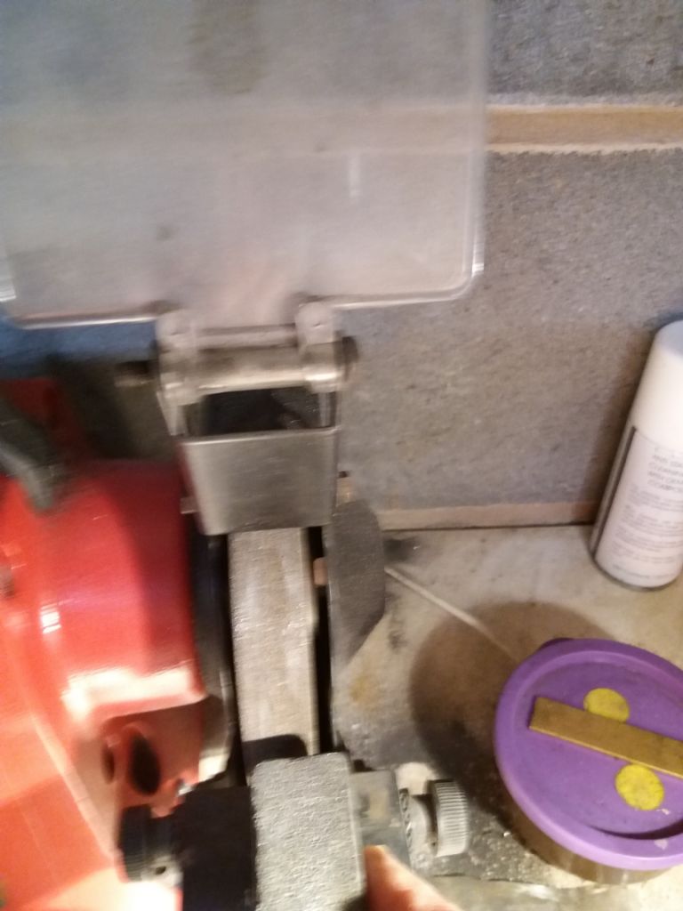

              Hi Martin I have a diamond with a screwed ring that I made and use the front of the tool rest to guide the diamond and keep face square adjusting as necessary and then just lightly dressing the face with a dressing stone see pictures.

                      @David George – I am actually using something comparable but your approach seems more straightforward. Will try. Easy enough.
