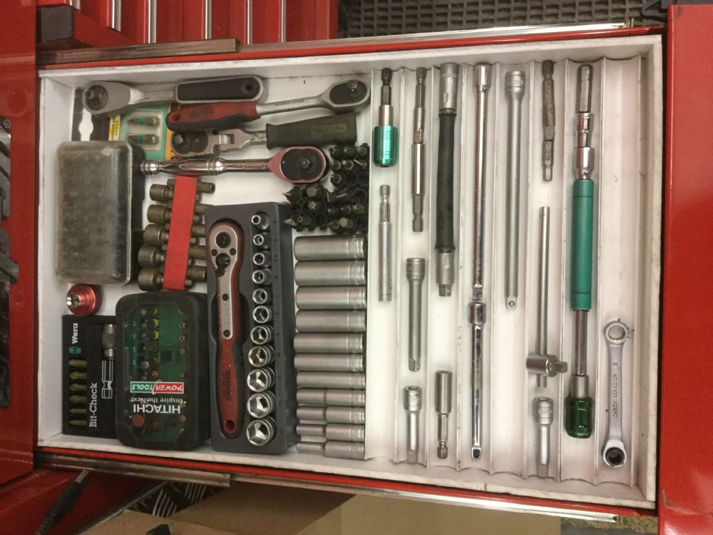

          This is an unfinished prototype made from Solvent weld overflow pipe and foamex board, glued together with superglue.
          It works, but is quite labour intensive.646e612f-a863-49e8-8ac2-b57bf0dcd8a7.jpeg

            As a suggestion, take a look at plastic cutlery trays in the supermarket. They might not be ideal but they are compartmented in a number of ways
            Brian

              Piece of 4mm ply cut to fit draw with some strips of MDF glued to it works for me.

                                        Carpet underlay is quite good – soft neoprene type material and has ribs to stop things rolling around too much. I’ve also made up liners similar to those Jason has pictured – 6mm mdf bases with narrow mdf strips glued on. Dies can be sorted with another bit of 6mm mdf with suitable holes drilled.
