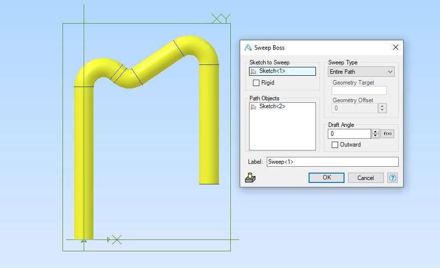

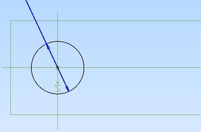

            So sketch a circle the diameter of your wire where you want one end of the spring to start
            spring circle

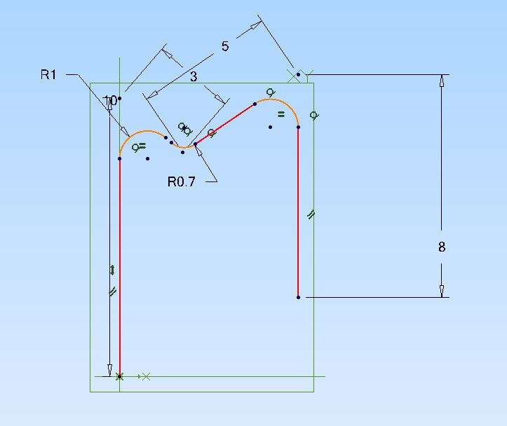

            Then sketch the shape of the bend(s) with one end of the sketch starting at the ctr of the circle put on a plane at right angles to it

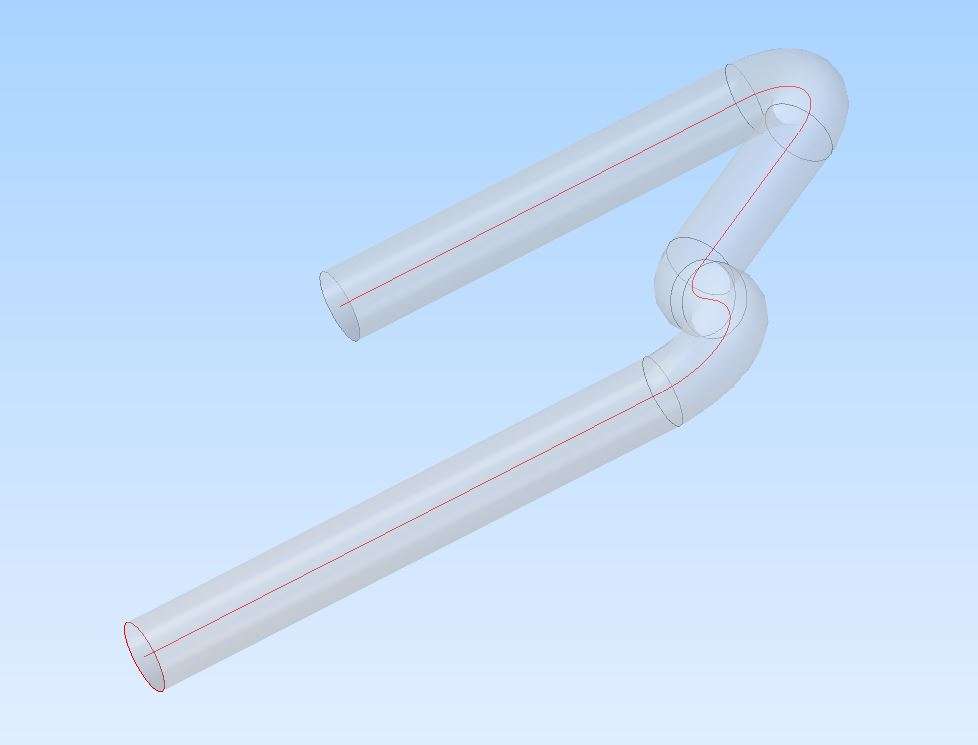

            spring path
            Then sweep the circle (sketch 1) along the path (sketch 2)
            spring sweep
            The red lines show the two sketches and how the path starts from the ctr of the circle. I’ve hidden the axis lines as they were obscuring the red path
            spring sketches

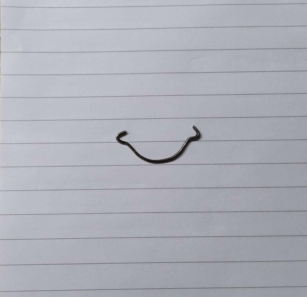

                  EDIT I have drawn a shape of the outline of the spring which looks like a D shape with double recurved ends of a 0.060″ radious on each end. the wire is only 0.040″ thick. it acts like a circlip the prevent a dial coming off the center diamiter piece and gives enough friction to allow the dial to be turned when needed but also turned to set dial as well.
                  20240103_224154

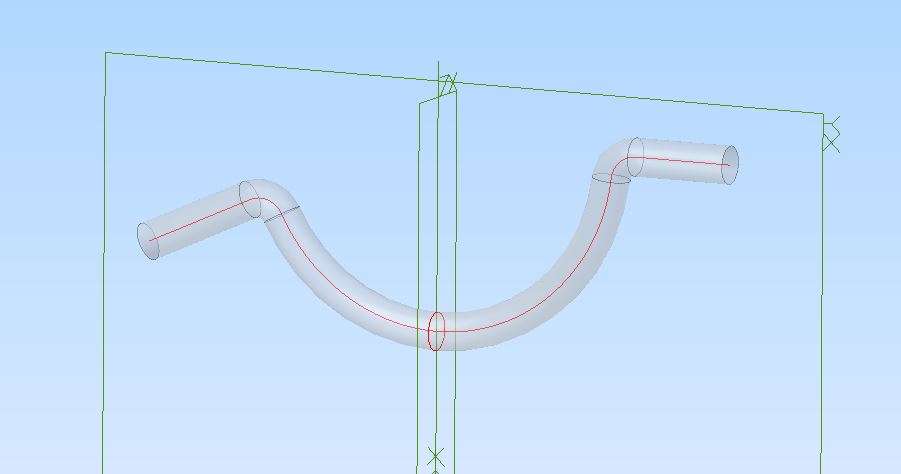

                    For something like that getting the circle perpendicular to one end will be a bit tricky. So I would sketch the circle in the middle and then sketch just one side of the “path” and sweep those. Then use the mirror tool to do the other half. I’m assuming the two ends should actually be bent the same, if not then do separate paths for each half.

                        The circle can actually go anywhere provided it is perpendicular to the path, if you drew the path symmetrically then placing the circle on the plane of symmetry is an option.
                        spring mid

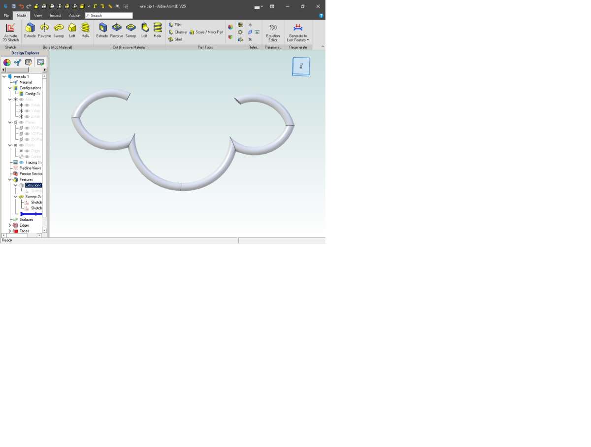

                        Ady1
                          @ady1

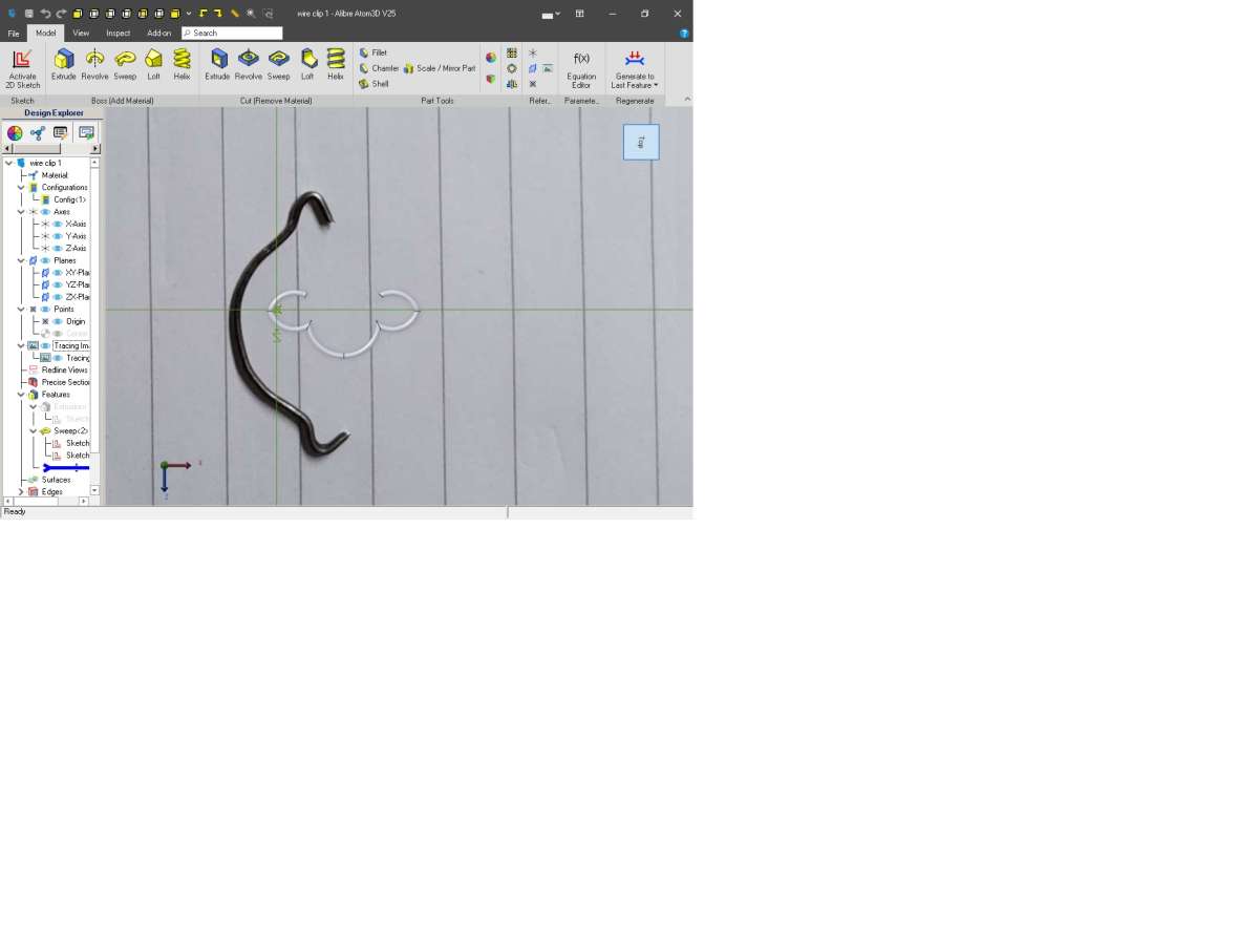

                          If you use the trim tool in 2D sketch you can do all sorts of goofy shapes
                          This was sketched from 3 circles, trimmed, then mirrored then extruded
                          wire clip1

                            clip 2
                            #704393

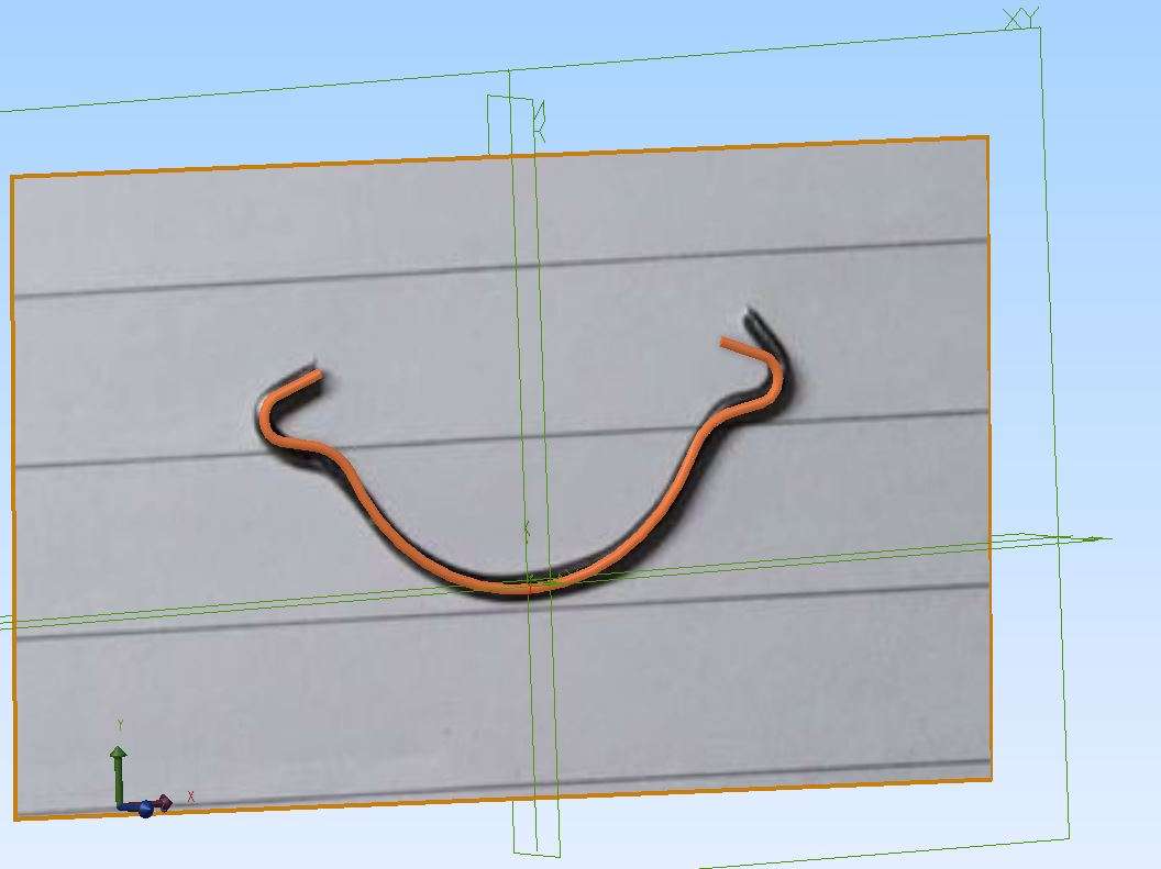

                            Ady1
                              @ady1
                              Insert tracing image function
                              Sometimes you need to sort the picture aspect
                              wire clip2
