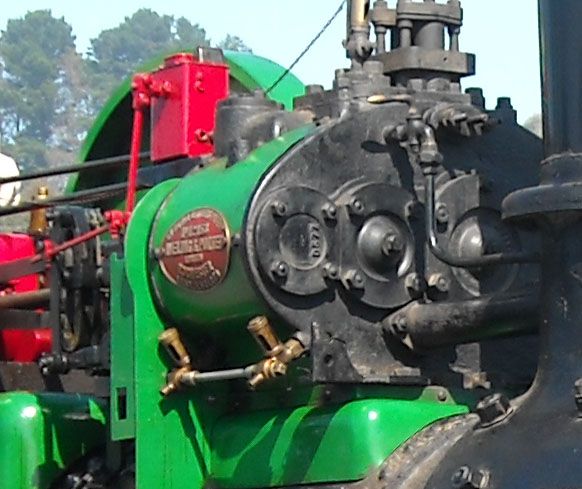

                                  Just a thought – would an automatic cylinder drain cock as used on model locomotives work?
                                  Russell
                                  #331044
                                  Paul Lousick
                                    @paullousick59116
                                    An automatic cylinder drain cock on steam engines is similar to a pressure relief valve. If there is condensate/water in the cylinder, the extra pressure generated because it does not compress like steam/gas is exhausted thru the relief valve instead of blowing out the end of the steam chest,
                                    Paul.

                                            Posted by Paul Lousick on 08/12/2017 11:14:19:
                                            Paul.
                                            Edited By Paul Lousick on 08/12/2017 11:15:12
                                            No it's not, it has a loose ball on the seat which falls away if there is no pressure. It is supposed to not reseat if there is water present, but I've never understood why, and there are mixed reports of their effectiveness. In any case it's not what one needs in this instance

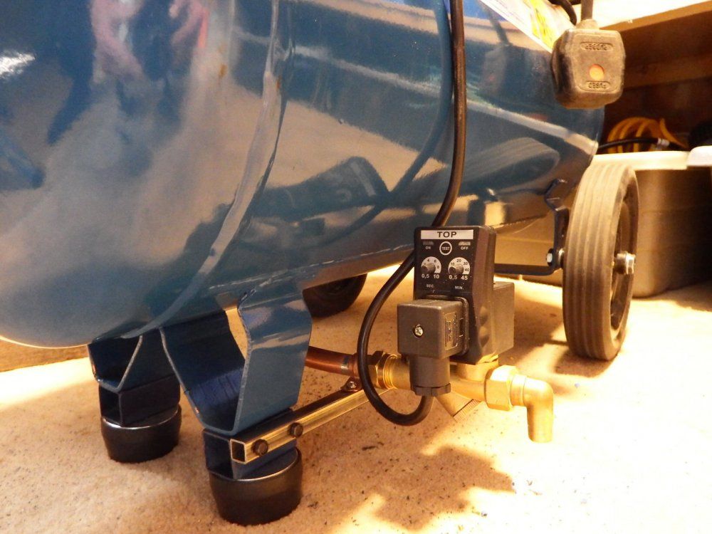

                                              You could always fit an auto drain like this:
                                              Picture from Mig-Welding.co.uk – link: **LINK**
                                              Plenty on eBay for under £20.00
                                              Nishka (must get one for my compressor!)

                                                    Hi Duncan,
                                                    These are what I was referring to as automatic cylinder drain cocks. Shown here on a Avelling and Porter engine. They have a manual lever to open the valve and also a spring loaded vent to atmoshere. (and not suited to the compressor application).
                                                    "It is supposed to not reseat if there is water present, but I've never understood why"
                                                    The ball in your descriibed valve probably seals whether there is water present or not and is open when there is no pressure. And when open would allow any water to drain out. (this should work on the compressor)
                                                    Paul.

                                                      Yes exactly that, a V twin with a wet sump, just like my Ducati; it seemed a double negative to say that it it's none oil-free. I appreciate that I'll need a drier/filter for spraying but I think a plasma cutter would make a bit of a mess of my nice new floor tiles.
                                                      My intention was to add a valve drain cock, rather than the current one which needs a spanner to vent the air tank.
                                                      To save needing to lie down to access the underneath of the tank to drain it, I was going to mount the dump/drain valve at the end of a longer length of copper pipe, attached to a union at the base of the tank.
                                                      Provided there is a low "swan neck" in the copper pipe, the volume and velocity of the escaping air should clear any condensate quite happily. Being a copper vent pipe, any few remaining drops shouldn't cause corrosion issues either. I also need to add a third wheel to raise one end, instead of the current lump of wood, so any condensate runs towards the drain vent, rather than away from it.
