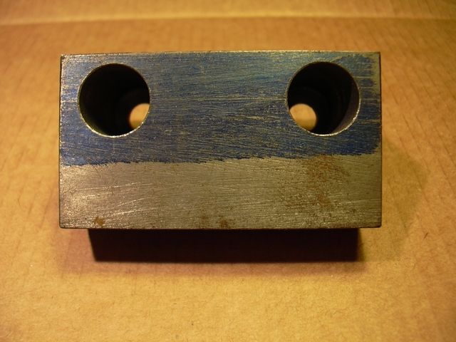

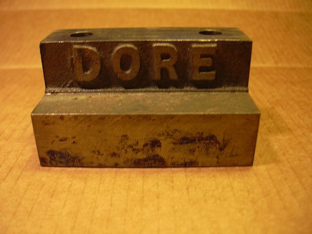

                      Hi there, Andrew,
                      If you go ahead with the Dore design, you'll need some of these:
                      I found three of these in my 'stash' some time ago while looking for something else. I posted these pix here asking if anyone recognised them but nobody did.
                      Best regards,
                      Swarf, Mostly!
                      #312028
                        Probably cheaper to make the holders from a bit of steel or CI bar than buy castings, and then you only really need them if you want to mount direct to the topslide rather than use a toolpost.
                        #312029
