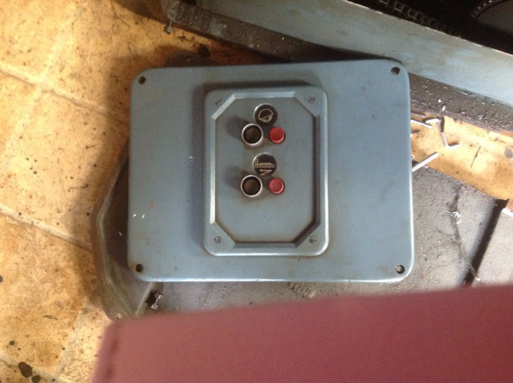

      So far August has been a pain for things going wrong and today has been nothing different, took the switch panel of the front of the surface grinder and it slipped out of my hand pulling out all the wires, can any one tell me the right location they go back in.
      Regards Al.

          Hi Alan
          Those items on the cover, are they 2 pairs of on/off push buttons and
          howmany wires were attached to them, i notice 2 MEM contactors in the
          box. can you perhaps post clearer images of those connections on
          the cover, it looks like the cover carries external controls for the contactors.

            image.jpg buttonsFront of switches, 3 wires to each switch , red,black,green.

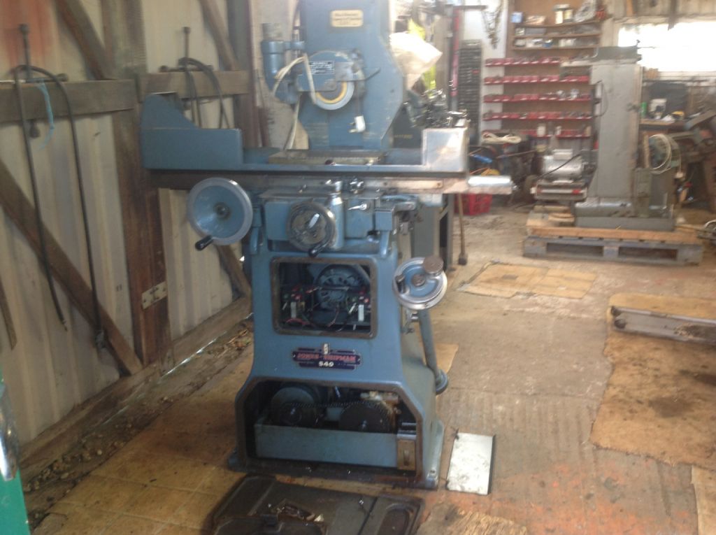

              image.jpg jones & shipman
              This is the machine Steve, is it like yours?
              rob & Al
              dont look at my dead mill in the background,

              David Colwill
                @davidcolwill19261
                See my album J&S 540.
                #127371
                David Colwill
                  @davidcolwill19261
                  I should add that the top of the plate is on the right hand side. On mine this is the wheel on buttons.

                  David Jupp
                    @davidjupp51506
                    Looks like each cable and pair of buttons provides a standard '3 wire remote' for a contactor. Since old colour code mains cable has been used I wouldn't wish to hazard a guess as to what colour goes where, or even if they are consistent between the two sets!
                    NC button should be in series with the contactor stop button, NO button in parallel with contactor start button.
                    Should be simple to anyone familiar with wiring contactors – plenty of generic information around, but if in any doubt call an electrician – better safe than sorry.

                    Robonthemoor
                      @robonthemoor
                      Or first class Steve, yes that's how we thought they would be but nice of you to confirm,

                          Mikelkie
                            @mikelkie
                            Alan
                            i hope you came right with your wiring problem
                            I wanted to send you a drawing how to do this, but I'm
                            unable to load this up, If you are still battling,i could
                            email this to you.
                            Mike M
                            #127616
                            Alan .204
                              @alan-204
                              Thank's Mike we got it sorted in the end we've just got to sort out the power issue to run it now.
