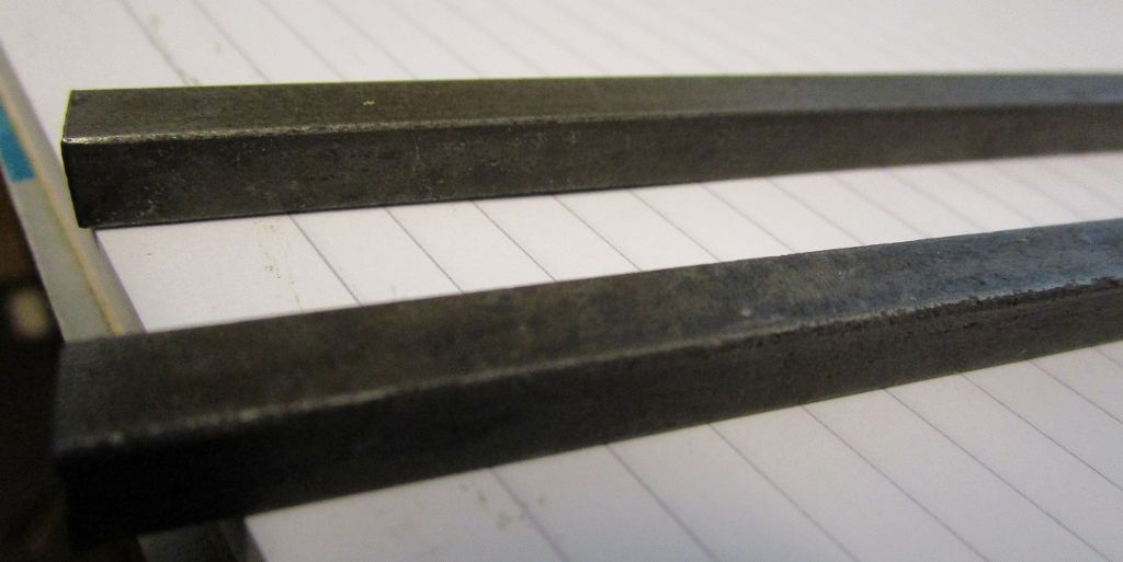

      Hi,
      I have just received 2 bars of 1/4 inch square silver steel. The previous silver steel I have bought has been from other suppliers and has been shiny and new looking. this looks more like mild steel. Being inexperienced I thought I would ask you guys whether it is usual for silver steel to look like this before chasing up the supplier.
      Edited By Chris TickTock on 19/03/2020 10:48:26

        pgk pgk
          @pgkpgk17461
          Typically I've bought it precision ground – hence shiny as you say. Cut a bit off, heat and quench to see if it skates a file.

          #458138
          Frank Gorse
            @frankgorse
            Silver steel and gauge plate are usually supplied ‘shiny’ from the grinding process. If this is discoloured because it’s very old stock ,as it may well be,it should be described as such when you buy it. One clue is that silver steel should be accurately sized to half a thou or so,bdms is usually a bit undesize.

              #458143
              Clive Brown 1
                @clivebrown1
                I bought 1/4" sq. silver steel years ago for lathe tools to make my "Quorn". Looked like BDMS but turned a tough steel casting for the work-head just fine..Incidentally, IMHO, silver steel is much under-rated for making special purpose cutting tools.
                #458144
                J Hancock
                  @jhancock95746
                  You could tape a piece of known silver steel to it, push them onto the grinder and see if the 'sparks' look identical.

                      #458147
                      ega
                        @ega
                        In my experience square silver steel is supplied unground.

                          #458152
                            Posted by Chris TickTock on 19/03/2020 11:00:22:
                            … confirmed they are silver steel and apparently old Stubbs Stock…whatever that means.
                            Stubs were a well-known brand in the good old days. Some believe it's better than modern Silver Steel and pay extra for it. I'm suspicious of Stubbs because the maker was actually called Stubs. Maybe 'Stubbs' is any Silver Steel, just as 'Hoover' became the generic word for any vacuum cleaner.
                            Never had Silver-steel rod arrive other than brightly polished, but my slab of gauge plate looks just like BMS.
                            Today's lesson, you can't really tell much by eyeballing metals. The steel-rods out of old printers look just like silver-steel but aren't. Brasses have such a huge range of different properties as to be almost different metals. Spark testing and magnets are clues, but to really know needs a chemical or spectroscopic analysis plus mechanical testing.
                            If you have silver-steel or gauge plate it will heat harden. Otherwise it won't.

                                #458209
                                Vic
                                  @vic
                                  You learn something every day. I always thought silver steel was round stock as a matter of course. If I wanted something better than say mild, in square or rectangular I’ve always bought stuff sold GFS, Gauge Plate or 01 steel.

                                      #458230
                                      Chris TickTock
                                        @christicktock
                                        I am prepared to accept the suppliers word that the bars are old stock and are silver steel. What interests me is an old post stated that the reason the bars are sold in 13 inch lengths is because the ends are hardened during cutting so they give you an extra 1/2 inch each end?
                                        So on face value if cut by saw sounds improbable but if cut with a torch ??

                                        #458241
                                        old Al
                                          @oldal
                                          does the end of the bar have a cut or ground finnish?
                                          I would not take the suppliers word for the grade of material as 100%. They are normally pretty good, but not always. It pays to check if you are worried

                                            #458332
                                            Chris TickTock
                                              @christicktock
                                              Posted by old Al on 19/03/2020 18:05:00:
                                              i take it by cut you mean flame but which would be rougher than an angle grinder or saw. Mine look cut with a grinder or saw. I can't see them flame cutting then grinding so will assume safe to use entire length.

                                              #458337
                                              old Al
                                                @oldal
                                                All of the silver steel i have had from Stubbs has been cut with a cutting disk (grinding disk) and i believe the posibilities of hardening the end is the reason for selling in 13" lengths.
                                                Other imported stuff is cut with what looks like a bandsaw
                                                #458354
                                                Anonymous
                                                  Interesting, all the square silver steel I've bought has been ground on all four sides. Silver steel is normally made in 2m lengths and sold in 2m, 1m and 330mm lengths. I've not had a problem using the ends of silver steel.
