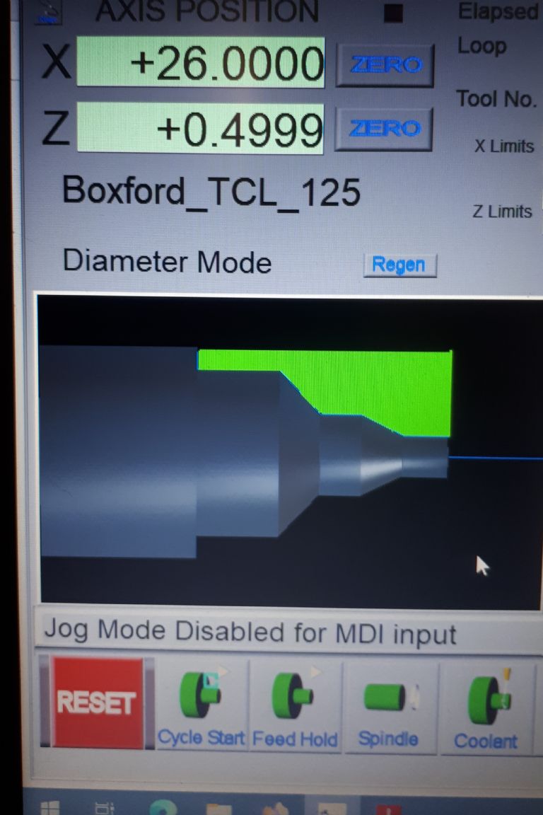

              #527184
              Michael Horner
                @michaelhorner54327
                Hi David
                I would be interested.
                Above was my attempt using macros.
                You enter the change points for the job and away it would go. I broke the lathe motor drive after fitting a new PC and didn't set all the parameters correctly so I don't think I actually got to cut metal with it.
                It now sits at the back of the garage.
                Cheers Michael.
