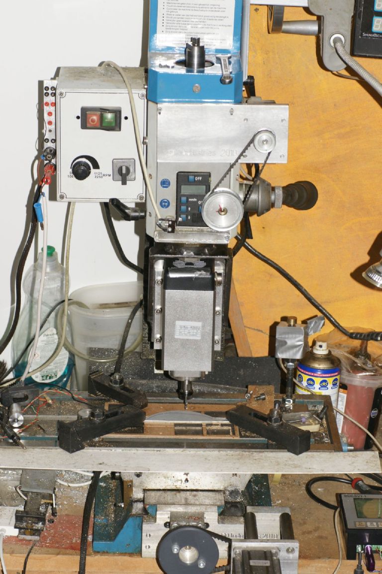

      My extra router spindle gives me up to 24K RPM as my CNC converted mill was limited to 2250 before. Good for 3D scanning! I added counterbalance weights to offset extra weight.

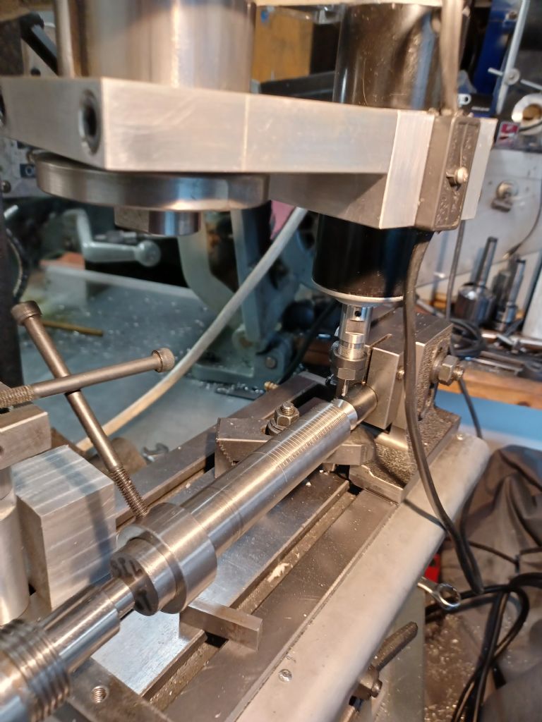

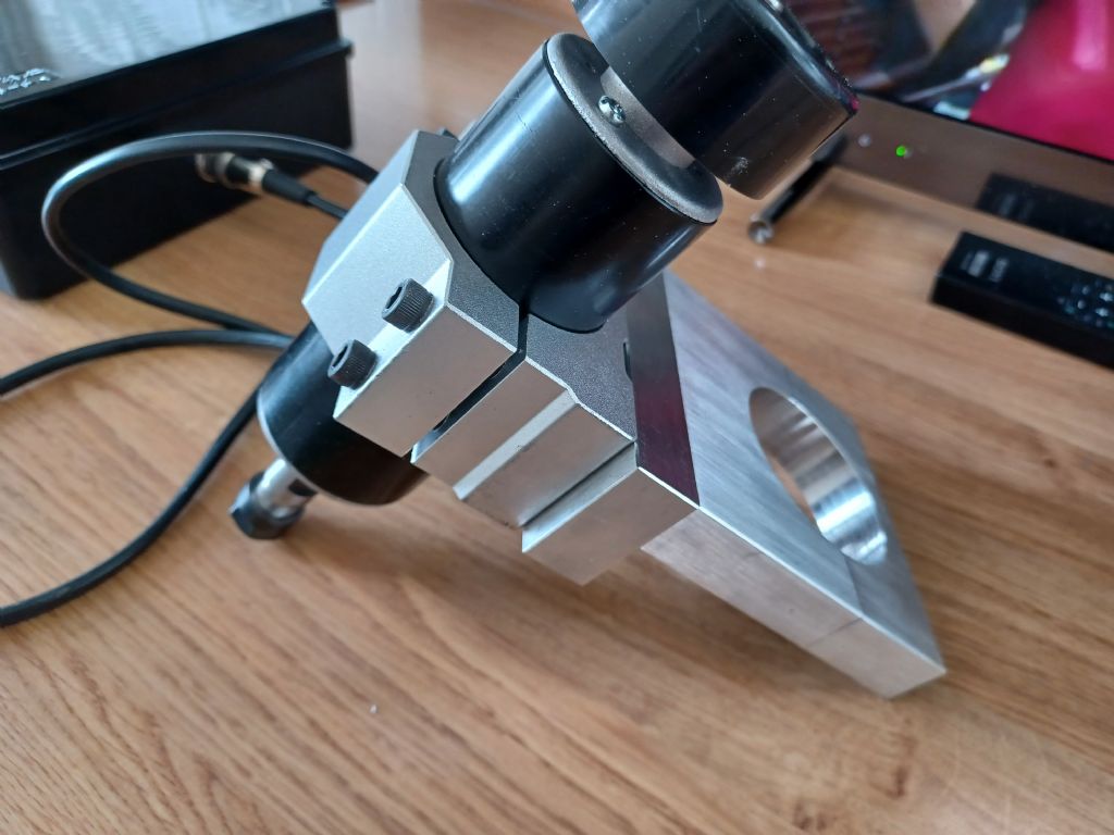

                I ran my spindle to engrave a dial and the spindle was getting very hot so decided to make an engraving spindle mounted to one side of the spindle.

                      What a fine idea (David George 1). I'd been wondering about adding a spindle to the side of my biggish mill, but it won't quite fit.
                      This is a great way to get high speed for the occasional need.

                                        I do as well – I locate the 2nd HSS spindle using the main MT2 bore so that high speed (~12000rpm) and low speed (2450rpm) are co-located in X and Y planes.
                                        Like this (apologies for the enormous amount of clutter!):
