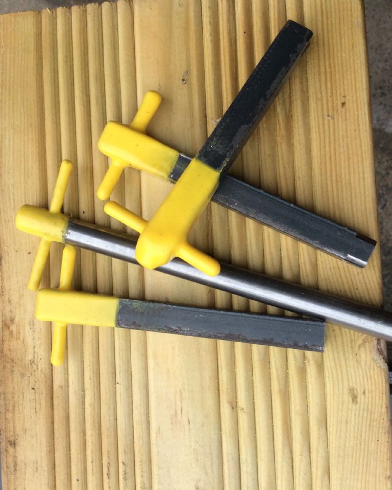

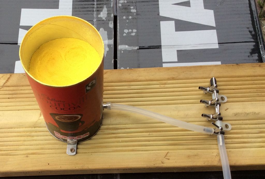

                          img_0257.jpgI set a simple system to powder coat at just the ends of tools so I had a chance of finding them in the grass… only needs a sniff of air. Powder from eBay. Heat with a torch to about blue tempering colour. Bottom has a pad of scotchbright and the (trimmed) top of the cocoa container with a grid of small holes.
