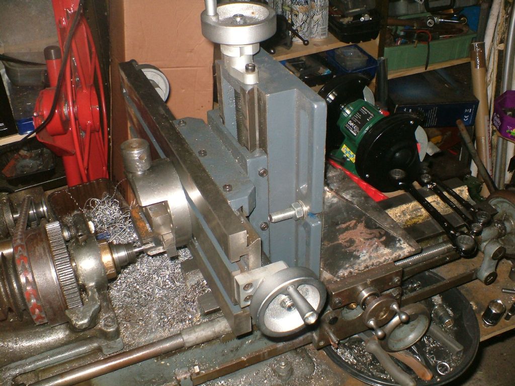

                    I simply repurposed already capable kit, a Drummond M lathe with a good headstock and a 40 kg milling table so the hard work of decent accuracy and stability was already there, I simply bolted them together
                    and it still shakes if you take too big a bite, using only 6mm cutters mainly
                    Only a multi skilled machinist with good resources could make a decent mill from scratch in my opinion, because it needs to be very accurate when it does work, sub 0.5mm across the entire working plane, sub 0.1mm preferred, up/down left/right otherwise it's been a waste of effort
                    The table is moving horizontally over a dovetail?
                    The table is bolted "immovably" to the cross slide but can move up and down the lathe bed with the leadscrew
                    It's actually fabulous for big woodwork jobs because all the mess drops down out of the work zone
