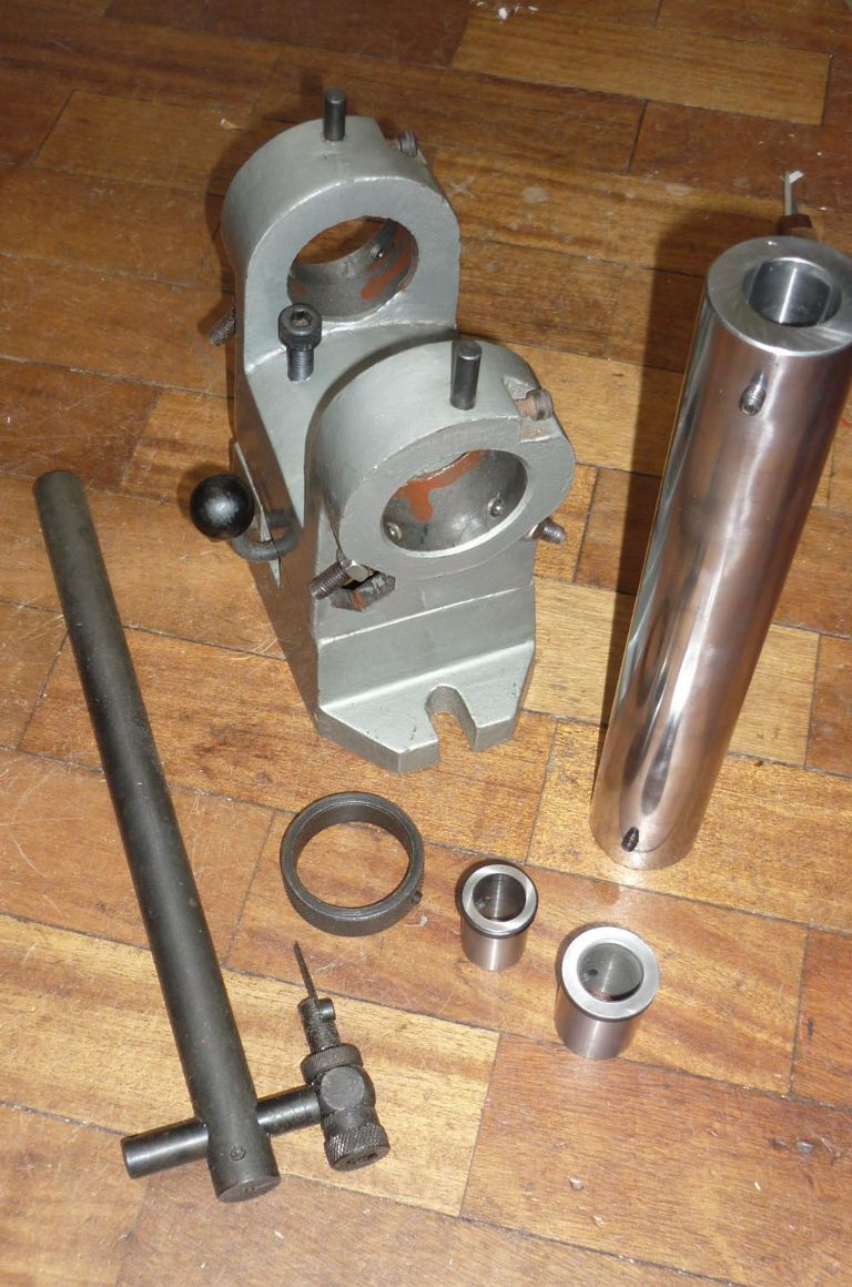

          #267002
          mark smith 20
            @marksmith20
            Well i bought this from GM tools ,i think ill be able to make something usable out of it, if not it may come in for its intended purpose. I think the centre height is just under 6" .
            My bigger mill has a 101/2" wide table but not that long. Thing i like about it is it has a hole built in as well for an arm so i can still do something along the lines of the GHT .
            I think its 5c collets but not sure ,as there was little info and not even sure if its complete . But for 25 quid plus vat /delivery i thought it was worth a punt.
            Any thoughts? Theres one left at G&M if anyones interested.

                                Posted by mark smith 20 on 17/11/2016 16:45:26:
                                Edited By mark smith 20 on 17/11/2016 16:47:39
                                Edited By mark smith 20 on 17/11/2016 16:54:14
                                That looks like just the ticket. Brilliant. It depends on what you want to use it for, but the quickest way to get it useable might be to make into a direct indexing "spin indexer" by bolting a lathe change gear on one end and a chuck on the other. A 60 tooth gear will give you all the common divisions you might need, 2,3, 4, 5, 6, 10, 12, 15 etc just by using a spring loaded plunger on the teeth. Or a 24T will give you most as well, 2,3,4,6,8,12. If you use a 60T you can then add a worm to GHT specs and get full dividing capacity. One thing you will need is a spindle lock, not sure if that is already built into the unit?

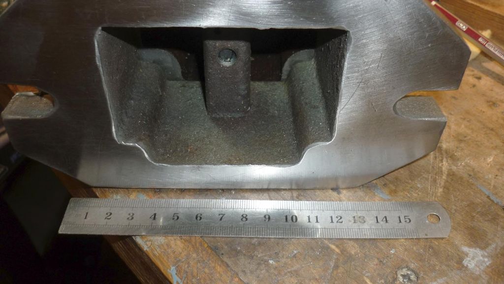

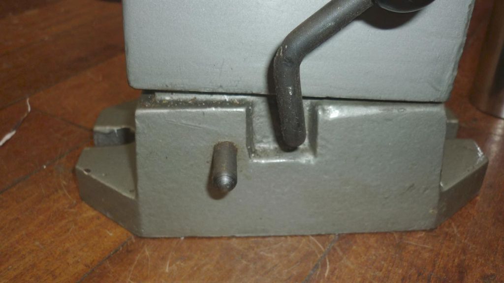

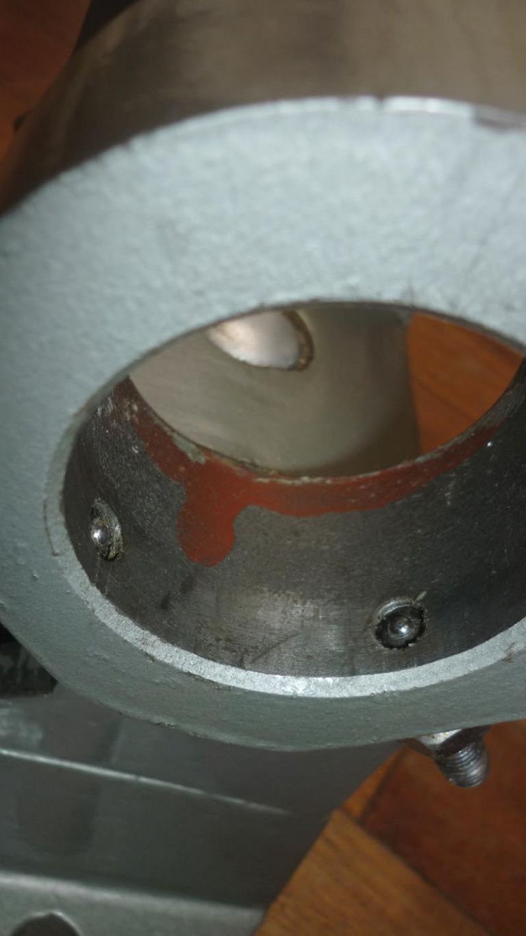

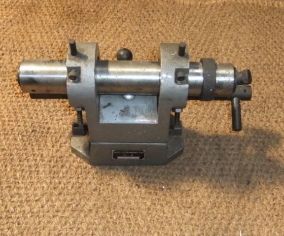

                                    mark smith 20
                                      @marksmith20
                                      Hi I have a question regarding the change gear , can i use a harrison 60T change gear? Im wanting the head to be pretty robust and the harrison gear is alot chunkier than a myford.
                                      Also are these hard to machine as ill need to bore out the hole a bit bigger and possibly face turn to suit as they are 1" thick according to the link. They are 14dp which for a 60t gear is what in diameter terms ???
                                      Such as **LINK**
                                      Also anyone know if Chinese mn65 steel is easy to weld?
                                      Thanks
                                      #267678
                                      Anonymous
                                        Assuming a standard tooth depth spur gear the OD will be tooth count plus 2, all divided by the DP.
                                        Andrew
                                        #267688
                                        mark smith 20
                                          @marksmith20
                                          Thanks Andrew,
                                          so around 4.4286"?
                                          Ive received the above contraption ,i going to have to do some rethinking about how to possibly do something with it.
                                          The spindle (44.5mm diameter) is quite nice but is straight bored not 5c as i thought. It came with two collets in either end  rough 18mm and 22mm.. they fit very nicely .
                                          The all spindle rides in the large casting bore on 3 equally spaced adjustable screws with what looks like round bearing balls on the end.  I think i may have to get rid of these and put a bearing of some sort in either end and then go from there.
                                          The casting top half and lower half do not sit properly and are wobbling all over the place. The lever which i assume is to lock the two parts together seems to be doing nothing and i cant seem to see how to get the two parts seperated.
                                          I was thinking i may have to have the two bits welded together.
                                          There is several sheets of instructions which are spotted all over with mildew so hard to read .

                                          #267696
                                          Hopper
                                            @hopper
                                            MMM, by the time you look at welding the base together, with subsequent distortion issues, and cast iron welding being a bit tricky, and then line bore the holes to install bushings, and is that spindle hardened or suitable to remodel to fit your lathe chuck, it almost might be easier to build Harold Hall's dividing head out of some square pieces of flat plate bolted together.
                                            On the other hand, if you can bolt and dowel the base together and put a super thin pair of bushings in place of those three screws each end, or simply turn up a new spindle with larger OD to run straight in the existing body holes you will be most of the way there with what you already have got.
                                            Not sure about the Harrison gear. One inch thick is a lot more chunky than you need. And 14DP, you will have to calculate the pitch of the Acme thread to match it, and then then change gear compound train to cut it. Also, to get the right helix angle on the worm, it will have to be fairly large diameter.
                                            Whereas, the standard Myford 20DP has been done plenty of times before with all the info readily available. Also the added diameter of the 14DP gear, circa 4 inches vs circa 3 inches for the 20DP, means the worm mechanism will be sticking out that much further from the spindle and body, which means it will be more in the way in use.
                                            Also the wormwheel simply moves the spindle position; it is not used to transmit power so there is no gain in a bigger chunkier gear.
                                            But hard to say without anything in your pics to give scale. Maybe a Harrison gear would be more in proportion to what you have already? Another possibility might be a 14DP gear from a Drummond lathe. They are only 5/8" wide so maybe a bit more suitable? They, like most but not all changegears are cast iron.

                                              #267713
                                                Posted by mark smith 20 on 21/11/2016 11:41:24:
                                                The all spindle rides in the large casting bore on 3 equally spaced adjustable screws with what looks like round bearing balls on the end. …
                                                Mark,
                                                That's an excellent arragement for alignment [often used on optical equipment], but probably not well-suited to your intended purpose.
                                                I would be very interested to see a copy of those instruction sheets, if you could scan them please.
                                                … I will send you my eMail address by PM

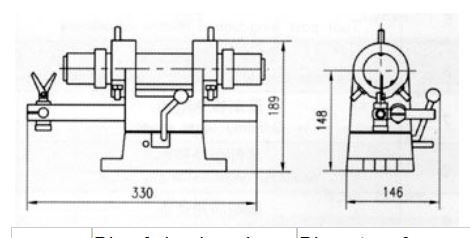

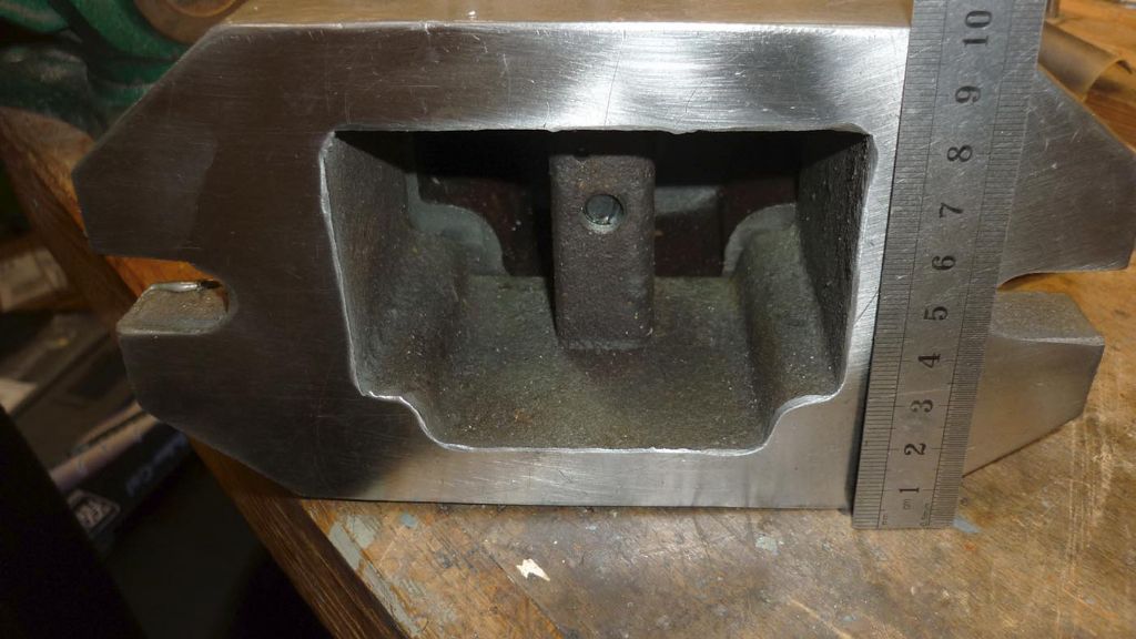

                                                #267725
                                                mark smith 20
                                                  @marksmith20

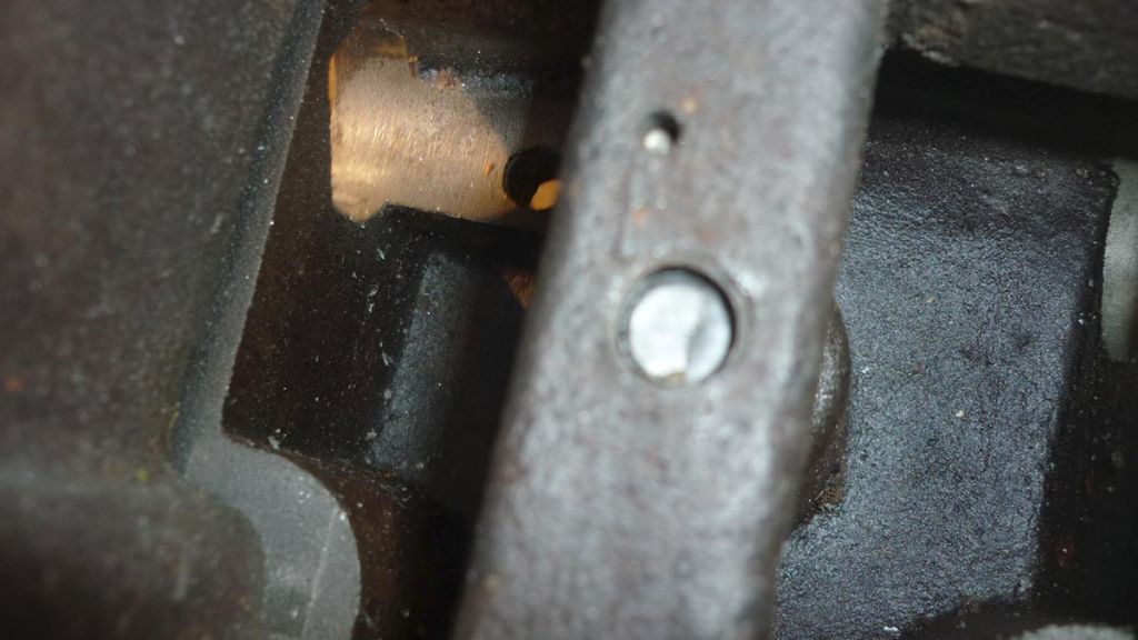

                                                  Heres some more photos of the base ,the thing sits flat on a surface plate,which is something at least .
                                                  The bore through the top is what i think is 2 1/16" and the diameter of the spindle appears to be 1 3/4" ,the straight bushes in each end of the spindle are 7/8" and 3/4" ,so everything is imperial ,probably why google seems to bring up American websites or ebay sales.(i doubt id pay 150$ plus for one of these).
                                                  Cant find any bearings of 2 1/16" outside diameter 1 3/4" internal over here. Maybe just making a couple of bronze plain bushes as bearings would be simplest?? Any thoughts.
                                                  The reason i asked about the bigger diameter change wheel is that i am going to have to bore the centre out to 1 3/4" to go over the spindle i assume.
                                                  From what i have seem from Chinese sites advertising these they are made from Mn65 steel rather than cast iron but im unsure how to distinguish , would that be weldable.(described as a medium carbon toolsteel).
                                                  So the biggest problem i have is securing the two halves of the casting together , if i can get the two parts seperated.blush
                                                  There is a lever on the side the swivels but i dont think is working properly. From what i can tell from the instructions it is only meant to tilt the top half for grinding endmill. Seems a bit strange to me.
                                                  If you look into the base casting there is a larger hole which i assume is threaded for the large bolt that goes right through. Also a small hole next to it with a 1/8" pin which goes right though and rests on the base of the top half. It is free to move in the hole but i can see no way of getting it out with some sort of specially made tool.The only access is a 3/4-1" hole where the other round bar arm goes through the casting.(the bit that holds the adjustable fingers for guiding endmill spirals???
