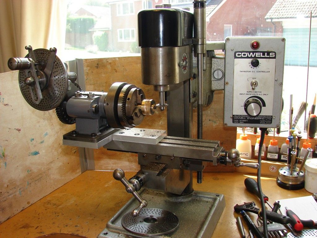

                  I made the Timmins head, drawings and casting available from Blackgates.
                  The plates and fingers for dividing via the worm are borrowed from my George Thomas Headstock Dividing Attachment. What you can't see from the photos is that the bore for the head was machined by lying the casting on its back on the lathe cross slide and boring between centres. The head can therefore be used on the lathe or, more usefully, on the mill as shown, with an increased centre height. You have a choice of using a Myford 60T changewheel and adjusting the angle of the worm shaft to suite or buying a helical wheel (which I did) and having the worm shaft at right angles.

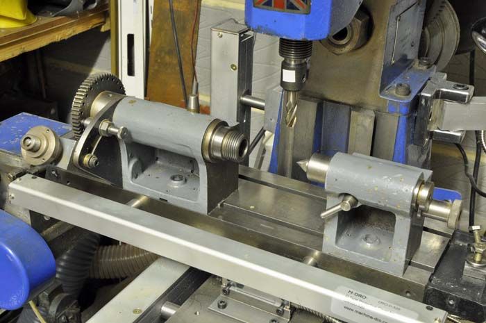

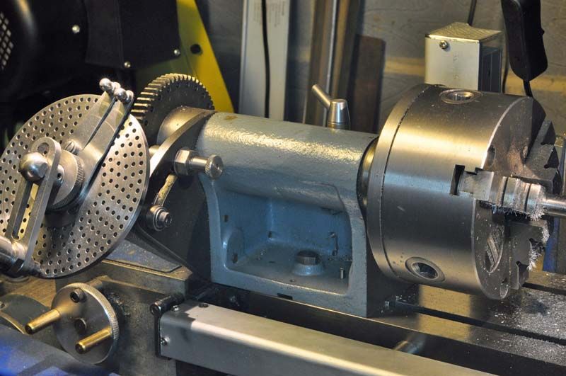

                                      I have made my own dividing heads, one using a purchased MT 2 spindle, but none with a centre height as high as 100mm. I have also made an indexer using a Mini-Lathe spindle, but the centre height is only 85mm. It should be easy though to increase the centre height by 15mm and add a worm and worm wheel to make a proper dividing head.

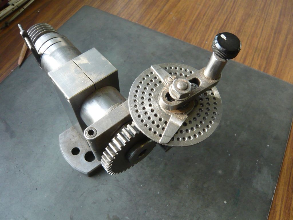

                                          Here is my version. made from mild steel and uses a 40 tooth spur gear ( an old lathe change wheel) Has had much use and works well. Centre height is set to suit my lathe centreline when it is mounted on the cross slide. More photos in my album.
                                          Alan
                                          4 diameter plate

                                              Alan, very nice and simple ,is the spindle just floating in the steel body ?
