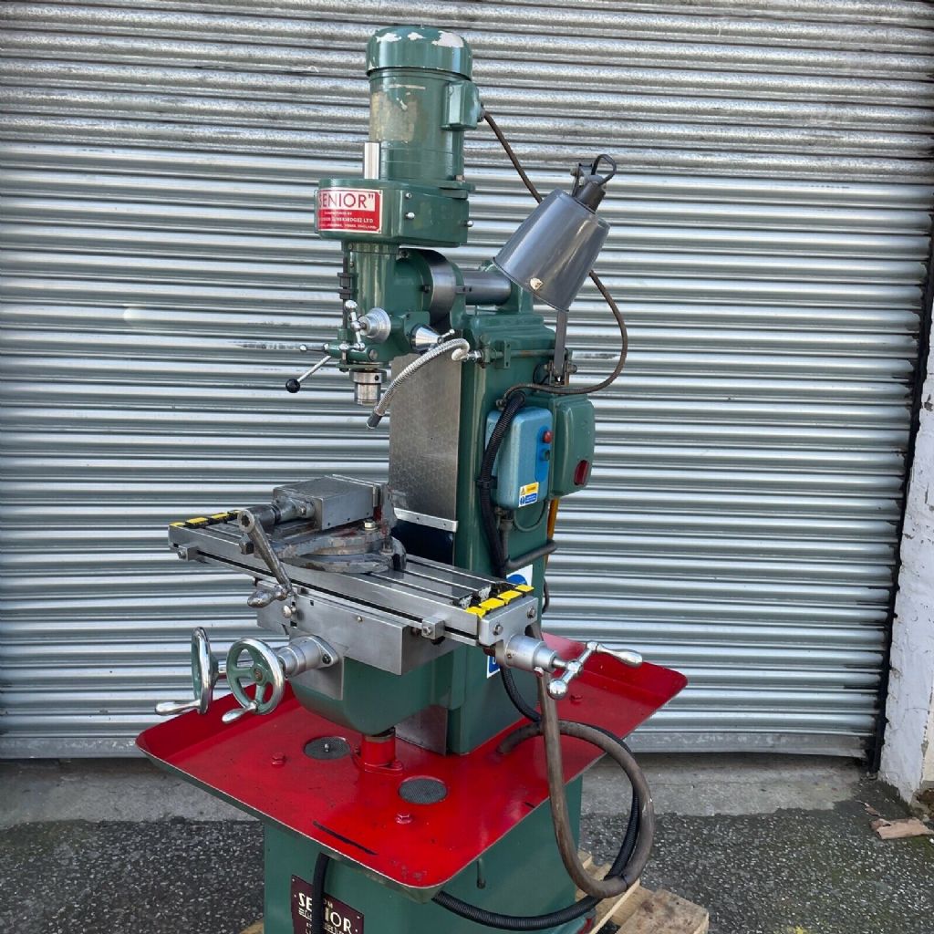

      I have just bought a Tom Senior Mill and was after some dividing head advice for a Light Vertical with S type head: I quite fancy getting a dividing head and a few questions come to mind:
      1. What size? from mounting face to centreline.
      2. Better looking out for a good old English made one or are the Chinese one's ok, if so what make to look at?
      Thanks

        Emgee
          @emgee
          As it seems you have a good height from spindle to table I believe a BS0 Dividing head will suit your machine and provide a good range of divisions and working angles.

            Thanks, appreciated, that is 4" centre

              Simon Williams 3
                @simonwilliams3
                As a Senior citizen (Light Vertical division) myself, and the owner of a BS0 head I can vouch for their compatibility.
                Having said that I have done a number of jobs where I thought a dividing head which could be mounted horizontally or vertically would be a good thing. Then I bought a 6 inch (being the diameter of the rotating platen) rotary table and all was well in the world.
                I also have a 10inch diameter rotary table; this is too big for this little mill as it's too easy to not be able to reach the centre of the table with the limited y axis travel.

                      Emgee
                        @emgee
                        Why recommend a rotary table that can only be used vertically or horizintally when a BSO Dividing Head will do both and any angle from -1 to +90 degrees.
                        Yes you can fit the rotary table to a sine table but that reduces rigidity and increases the overall height.

                        Steviegtr
                          @steviegtr
                          I have the same mill. I bought a 8" indexing rotary table , with the 8" 3 jaw chuck. It was way too big for the mill table. I have since sold that & bought a 6" Vertex style & it's just the right size for the Senior. No indexing plates though. Not something i think i may ever need. Oh what have i said. Never say never.
                          P.S. Nice looking machine you have got there rannsachair. If you are thinking of doing any mods to it, I have a few youtube vids of the many mods done. Tom Senior light vertical

                          Saxalby
                            @saxalby
                            Likewise, have a Senior "Major" mill and can recommend the BSO. Use it quite a lot for cutting spur gears and with the tilt facility on the BS0 have done lots of bevel gears.

                                  David-Clark 1
                                    @david-clark1
                                    A BS0 should be fine.
                                    I had one of there Tom Senior Light Verticals,and they are great.
                                    Mill 5head height is not usually a major problem.
                                    Turn the mill head at 45 degrees and the dividing head at the same angle will increase the capacity considerably.
                                    You can clock up the centre of the dividing head spindle and as long as you only use the y movement of the table you should be able to do very large workpieces. A bit of trigonometry should enable you to mill in the x directin.
                                    i can’t remember the cross slide travel but by positioning the dividing head on the table and the mill head in relation to it, you could probably divide about a 12 inch diameter workpiece.
                                    I fitted a digital readout to my Tom Senior. I can’t remember If,I wrote it up but if not, I probably have the photos.

                                      @david-clark1
                                      Further advice after looking at the main photo.
                                      you might like to remove the vice bottom plate. Increases rigidity when milling.
                                      Also if you have two similar vices side by side, you can hold longer workpieces between them or use one as a stop, hold any odd scrap of metal in one vice as a stop for the second vice.
                                      Also, a ring spanner is very useful as a vice handle but don’t over]tighten it.
                                      For Abwood vices a 19 mm ring is ideal and if you cut the handle of a ring spanner, so it is only 2 inches or so long, you can use it as a spinner to open and close the vice fast.
