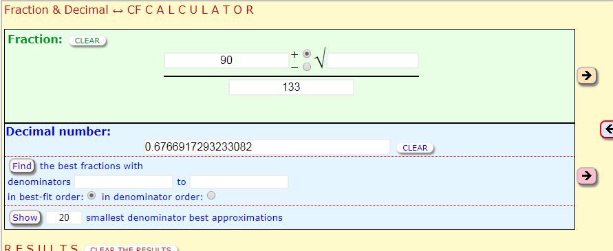

          The calculator is here. Here are some pics of it in action.
          This the ratio above. You need to clear the input, then type the numbers you want in. If there is no square root part leave it blank, it doesn't like zeros. Then you click the right arrow to get the CF.

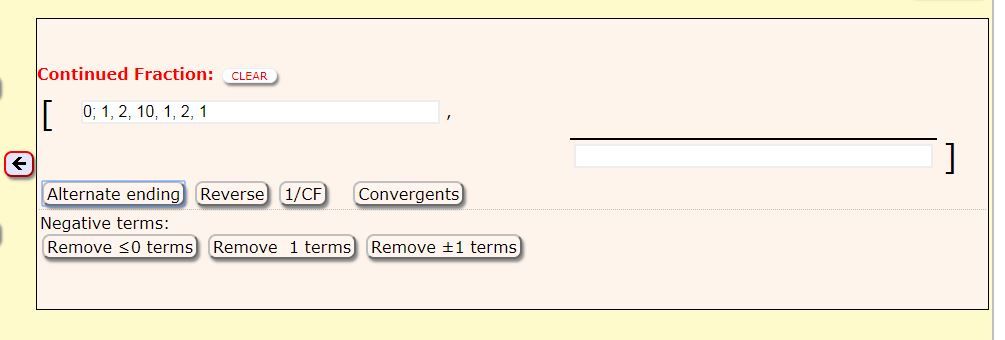

          The CF is just given as a list of numbers – 0; 1,2,10,1,2,1 in this case. You don't need to worry what these mean but if interested it's explained in a long article on an accompanying web page. There are two forms of the fraction which you can get by clicking the "alternate ending" button – the one you want has its last digit as 1 and the longest list. Then click "convergents" to get the approximate ratios you want, given in a third part of the page

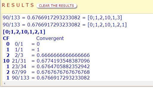

          This shows the list of possible ratios, with the 23/34 and 67/99 appearing.

                    Usually the trick is to find a ratio that corresponds to a set of holes in a plate you already have – so for the 90/133 example the OP had plates with 34 (so 23/34 gives 0.117 degrees error) and 99 (the best, 67/99 gives 0.04 degrees.
                    Accuracy improves as you go down the table as you can see from the results pane. Goes 2/3, 21/31, 23/34, 67/99, then 90/133 which of course is the original ratio.
