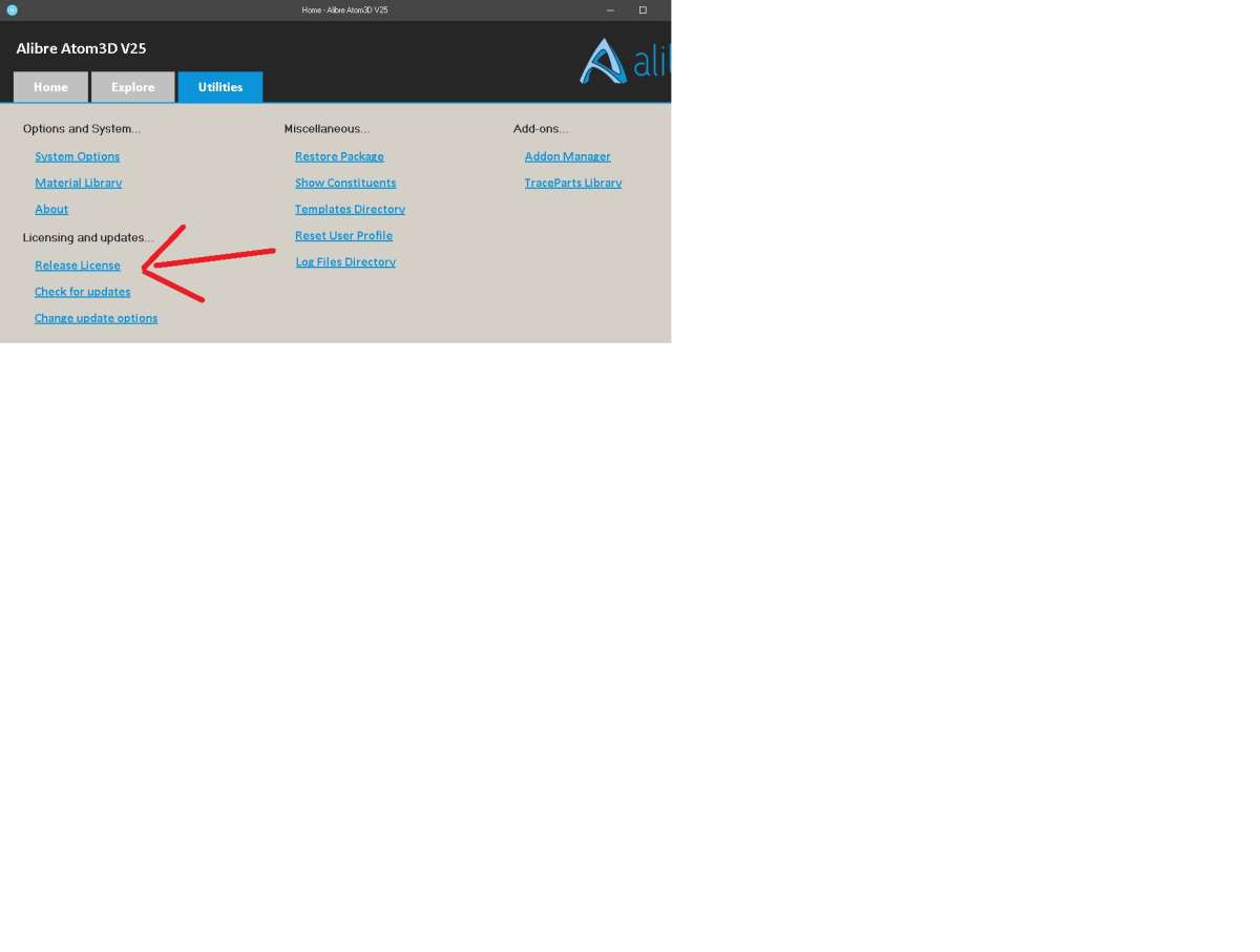

                              If you want to experiment with different computers you can download Alibre to a different computer
                              Make a note of your licence details
                              Then release your licence back to Alibre via the utilities tab
                              release licence
                              Then get your licence back on the new computer
                              Welcome to the club, after the early period of insanity you will have no regrets
