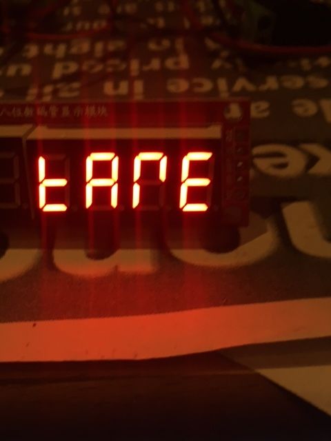

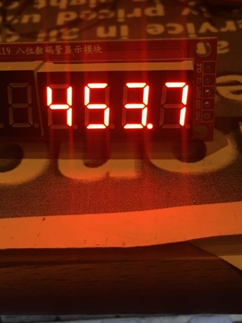

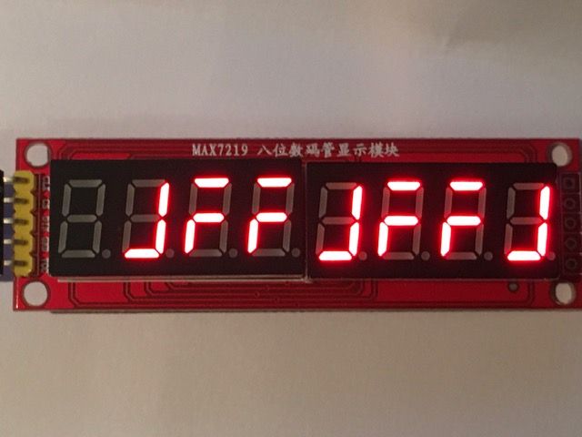

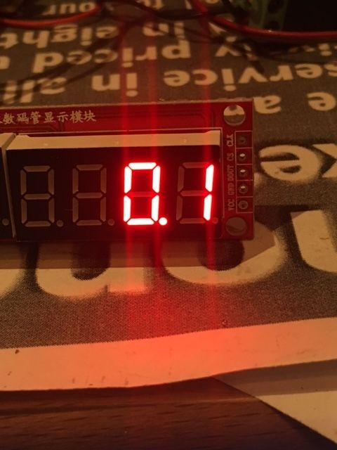

                                      #509451
                                      Peter Bell
                                        @peterbell11509
                                        Thanks for the suggestions.
                                        Tried thems in many combinations including baud rate but didnt make any difference,
                                        When read i instead of weight got the display to do something, see attached reading a 1kg weight , no weight just flashes the decimal places.
                                        Put the lcd back as it doesnt seem to be the culprit.
                                        Tried another display with identical results, perhaps its time to give up and wait for the I2c display and other to arrive!

                                        #509631
                                          So it's trying – the output suggests the display is being controlled via SPI but sent the wrong commands, therefore lighting up the wrong segments.
                                          The Parola library depends on the MD_MAX72XX library, and its .h file explains as there is no standard way of connecting the LCD blocks to the converter chip on the end, so the library supports 4 options. They are:
                                          GENERIC_HW, ///< Use 'generic' style hardware modules commonly available.
                                          FC16_HW, ///< Use FC-16 style hardware module.
                                          PAROLA_HW, ///< Use the Parola style hardware modules.
                                          ICSTATION_HW, ///< Use ICStation style hardware module.
                                          Possibly your module isn't an FC16? Anyway, no harm trying the 3 alternatives to

                                              Had another couple of thoughts.
                                              Maybe you have the correct device, wiring, and HARDWARE_TYPE, but are sending it data it can't cope with. The floating point number generated by:
                                              J=String(i); // Could send too many characters to fit the display, or the decimal point is illegal punctuation.
                                              (Floating point numbers change size depending on the result. By default String does 2 places of decimals eg String(1.0/3) gives "0.33", but watch out for the likes of 1000000.0/3 giving 333333.33. The Parola documentation looks as if punctuation is allowed, so the decimal point should be ok.)
                                              Test by assigning some short constants to J in your code , to see if they work. Eg.
                                              J=String("ABC" ) ; // Note – fits in a 4-cell block
                                              if that works then
                                              J=String("123" )  ;
                                              & if that works
                                              J=String("1.3" ) ;
                                              & if that works
                                              J=String(1.3);
                                              Assuming all that fails, have you tried any of Parola's examples? (See File->Examples menu )

                                              #509831
                                                Just a cotton-picking minute!
                                                Just noticed the board shown in Peter's picture is an 7-segment LED type and the Parola library is for 16×16 dot matrix display. They both use the MAX72xx and SPI, but otherwise aren't compatible
                                                Instead try a MAX7219 library for segment displays, best downloaded and installed from the Arduino's Library Manager. Several choices but max7219 by Jonathan Evans looks easiest.

                                                  Ady1
                                                    @ady1
                                                    I sent the 5v live and ground to the breadboard and connected the modules from there, the 7219 first
                                                    The 7219 is greedy because it's 100s of LEDs
                                                    Does negatives too
                                                    edit: must confess that the outputs look weird to me, 100.5 is 10.05 kgs perhaps… hmmm
                                                    Just noticed sods post… oops
                                                    well if you get the led one it works ok… ish
                                                    my brain has exploded so I'll look at calibration testing later

                                                    Peter Bell
                                                      @peterbell11509
                                                      May thanks for all the help and suggestions.
                                                      Tried them without success, however after reading the other thread on Arduino displays and following the suggestion from SOD I felt inspired enough to start looking up what I had on the 7219 which gave limited success due to my lack of knowledge before being abandoned 2 years ago.
                                                      This time around from what I have learned I managed to work out what I was doing wrong and ended up with a working 7219 display on my weighing scale. This is my code below.
                                                      The Adafruit display worked immediatly and its nice and large and bright so good suggestion.
                                                      Next challenge is to explore storing and then retrieving a float value, can anyone reccomend an easy way or good tutorial etc?
                                                      I keep hearing about wearing out eproms, is it best to store things like that on an SD card?
                                                      Peter

                                                      float i = LoadCell.getData();
                                                      Serial.println(i,1);
                                                      HCMAX7219.Clear(); /* Clear the output buffer */
                                                      HCMAX7219.print7Seg(i,1,4,4); /* Write some text to the output buffer */
                                                      HCMAX7219.Refresh(); /* Send the output buffer to the display */
                                                      if ((digitalRead(Reset) == LOW)) { //Tare
                                                      HCMAX7219.Clear();
                                                      HCMAX7219.print7Seg("TARE",4);
                                                      LoadCell.tare();
                                                      delay(500);
                                                      //delay (1000);
