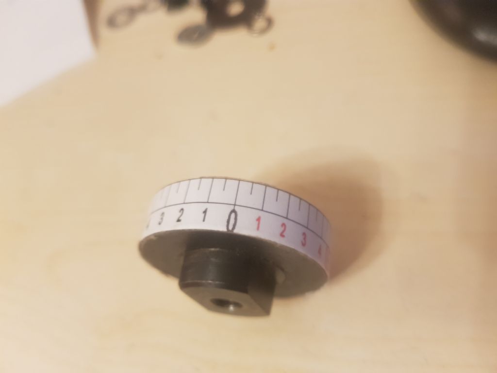

      metric fudge dial.jpg20210704_153147.jpgHaving seen the cost of metrifying a combo slide £190 for the kit. I thought of a quick cheat which comprised making a suitably scaled label on cad and sticking around the rim of the micrometer head.
      now Im sure this must have been done before, so apologies if this is old news.

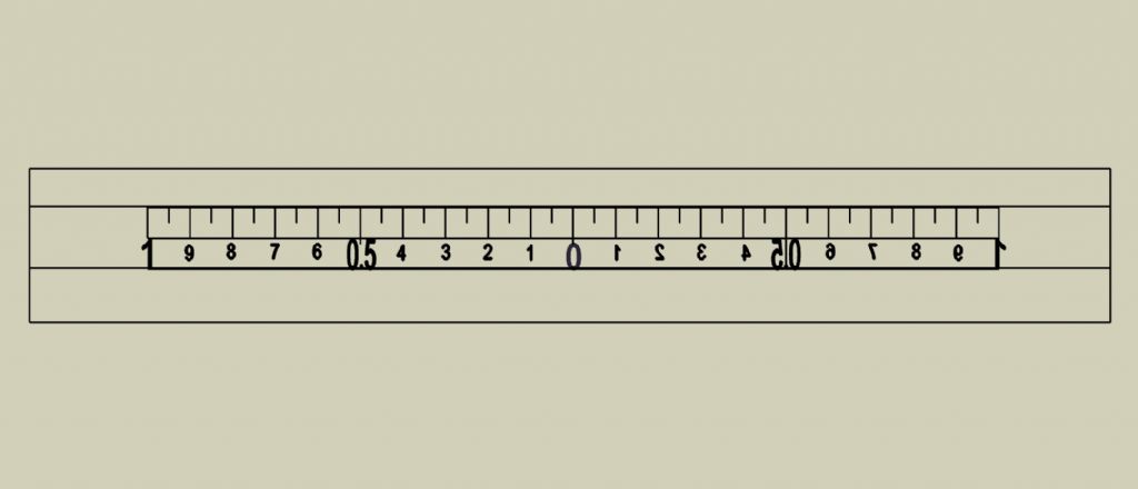

      You measure your rim – 36.7mm and make a label divided into 25/25.4 x 36.7
      I made my divs 0-1.25, with the black scale counting up towards the work and also counting up red scale away from the work
      I made the dial resettable as well – another story
      The reason is that combo slide micrometers are normally used for close finishing cuts. So reset the dial to zero and proceed as desired

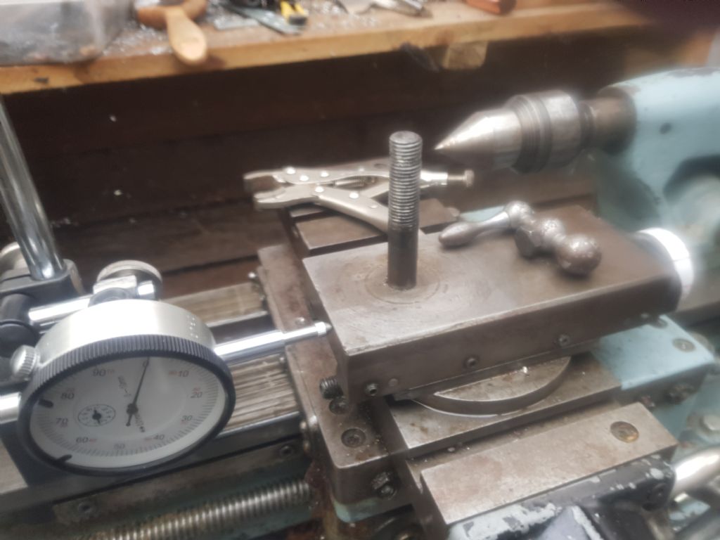

      I checked the dial for 1mm against a dial gauge and it was spot on
      Of course ther is a small gap between start and finish of the scale but its liveable, its not an absolute dial, its relative
      I also thought I might make the cross slide with 2x unit scale so that it read diameters instead of radii so 1mm in becomes a 2mm diameter reduction
      Is that confusing?
      apologies for the scale pic is was a trial, I will get a better pic but you get the gist
