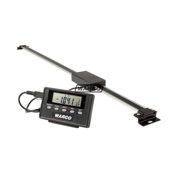

      I don't want or need to go full DRO on my lathe, but I do want to be able to drill holes with a cross-drilling fixture in the cross-slide into a workpiece held in the lathe. These things seem ideal for the job and should be more than accurate enough:
      Warco, whose picture above I have, ahem, borrowed, are sold out of the 1000mm length ones and I can't find one anywhere else at close to the price. eBay doesn't seem to have such a thing under £130, and Aliexpress has something a good bit cheaper but with extraordinary shipping costs. Can anyone suggest cheaper options?
      (I know I probably don't need a 1000mm slide on a ~1m bed, but it will look tidier and give me more options for mounting, and, well, easier to make a long thing shorter than a short thing long)

          How about MDRO

              Lots of previous posts about readouts.
              They work OK BUT do not last. I had to replace the ones on my mill 3 times after they failed. Now have a decent set of scales made by Easson.

                I use these scales (from igaging) on my mill for several years now and they are OK. However, these scales are not swarf or water proof. So I made a "protective" cover to protect against swarf (I don't use coolant on the mill)

                    Arcurotrade sell these. I have 3 of them on my Warco mill. (As per the link from DC31k earlier).
                    I found the display a bit small so built an adapter to use the TouchDRO app on a cheap Android tablet for the display.

                      Any thoughts whether something like this could serve as an alternative to your solution?

                        Need good protection to minimise swarf ingress, depending on lathe it may be very close to cutting point. I had one on my mill, lasted about twelve months then readout was all over the place even though well covered.
