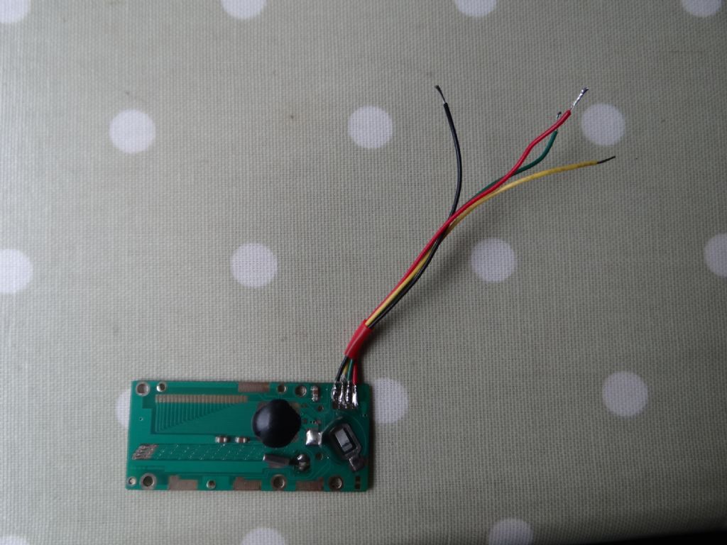

      I soldered my wires in place. The standard caliper connectors are a joke…

                Thanks Banders who agrees with Neil that the connector is not a good idea, I soldered mine which is a pita as the case needs taking off otherwise the plastic case will suffer…perhaps Dave will find a better solution.
                Also thanks Les… I didn't know the label hides the screw…and the hack for getting a remote display from the Wixey is what I want….can't understand how I missed that… I think I will be using a rotary encoder for the azimuth display..

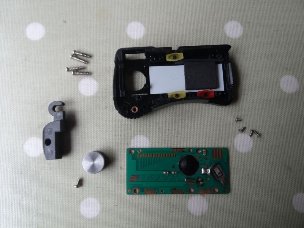

                        I took the Yuriy's Toys approach for the DRO on my Mini Mill that uses Igaging scales but built my own circuit board based on an atTiny85 and some USB connectors (total cost less than £5.00). This runs Yuriy's firmware with a couple of minor tweaks for the atTiny chip.
                        This interfaces via Bluetooth to a cheap 10" Android tablet, but any Andriod device would work just as well.
                        The Igaging scales use mini USB cables, but use +3v, Clk, Data, Gnd on the pins
                        Edited By Zebethyal on 08/08/2017 11:05:24

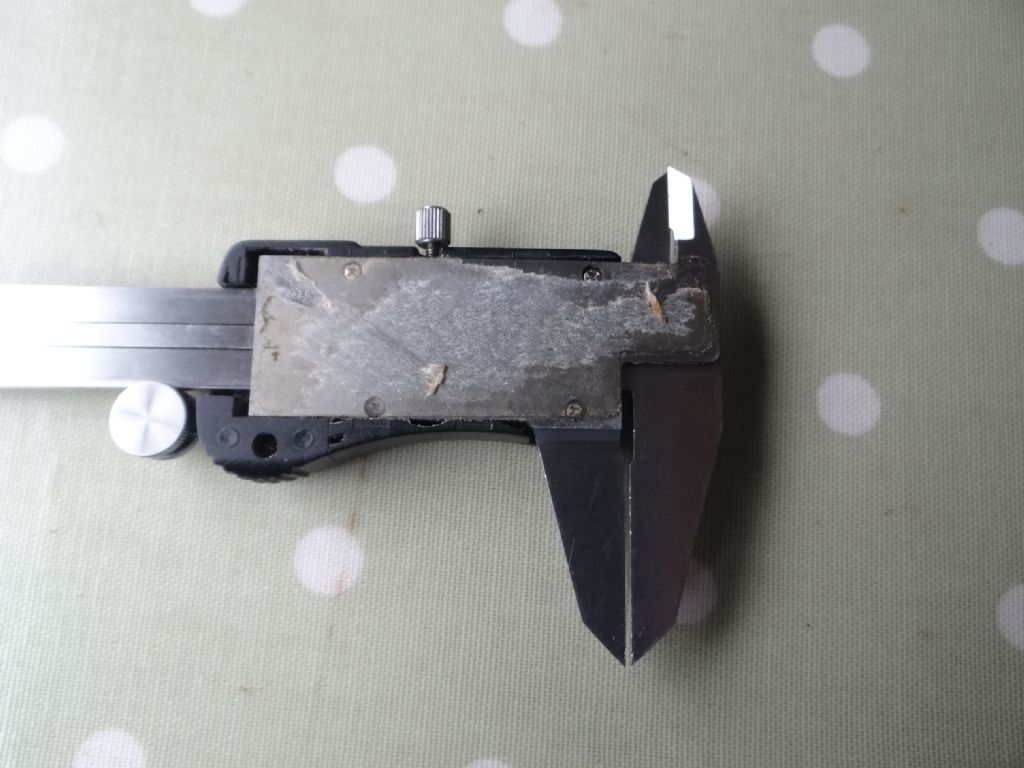

                            Good news, my old Powerfix Caliper came apart easily after exposing the screws behind the sticky label on the back.
                            Even better, a signal appeared on the 4 pin interface after I cleaned out the swarf so I shakily soldered on some wires. (I was surprised how much muck was inside the case.)

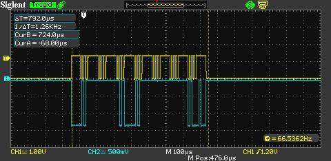

                            Reassembled I detected this output on the clock and data pins. The yellow trace is the clock, and the blue is the data. As expected I found the caliper never switches off. The ON/OFF button disables the display but everything else carries on working.
                            After this promising start the project's gone pear-shaped. The NPN transistor level shifter quickly drains the caliper's battery. I've been unable to decode the data with any of the Arduino sketches available on the web. I can't see any difference between positive and negative numbers on the oscilloscope trace. This might indicate this caliper has an unusual variation on the usual protocol. Or that I'm a bit thick.

                              The waveform looks like 7 BCD protocol but the data is inverted. I can't remember if any versions of Yuriy's code support this protocol. This is a link to a website that shows the 7 BCD code. I have a powerfix caliper (From Lidle) but the one I have looks like 2 x 24 bit protocol.
                              This is some notes I made on the 7 BCD protocol on a set of calipers bought from Neto many years ago.
                              7 BCD Scales
                              LSB Sent first.
                              Static state of clock line between frames Low
                              Time between start of frames 330 mS
                              Length of data frame 820 uS
                              Interrecord gap 329 mS
                              Time between stat of nibbles within frame 110 uS
                              Length of clock cycle about 12 uS
                              Time clock pulse is negative about 6 uS
                              Time clock pulse is positive about 6 uS
                              High level at start of frame about 55 uS
                              High level between nibbles about 60 uS
                              High level at end of frame about 60 uS
                              Clock in the data on the negative going edge.
                              Top nibble
                              Bit 0: sign. L = +, H = –
                              Bit 1: in inch-mode H means +0,0005 inch, unused in mm-mode.
                              Bit 2: unit: mm/inch. H= mm; L= inch
                              Bit 3: unknown.
                              28 bits in a frame of data
                              CPI 2540 (Metric)
                              My interface design using an ATtiny4313 worked with this 7 BCD caliper. Let me know if you would like a copy of the source code (Written in assembler.) It may give you some ideas to write a version in "C" to run on the arduino.
                              Les.

                                Les is right…the trace definitely looks like a BCD format see .. http://robotroom.com/Caliper-Digital-Data-Port-3.html
                                which means you will be able to use my code..as posted.
                                I also didn't use the battery in the calipers rather using the +5v from the Arduino for the level shifter… and potting down the 3v3 from the Arduino for the caliper 1.5v supply using two 6k2 resistors.

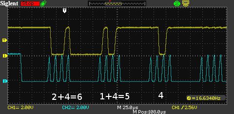

                                  I can confirm that this caliper is using BCD. This screenshot is of 4.56mm and you can see the first three nibbles are 6, 5 and 4. Hurrah!
                                  At the moment I'm using a slightly modified version of Bob's sketch. The main differences are: I've commented out the I2C LCD stuff and am using the Serial Monitor instead; I've also inverted the start logic in ReadX()
                                  The start logic change is because my caliper appears to be upside down. After making the change I started receiving numbers and was able to confirm that the delay between each transmission is correctly detected by the Arduino.
                                  Trouble is that the decoded numbers jump about and don't have any relationship to the input. I'd be much happier if the output numbers were stable even if wrong. As it is, looks like the Arduino and/or Sketch aren't detecting bits properly.
                                  It may be noise on the caliper's "power supply". I'm running a LED off the 3.3V line and tapping 1.5V off that smoothed with 6.8uF. I don't think the erratic numbers are due to logic inversion or Bob's code, but might be. My main suspect at the moment is the level shifter: the clock signals in particular are suspiciously round-shouldered!
                                  Many thanks for the advice. I have a way to go yet!
