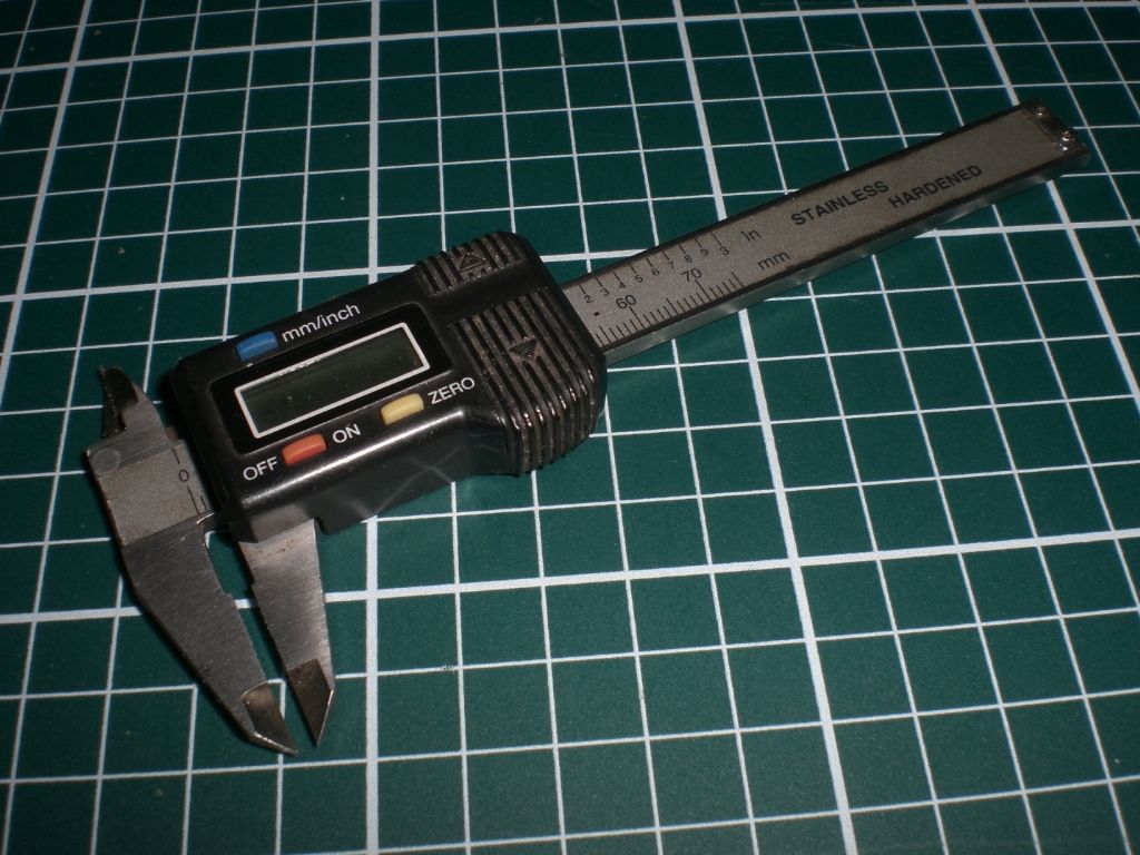

                          Hi, well I bought this 3" one so long ago I can't remember when, but it was one of the well known suppliers at one of the Model Engineering exhibitions. It started plying up maybe a year or so ago but was handy for a quick check without the digital display, but a couple of weeks ago, I took the whole thing apart and cleaned everything including that stripe between the display and the printed circuit board and it now works just as good as it used to, no idea who made it, but it is as good as a Starrett one that I have, I think it cost about £6.00 at the time which would be about a tenner for a cheap one now. Very often comes in handy in a small space.
                          Regards Nick.

                            I didn't realise you can get ones that short! That could be handy for getting in awkward places…
                            Iain

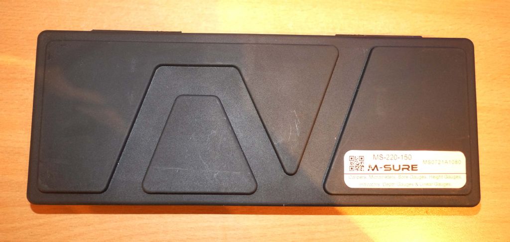

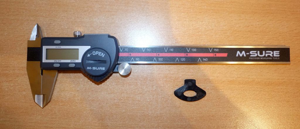

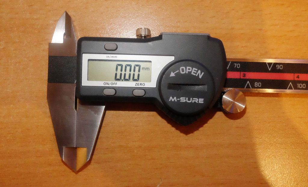

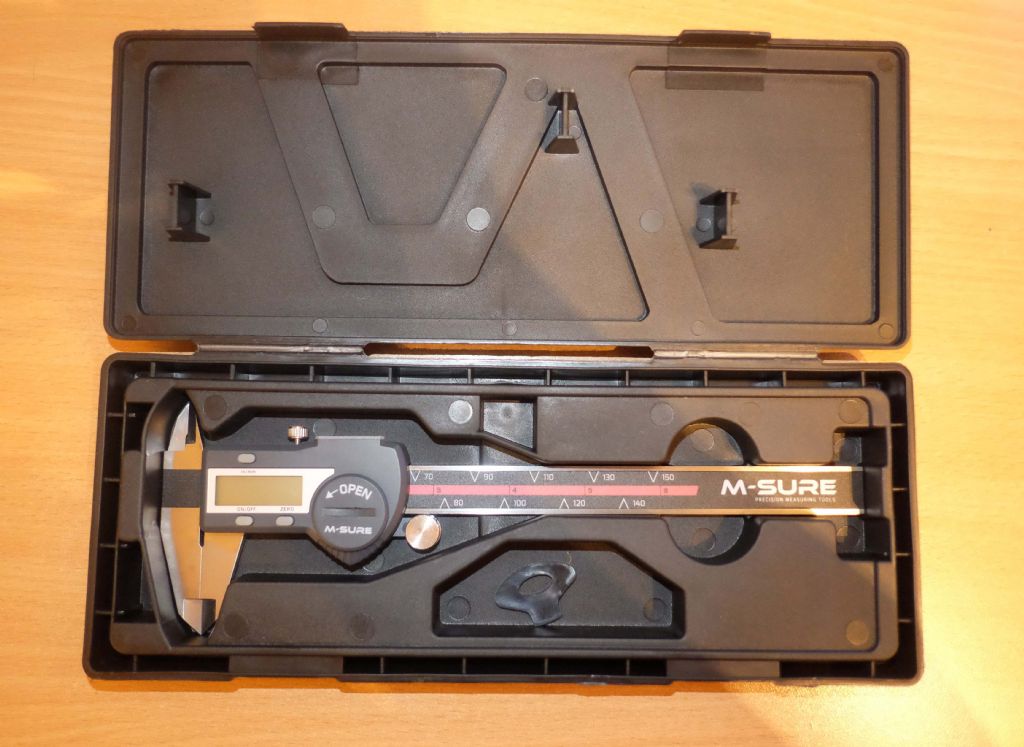

                                Since I started this thread I thought I would give some feedback on the Caliper I bought, the M-SURE from Amazon
                                Not sure whats happened to Amazon but currently their delivery time is quick. I ordered the caliper on Friday, selected std free delivery and recd it yesterday.
                                So, as I mentioned earlier in the thread I went for the M-SURE as it had recd good reviews on the Mig Welding Forum.
                                The case is very sturdy and well moulded, very similar to the case you get with the Mitutoyo calipers. It comes with one CR2032 Lithium battery which you have to fit and a small tool to get the battery cover off. The cover for the battery has a seal. There is also a data port as well, not tested.
                                Its auto on when you slide the caliper and auto off however it takes a long time to go off which is good. When off, I press the zero button and then switched it on and it was still at the same measurement so think its actually off and not just a display off so battery life may be good but obviously time will tell. It does advice to remove the battery if the caliper is not going to used for a long period of time. The slide action is smooth, the display is smaller than I would like, the one I got the other day was brill but of course the item faulty
                                On the paperwork there is a web address, m-sure.co.uk which taked you to a landing page and then to Machine Dro.  Its also looks like they do other models, mine is the MS-220-15- but they also do a MS-222 but the longer one here

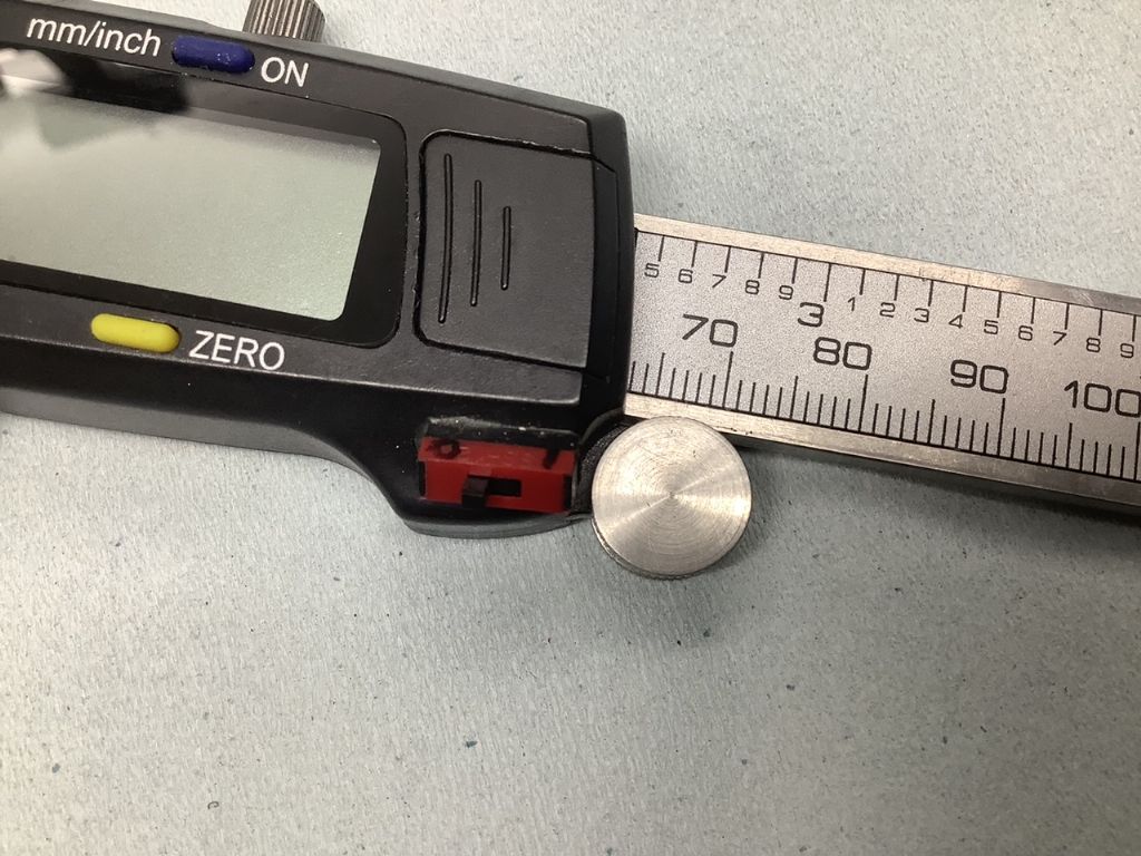

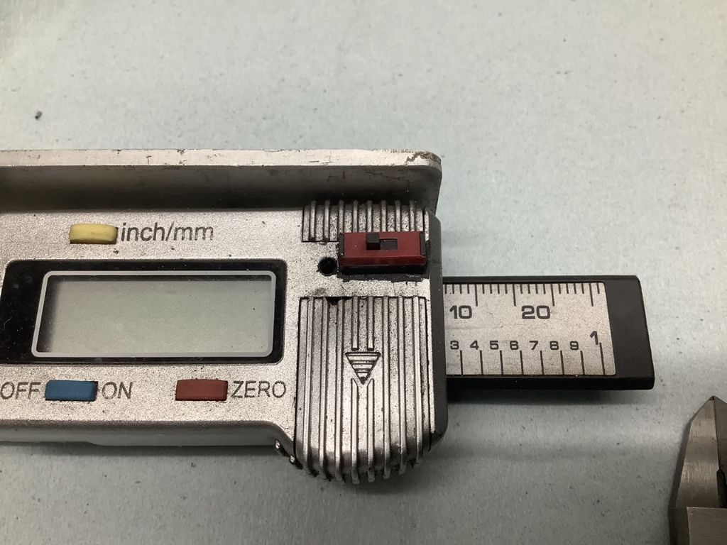

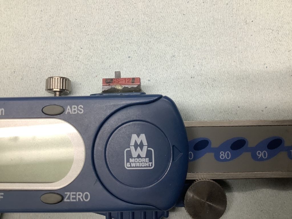

                                    2067ec3d-205a-4e9e-8976-f341bb6e439f.jpegc9080f63-689d-4b62-acd3-98e2bd377b29.jpeg368c62fd-3ff2-4449-8674-1defa71eae92.jpegOn-Off switchesFor some time now I have had pretty good service from budget digital calipers – except for their short battery life due to the 'soft' on-off switch which is never really off, so the caliper is always drawing a very small current.
                                    This became so annoying, especially in cold weather when batteries were regularly failing, that I fitted 'proper' on-off switches – as shown.
                                    These involve dismantling the calipers and intercepting the wiring or pcb track to one of the poles of the button cell and connecting it via the switch, which is held onto the body by Araldite epoxy glue, it helps to have a steady hand and magnifier.
                                    The switches are RS 125-1860 'Slide switch, SPDT' and are made in Japan. So far, they have survived regular use and the batteries now last for years instead of months.
                                    Despite the foregoing, my daily 'go to' measuring instruments are analogue dial calipers by Mitutoyo for metric and M & W for imperial. They are just so convenient to pick up and use.
                                    Out of interest, I once checked the accuracy of my calipers against micrometer setting gauges and they were all within a thou' or two over 5" or 125mm. So the cheap ones, from the likes of Aldi, Lidl, etc. can be useful for home workshops where great precision is unwarranted.

                                        Hi Iain, I think there was only one trader selling this size and being that I was just about spent out and this was the cheapest one, I bought it as all the others were 4" and a significantly dearer. It was at the time when they were becoming a must have tool and a number of the traders wouldn't take credit cards for small value purchases.
                                        Regards Nick.

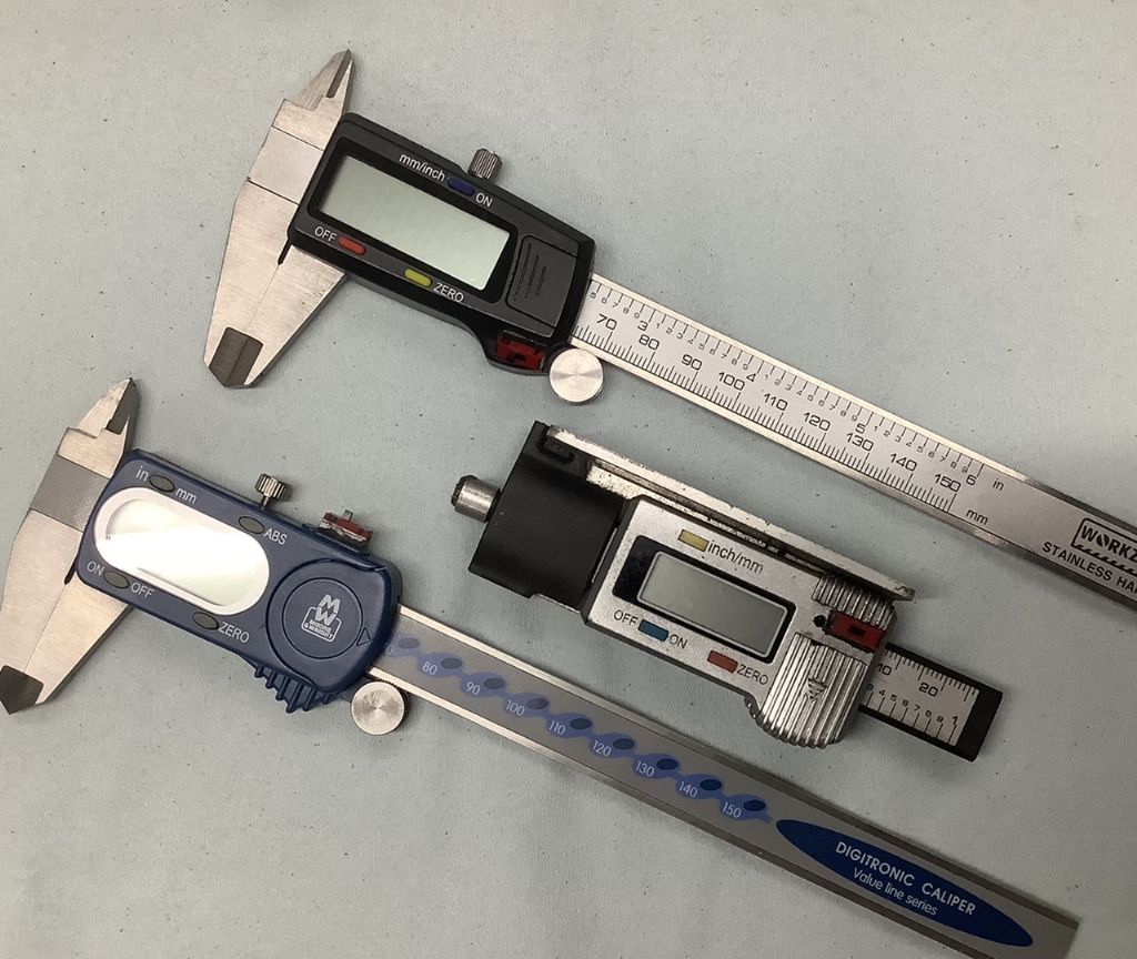

                                          It sounds a bit trivial but its actually quite annoying; the M&W calipers I have don't have auto-wake, so I have to turn them on every time. I know that sounds pathetic but it makes it annoying enough that I tend to use my cheaper ones more often than not. Maybe that means they will have a better battery life but so far that hasn't proven to be the case.

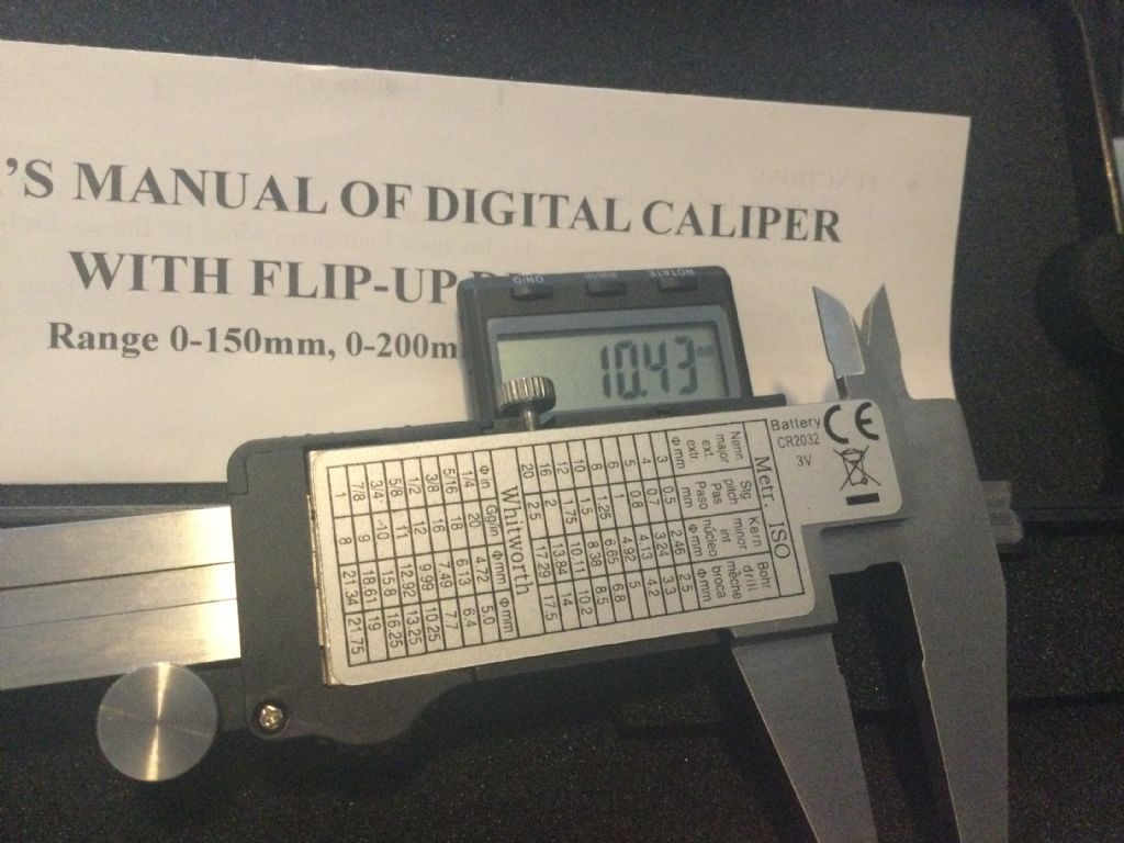

                                            Santa brought me one of these, very handy for the lathe

                                              Posted by Ian Mellors on 02/01/2022 15:29:29:
                                              But that is the only time the flip up display feature brings any benefit to an otherwise very ordinary digital caliper.
                                              I purchased the identical item a few months ago and have never actually made use of it so its languishing in its box. Yes it can be used left handed in the lathe, but it then needs both hands if a button has to be pressed.

                                                    Posted by Ian P on 02/01/2022 20:26:17:
                                                    Ian P
                                                    I’ve got to agree that the display flip switch should be built into the hinge so it’s automatic. Hey ho.
