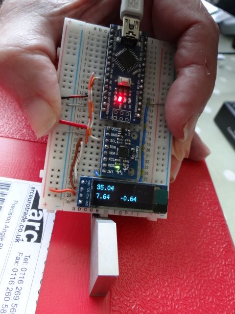

                                              Here's what an MCU6050 accelerometer/gyro chip and an Arduino can do:
                                              It's measuring X,Y and Z ie roll, yaw and pitch. The top number is pitch, with the breadboard tilted on one of Ketan's Famous 35° Precision Angle Blocks.
                                              Not bad but all the angles are relative to my Polish Communist era dining table which is hardly trustworthy. As is balancing the gauge on a bendy plastic box. That 0.04°reading could be pure luck.
                                              John Haine mentioned readings from these devices would jitter and float around a bit. He's right: after 20 minutes rest yaw drifted -33.43°, and Pitch -0.5°
                                              These chips perform best when moved about continually because the accelerometer and gyro readings can then be used to cross correct: even better if there are magnetometer readings to help as well. So probably more useful as a stabiliser than a precision workshop tool. One feature I've not used. The chip is able to detect when it's in free-fall, which might be handy for some form of emergency stop. Fitted to a dropped hammer, it could deploy a parachute and save toes…

                                                  what's the doody little display?

                                                    It's a small OLED like this one. Two for £8.99. Bigger sizes available.
                                                    Not quite as easy to use as an LCD, though perhaps I should have Read The Flipping Manual! Nnot limited to text because it's a 132×32 graphical display.
