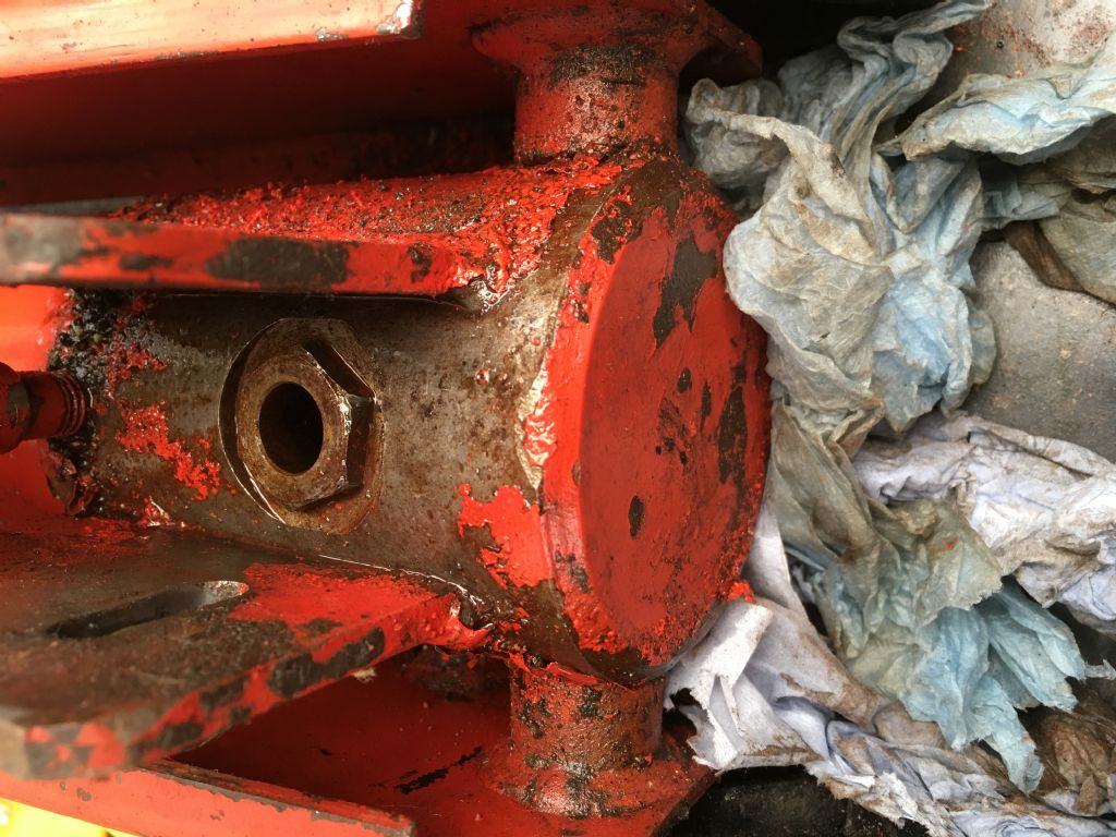

      40+ year old trolley jack
      #373506
      OuBallie
        @ouballie
        Time to replace the ram 'O' ring as it's become incontinent.
        The ram guide wont budge using normal ratchet and 3/4" socket.
        The flats are only 1/8" thick so am very reluctant to go at it like a bull in a china shop.
        Have applied both freeze spray and penetrant but need advise please on best way to I loosen it.

        Muzzer
          @muzzer
          I wouldn't bugger about – a chisel would fit in there very nicely. If that doesn't get it moving, nothing will. You can tidy up the damage afterwards and reuse it but surely won't need to do it again for many a year / ever. Looks as if you've had your money's worth out of it already!

          Jeff Dayman
            @jeffdayman43397
            As a last resort if other measures fail, you could weld a rod to the nut in a couple places, having cross drilled the rod for a tommy bar first, or having welded a second cross rod handle onto the first rod, above the linkage. The rod should be a close fit to the nut hole. If welding, do it well outdoors and with an extinguisher nearby – the oil in the area may flare up under weld heat.
            This method would likely permit re-use of the hex fitting by grinding off the welds and poking out the remaining bit of rod in the hole.
            If you used the welding approach first, you could spare the hex fitting the indignity of severe rattle wrench rash or chisel torture. The welding heat often helps free stuck threads as well.
            The weld method is often a lot faster than rattle wrenches or chiseling on stuck old fastenings.

              Indeed Murray, can't complain as I've been using it since the mid 60s, and it did stirling work when preparing and racing my 105E and now working on the '35 Seven.
              Jeff, will see what metal I can use, maybe a bit of hex, if the chisel fails.
              Will apply heat in the morning, but no naked flame, just a powerful heat gun and see if that loosens things up.

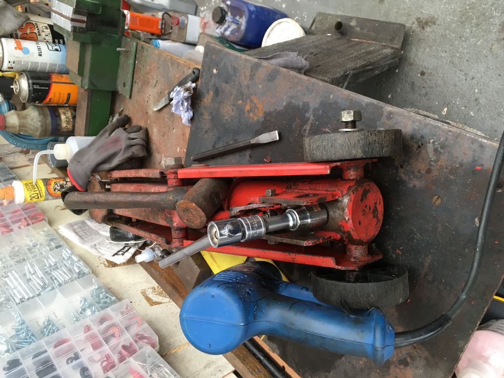

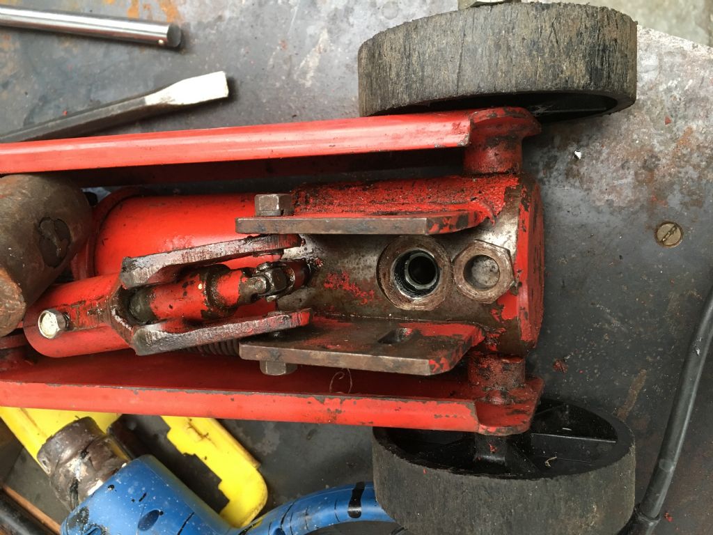

                          Well, it came loose after applying heat then having a go using a chisel, but without it budging.
                          Placed a lump of steel on top of it and gave it a wallop with the persuader, then another go with socket and using the persuader once again and bingo it came loose.
                          The 'O' ring is 5/8" Ø that I do not have, mine being metric, so ordered one.
                          I did try various metric ones but they did not seal of course.

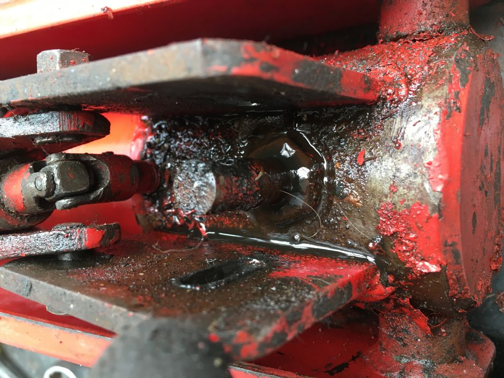

                              Update.
                              Had to use two 'O' rings to stop the leakage, as one didn't.
                              The guide screwed right down squishing the rings against the ram.
                              Will only find out once I use the jack in anger and real pressure applied.
