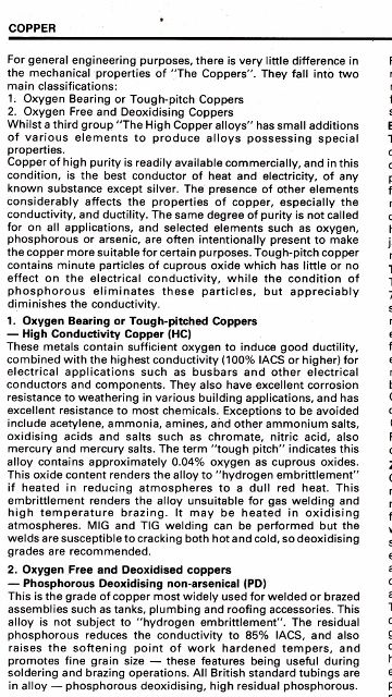

                                      #146395
                                      Ian S C
                                        @iansc
                                        Got some specs here, hope it's readable. Ian S Cimgcopper info (360x640).jpg

                                                    #146622
                                                    Ian S C
                                                      @iansc
                                                      If you look at my last posting, read para 2, I think C106 comes in this type of copper, and this is what is required, unless you are going to soft solder the boiler, heating domestic copper to brazing heat does not seem to be too good for it, Plumbers braze it! Ian S C
