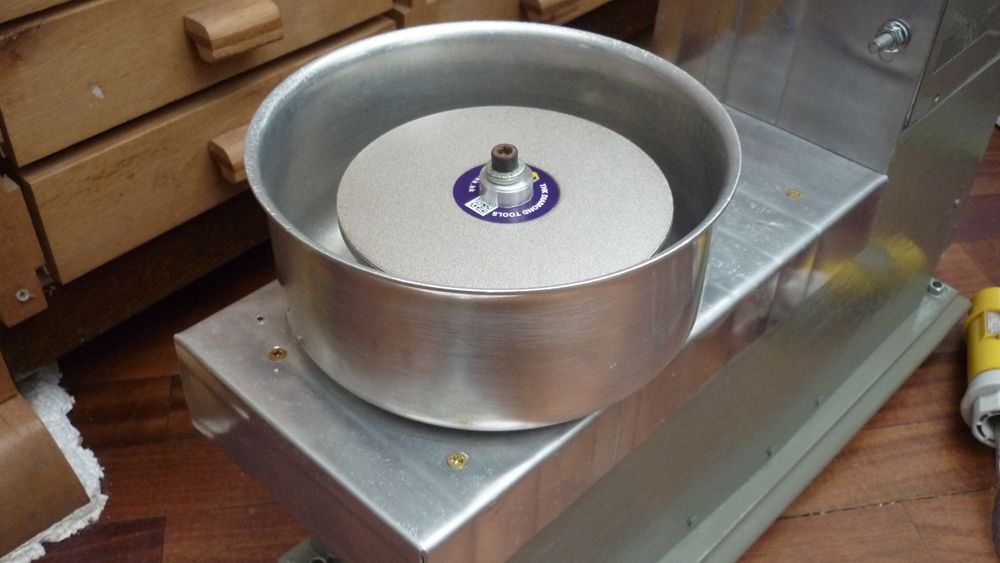

            Ive used those diamond discs from Hong Kong , they are cheap and very good. I was using them on this contraption i put together to grind mother of pearl. But ive used them dry and wet on lathe bits carbide tips and allsorts of steels . They cut very fast and with light pressure never had the so called problem of steel dissolving the diamonds.
            I had a water drip feed fixed to the back of it also put a tap on the bottom of the old aluminium pan. Controlled with a variable speed dc motor.
