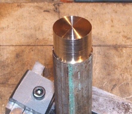

                          I’ve used the Diamond tool for three or four years now and hardly use anything else. Aside from a parting tool and boring bar I hardly use anything else

                          I have gone and purchased the tool and tried it out ,what a pleasure to use and to sharpen it is so easy, I know the price is high but as modeng 2000 states you soon spend the same money on other tools,looking forward to using it more often

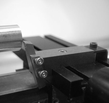

                                Hello Group,
                                Here’s my implementation of a tangential tool holder on my Sherline lathe.  I  adapted my design from an article by Marcelo Jost in the January-February 2008 issue of “The Home Shop Machinist” .  He was inspired
                                by an article in Rudy Kouhoupt’s Shop Wisdom volume 3.
                                I’ve been very pleased with it’s performance.
                                David Clark in Southern Maryland, USA
                                #42685
                                chris stephens
                                  @chrisstephens63393
                                  Hi David,
                                  An excellent interpretation, do you have clearance problems on larger diametres?
                                  chris

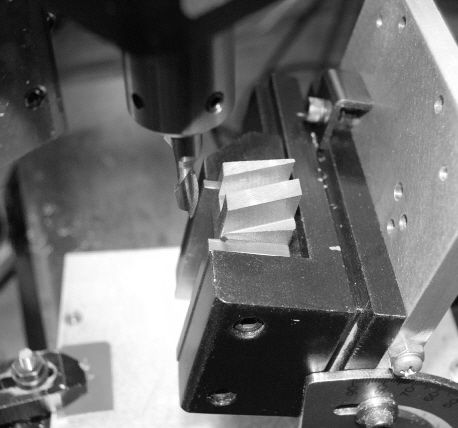

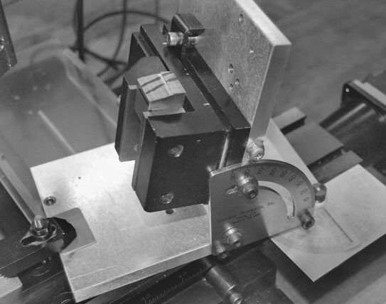

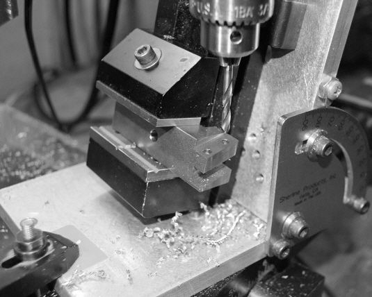

                                        D.C.Clark
                                          @d-c-clark
                                          Thanks Chis,
                                          The tool holder does not interfere with the maximum clearance between the Sherline spindle axis and the top of the cross slide table.  For larger diameters, those that extend below and in front of the table, the tool is limited to facing and about 3/4 inch of turning.  This could easily be extended, but I would make the tool holder wider for greater stiffness.
                                          Thank you, Keith, for correcting me on the year of issue.  I’ve attached some “in process photos”.   As you see, I created the double compound angles by using Sherline’s tilting angle table, rotated on the mill table.  This allowed me to machine all the angles in one setup, only changing the position of the the mill vise on the angle table.  The material was 12L14 steel.
                                          Layout and roughed out.
                                          Double compound angle setup
                                          Milling the front face
                                          Drilling holes for clamping screws

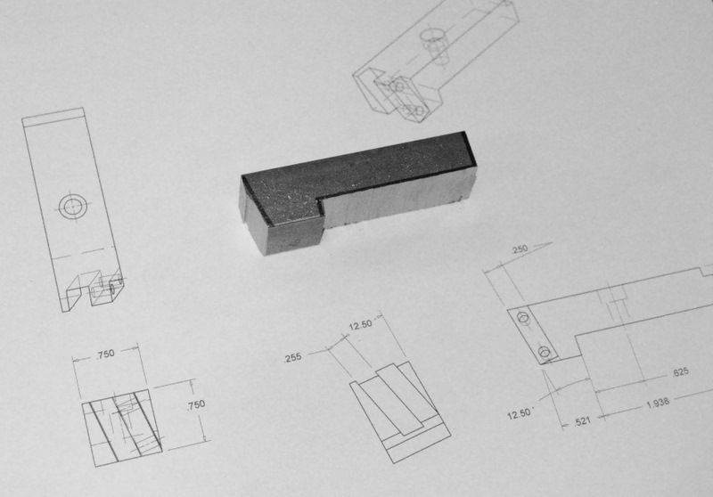

                                            #42719
                                            david sympson
                                              @davidsympson63483
                                                     Hi George
                                                                       I made  four of these tools about  20 years ago after buying a pre-war
                                              commercial one at a car boot sale. I made two with straight shanks one to fit a Dickson
                                              quick change tool holder and one to fit a quick change of my own design
                                                 The straight shank ones have had very little use but the two others have had 20 years
                                              hard use and I dont know how I managed without them
                                                                                         Dave Sympson. 01430 861623 YORK area
                                                                                         [email protected]
                                              #42803

                                                Hi All fans of Diamond tool-holders,
                                                For those of you how mistakenly think a Diamond/Tangential toolholder is a new or novel idea, take a look at the picture , hopefully, below. It is an image from a book dated 1886, just goes to show “there is nothing new under the Sun”. Looks kinda familiar, don’t you think?
                                                chris
