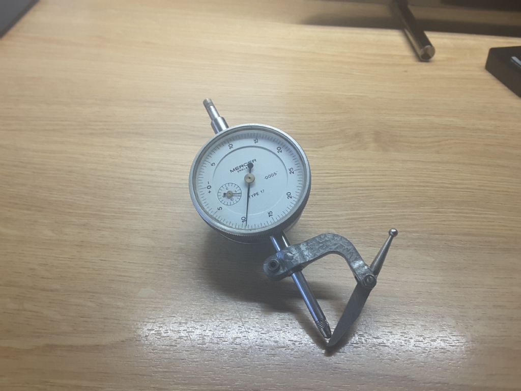

                This is an attachment for my Mercer dial indicator. I have longer fingers which screw into the attachment to give longer depth.
                David

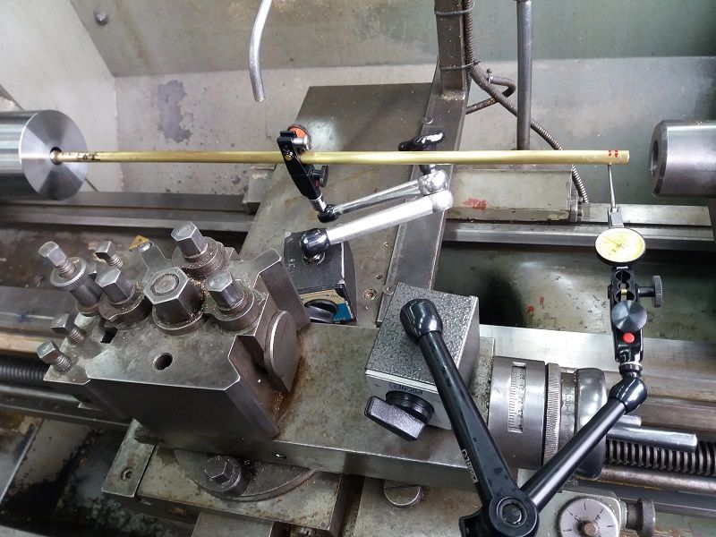

                        Had a slightly similar situation where I needed to get down inside a bore to verify the various errors to ensure that I had enough room to re-machine a podged up taper. I setup the seesaw probe out of a Starrett Last Word indicator kit and an indicator on my lathe cross slide using a magnetic post mount.
                        Something off a KTM enduro bike I think. I was very lucky that the Pratt Bernard precision 3 jaw held it accurately enough to dispense with for jaw games.
                        The Starrett kit uses a back plunger indicator **LINK**
                        https://www.starrett.com/metrology/product-detail/196A5Z
                        so the mounting stalk gets in the way on a set up like this.
                        Using the cross slide feed effectively extend the range considerably. A DRO set up would be most accurate but my cross slide screw and nut are good enough to use as is for better than ± 0.5 thou overall.
                        I see no reason why the measurement arm could not be made rather longer to increase the operating range but the set up is likely to get very twitchy if you go too far. 10 to 1 at 1 thou per division accuracy is theoretically possible using a tenths thou indicator but the chances of it being stable enough to actually use are slim. 2 to 1 is probably OK.
                        The Starrett see saw has small spherical contacts at each end and the plunger indicator has a dome end contact. This increases the angular movement range before cosine error sets in. Calculating the effects is possible but not as easy as it might seem. Size matters! In practice anything significantly more than ± 10° or so has the see saw end running off centre round the plunger end so things start to mis-behave and it all gets a bit fraught.
                        Bottom line is it all worked but I din't want to do it in the first place and, frankly my dears, I'd rather not do it again!

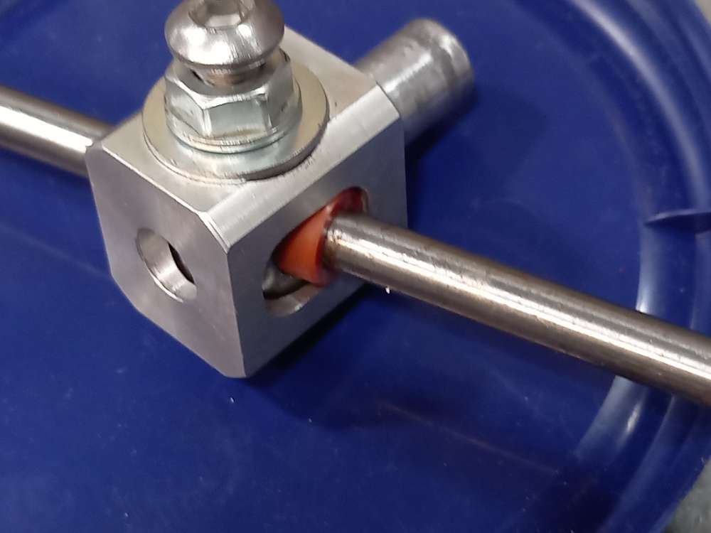

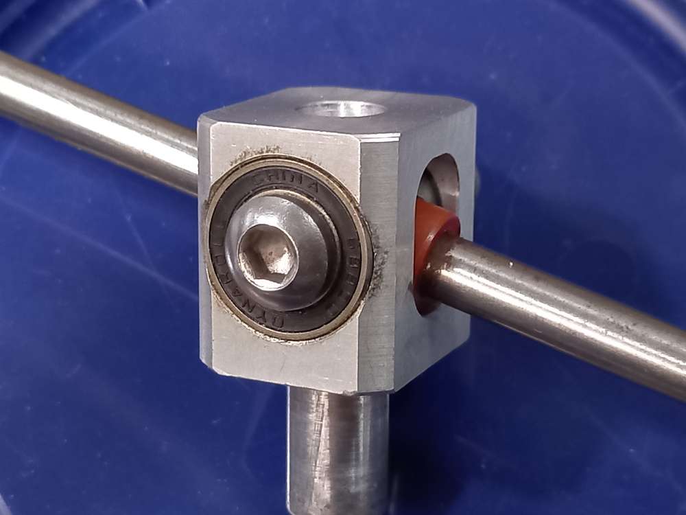

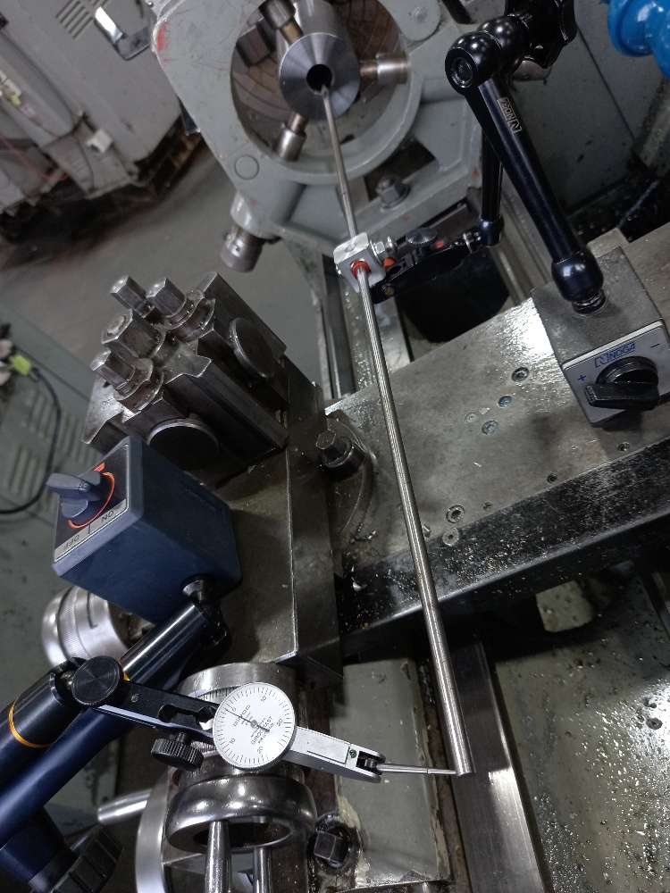

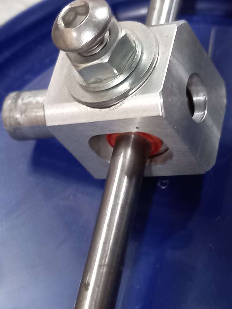

                                                    I made a bearing pivot some time back.

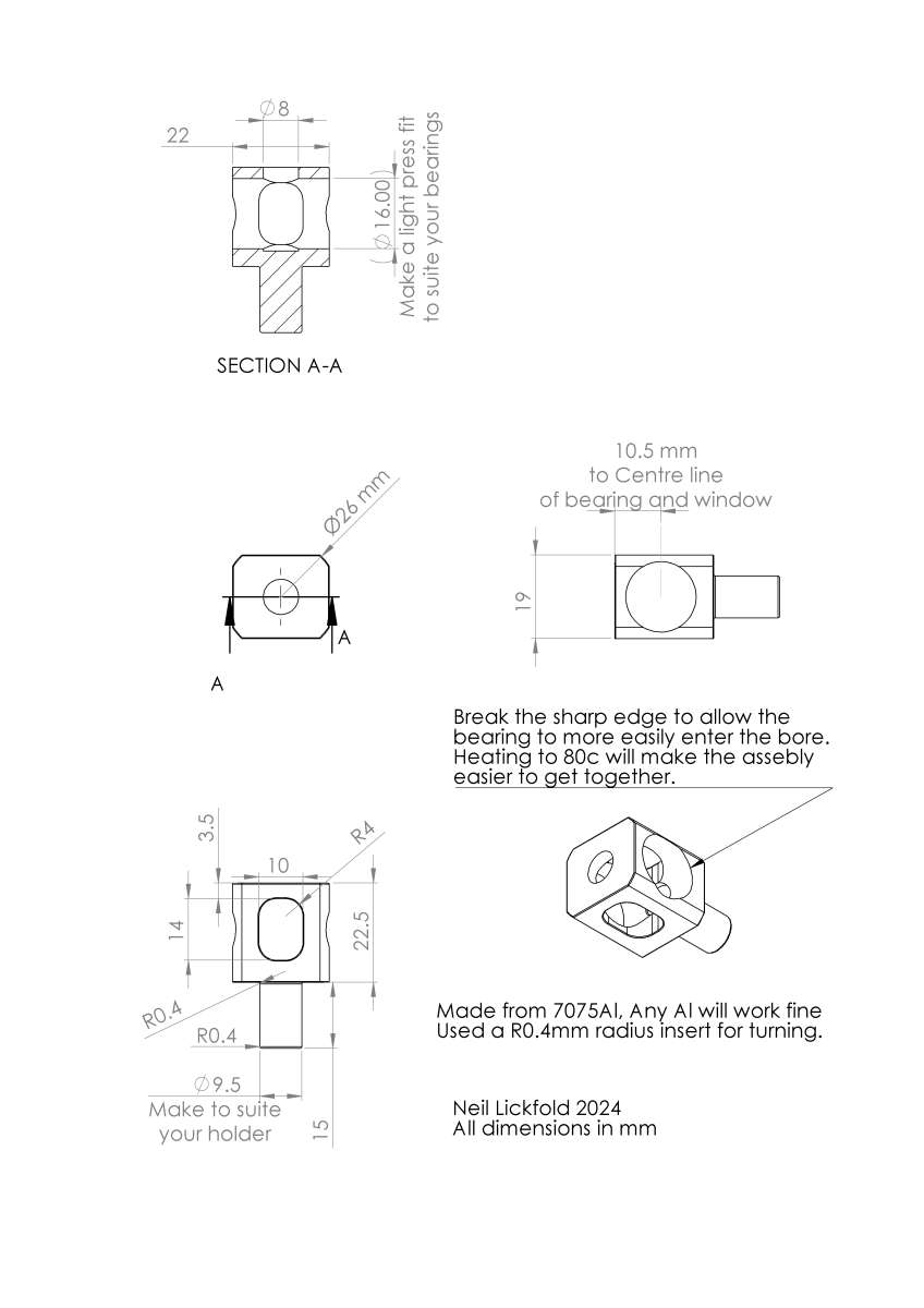

                                                    It is a housing that is bored through at 16mm to be a neat fit to hold the outer race of a 688 sealed bearings, 8x16x5
                                                    The base of the block is 9.5mm diameter that suited the Noga stand I was previously using with a Brass tube and a hardened disc.
                                                    The block is made from a piece of 7075 Al that was at hand, with the outside of 26mm.
                                                    On the opposite end to the 3/8 shaft section, it is a hole, Ø8mm x 19mm deep. This is for a 8mm dowel pin and is used as a reference for cutting the flats on the body.
                                                    The flats are 19mm x 22mm.
                                                    After the pin is removed, I drilled through with a 13mm drill in the mill, at 10.5mm from the end face and in the middle 19mm flat. So the hole is 22mm long . With an 8mm cutter, cut out the window for the pivot arm in the centre of the 22mm flat, so at right angles to the 13mm drilled hole. The window is 10mm wide and 14mm high. It’s centre line is also 10.5mm from the end face.
                                                    The 10.5mm is not important, just that the material I had was a little shorter than ideal. I kept the rectangular window central to the centre line of the bearing bore.
                                                    It is +-1mm wide with the cutter and +-3mm vertically. Making the slot 10X14
                                                    Instead of boring in the mill, just used the 4jaw and bored in the lathe.
                                                    The inner pivot pin, is made from steel, is 15mm in diameter and total length is 22mm.
                                                    Each end is turned a nice slide fit to the 8×16 bearings and the spigot is 4.95mm long. 0.03mm shorter than the bearing thickness. The bearings measured 4.98mm thick.
                                                    The end is drilled and tap for M6 thread. One end is retained with a domed 6mm hex screw. The other end has a longer screw and a nut. The screw also secured the pivot arm once it length is set, and the nut and washer keep the inner of the race secured.
                                                    The cross hole is done with the 4jaw chuck in the lathe and is centred in the middle of the piece. I bored it 9.53mm through so that it could still use the brass tube pivot rod from the original setup.
                                                    A nylon insert was made that is a neat slide fit into the pivot pin, and has a 6mm hole to suite the 6mm silver steel new pivot arm. It needs to be locked with the side screw to prevent any excessive wobble occurring while being used.
                                                    The bearings are placed on the pivot pin, and with a tube, the outer ring is pushed on, to get the assembly into the middle of the body. I pushed onto the outer race, so that they are both assembled effectively being preloaded towards the centre of the block. This is to make them a bit like an angular contact bearing, so that there is no wobble at the end of the pin once all assembled.

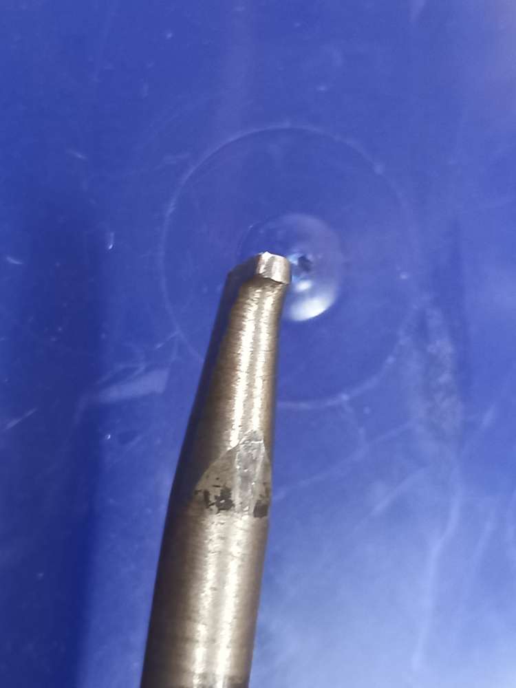

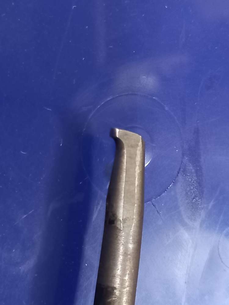

                                                    The pivot rod is made from a piece of 6mm silver steel 590mm long, that was heated, hammered a bit, shaped, then the end hardened and tempered, and polished. The smoother the better. On the same side as the hammered end, is filed flat for the indicator to rest against.

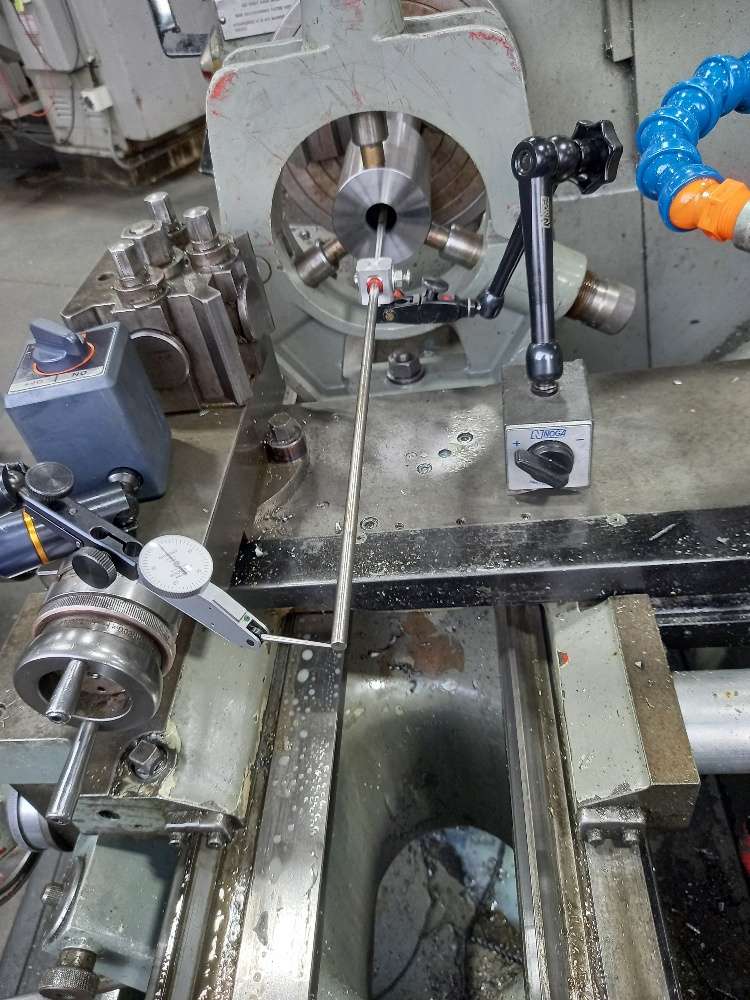

                                                    This new assembly is very free moving, and the pressure from the finger clock, is enough to keep the end in contact with the workpiece.
                                                    I test it on the end of the work piece, a bored area, to see what the reading range is, manually rotating the chuck forward and reverse seeing how it behaves. I find the low point with the cross slide.
                                                    Then when down into the hole, again use the cross slide to centralise in the hole and dial to as close as possible. Repeat the centralising and keep adjusting the chuck as needed. It is not perfect, but can get the end of the hole to within the roundness of the hole , usually less than 0.05mm indicating range.
                                                    I was thinking that I needed a ball arrangement like in DTI pivots etc, but this works very well and has not needed any readjusting of the outer races.

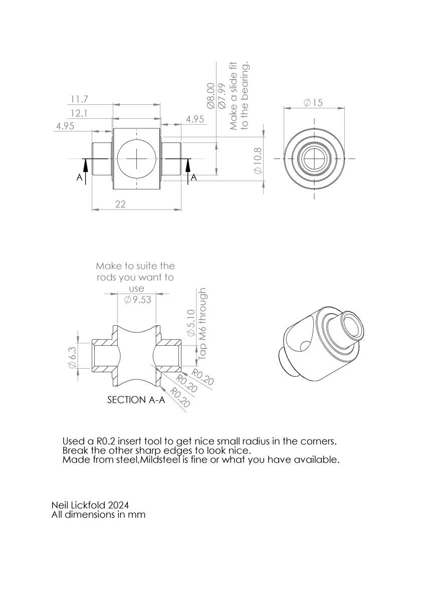

                                                      Here is a sketch of the body and the pivot pin that I made.
                                                      A copy is in my Album.
                                                      Pivot-Body-Neil LickfoldPivot pin-Neil Lickfold
