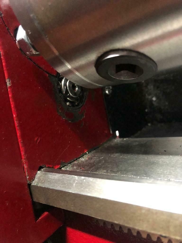

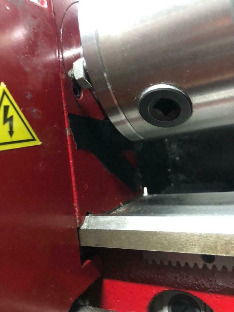

        Hi Folks.
        I’m currently unable to work on medical grounds. I did my apprenticeship in machining, but strayed into maintenance engineering, to my eternal shame. Anyway, I really miss machining so I’m desperate to set myself up a mini lathe, to have something to do whenever I am able. Unfortunately, times have tolled and the budget is obscenely tight, mainly selling prized possessions to finance it, and even that isn’t half what I’d be looking to spend under any other circumstances. So, that’s the desperate times…
        Now, an Amadeal CJ18A has come up that I can afford. Some obvious concerns, but I’m prepared for it to need a bit of work. The chap has upgraded to the metal gears, but says a cover has broken somewhere along the way. He’s covered the area with tape to prevent ingress, and says it doesn’t impede functionality.
        I guess my whole post here is to see if anyone in the know might see anything fatally wrong, or perhaps can provide insight into the journey that may lay ahead in the repair? I don’t mind desperate measures, but I’d rather avoid pointless ones…
        Cheers
        Jay
        Here’s a pic of the taped up area, and uncovered pic below.
        Taped upOpen wound
        #508446
          Looks like the shield has come off the 91p bearing so not too expensive to replace, I'll leave it to others to explain how to replace as unfortunately that bit is not shown on ARC's strip & rebuild guide.
          Though if no dirt has got in and it's running OK, I'd get a bit more tape.

            I is just a swarf shield for the front bearing, but the spinel has to come out to replace it. It is just a plastic shield, easily broken of a little hamfisted when refitting. Better to leave it in place unless you want/need to change the bearings. If you want to proceed you have a cholce on the bearing types, normal balll bearing, angular contact, or taper roller. I stick with normal ball bearings as that is what is fitted as standard and the machine, not this one, does what I want it to do. Plenty of discussion and preferences on here as to bearing type chosen.

              Posted by JasonB on 19/11/2020 13:26:25:
              Brilliant, that was my thought also. Thanks for that Jason.

                  You can have some fun designing and making a metal replacement. Then attachi it with double sided tape until one day when you do decide to strip all and drill holes ot screw it in position through the lugs you so sensibly incormorated into your design.
                  Bunch of other people would 3D print something.
                  Worst case is the bearing gets contaminated and damaged eventually but as it is just the layshaft it is not too serious and can just be replaced by a cheap bearing.

                                I have the same CJ18A lathe and replaced the main bearings and plastic gears on mine earlier this year after I stripped one of the plastic gears.
                                There is a plastic cover over the main spindle bearing held on by screws. This has a cut out at the bottom to clear the bearing for the input shaft. This cover looks ok on your photo.
                                The tape has been put on to cover the end of the input shaft which on yours has either an open bearing or a sealed bearing with the built in shield missing. Mine has a shielded bearing with no other cover.
                                Either way, fit either a plastic or metal cover over this as has been suggested.

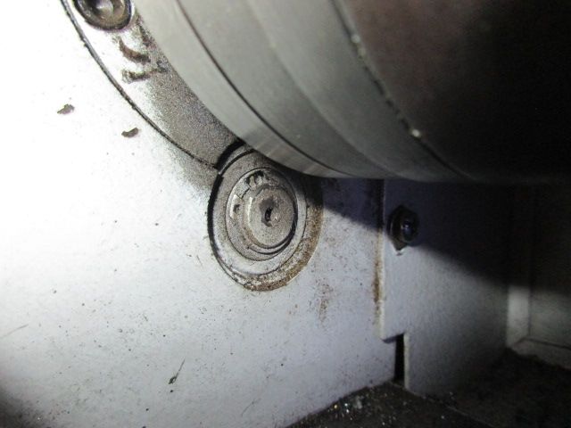

                                                    Hi jay, just though I'd post a photo of my Chester mini lathe one, this has the seal intact.
                                                    Regards Nick.
