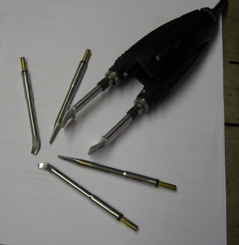

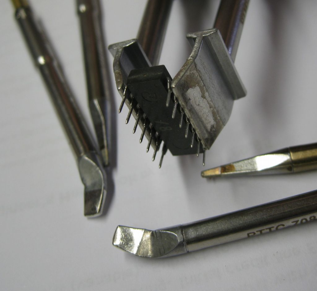

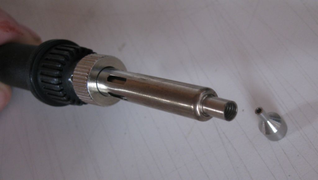

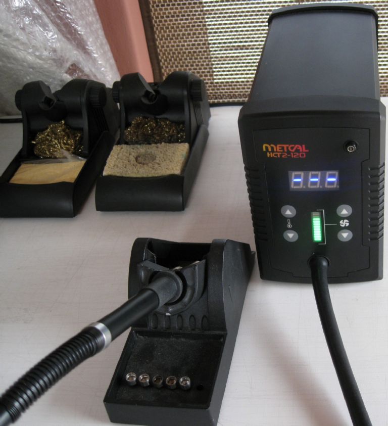

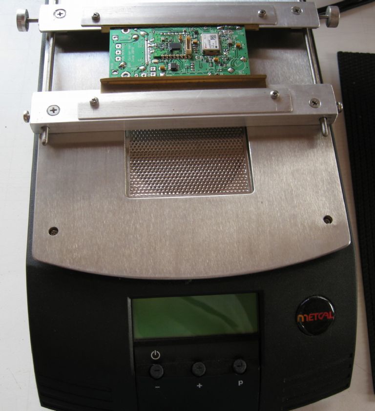

                                  Joseph Noci 1
                                    @josephnoci1
                                    I use solder wick extensively – once you have the feel, it works very well. A HOT iron, with sufficient thermal mass, and quick work..
                                    Also use a solder sucker for things like the 1 or 2 mm square legs of big transistors on power amps – else cut the legs and remove easily one by one.
                                    For finer stuff I use these tools ;
                                    A board pre-heater-
                                    Hot Air pencil ( goes to 450deg C)
                                    From 6mm to 1.5mm orifice.
                                    And most useful of all for SMD work, and for DIP IC removal. Tips also available for QFN, etc..
                                    Metcal Tweezers, up to 40watts /tip
                                    Joe
