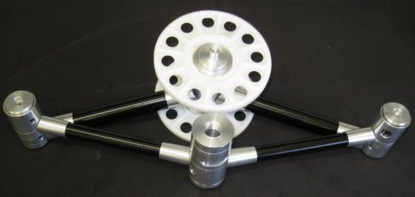

                                    Well, we will have to see what develops with Fusion – in the meantime I have progressed in my use thereof and am actually quite impressed with it. I am quite comfortable in transferring the 3D image in my head onto the screen with Fusion- far easier than CATIA and Solidworks.
                                    And so the Morgan par-arm printer is progressing – I have modelled the arms, pivots and bearings, and managed to make the arms and sockets. Pivots are next..
                                    The arms will be driven by those amazing ClearPath AC- Servo-motors that behave like steppers but are fast, closed loop and very powerful. Both arms will be driven by a 15mm diameter steel gear on each motor, driving a 130mm diameter PET gear on the arm ( actually an ALIGN large RC helicopter rotor drive gear). tests so far show no discernible backlash..time will tell. The Z axis ( still a lonnggg way of in my mind..) will use a normal stepper.
                                    Each arm pivot uses 3 ball thrust bearings, as does the tool pivot. The main arm pivot uses 4 pre-load Ball bearings.

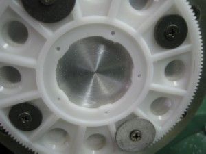

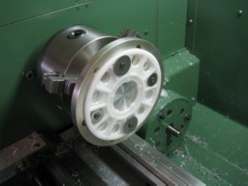

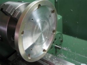

                                    The jig made to hold the PET 130mm diameter gear to machine the center hub concentric.
                                    The gear outer fits snugly in the jig.
                                    Machining the gear hub:
                                    The centre machined to be concentric with the outer gear circunference.

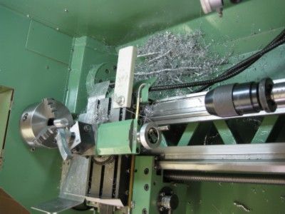

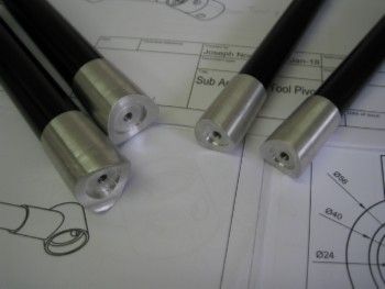

                                    The arm pivot sockets all drawn up and raw material ready to start..
                                    Machining the pivot sockets:
                                    NEVER let it be said that my machines never see swarf!
                                    The arms fitted with Pivot sockets:
                                    End of the sockets will fit onto the Pivots which house the thrust bearings – more to follow as we slowly progress..

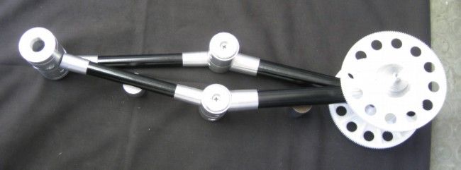

                                                I have made 'some' progress on the arms and pivots for this 'printer'…
                                                I will create a new post next time round to try decontaminate the rest of the 'progress'..

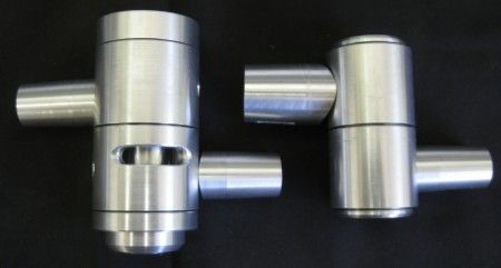

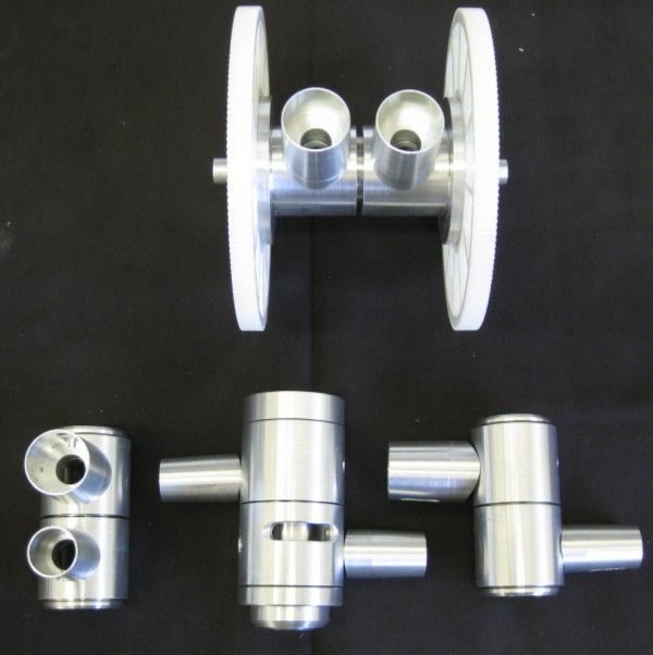

                                                I made all the arms, arm sockets, and the various pivots – the main drive pivot, the two elbow pivots, and the tool holder pivot. The main drive pivot uses 4 preloaded ball bearings, and the elbow and tool pivots use 30mm OD and 35mm OD thrust bearing respectively.
                                                All are preloaded to ensure the assembly is stiff to prevent any tool head sag, co-planarity of motion is also important for obvious reasons.
                                                And LOTS of swarf was made..

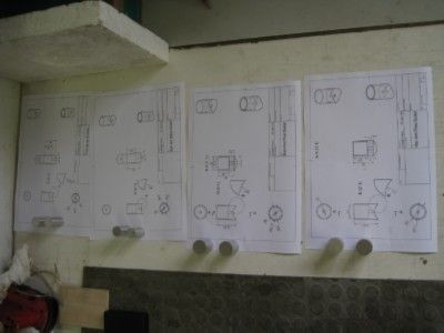

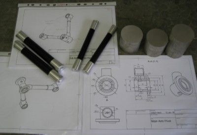

                                                The arms and sockets – not yet loctited..and Raw stock for pivots, and drawings from Fusion 360.

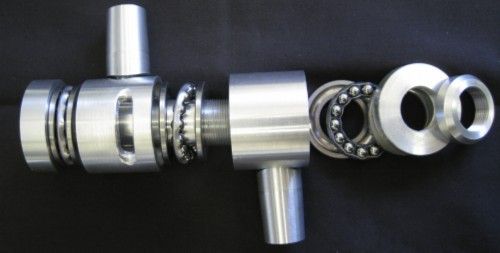

                                                The Tool Pivot, exploded view..Has a central 18mm hole through which the extruder head passes the filament.
                                                The idea is to have the hot end below the pivot, and the nozzle/hot end be inductively heated – working of a prototype of that concept and has great promise..

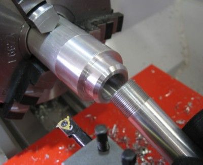

                                                The central tube in the Tool Pivot – threaded using my ELS on the 14D with multifix retracting tool holders..

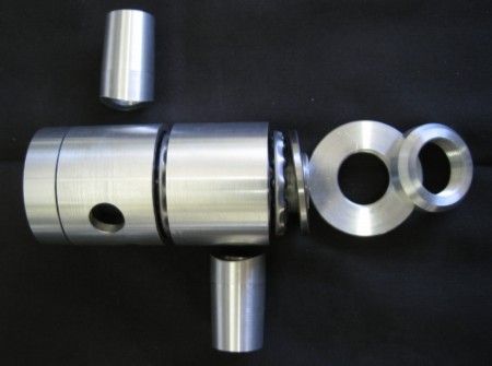

                                                Part exploded view of one of the two Elbow Pivots. The short tubes, as above, are the sockets into which the tubing arms fit. These socket will be TIG welded onto the pivots and the tube arms inserted , in a jig to ensure length and co-planarity are met, and loctite applied
                                                Tool and Elbow Pivots part assembled, not yet welded..

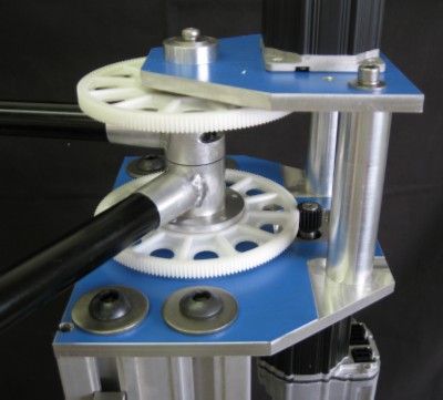

                                                The drive Pivot is uppermost in the image below – fitted with the main reduction drive gears – 140mm diameter gears, from an Align 700 RC helicopter main rotor drive.
                                                The Left and Right Elbow Pivots are seen, with the Tool Pivot between.

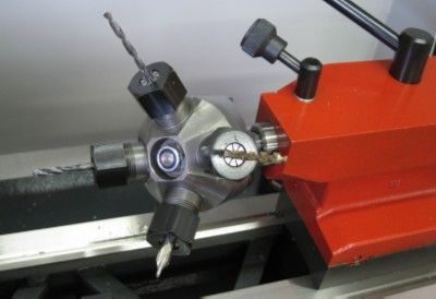

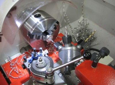

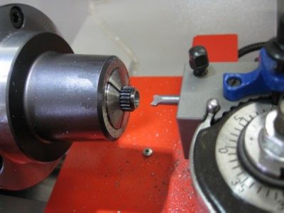

                                                First time I used the new lathe's Tailstock Turret – had a handful of threaded bosses to make, and it came in very handy!
                                                It uses ESX16 collets…

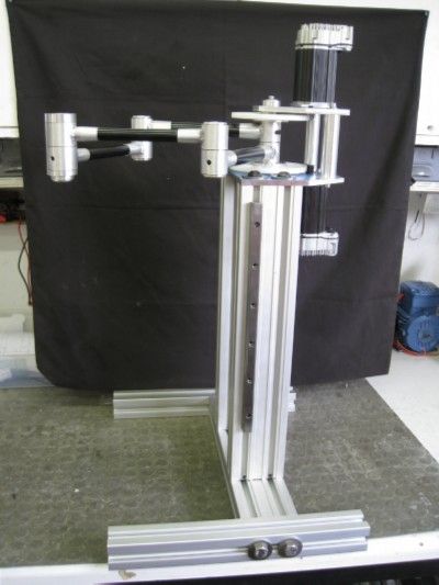

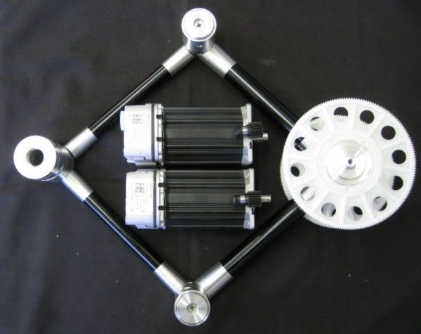

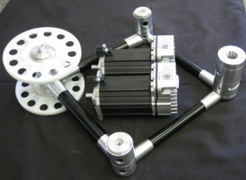

                                                Mockup of assembly with the drive motors – TEKNIC AC Closed loop Servo motors.
                                                The mating drive gear that fits to the motor shaft is visible atop the motor casing at it's shaft end.

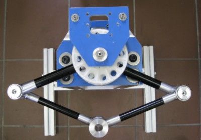

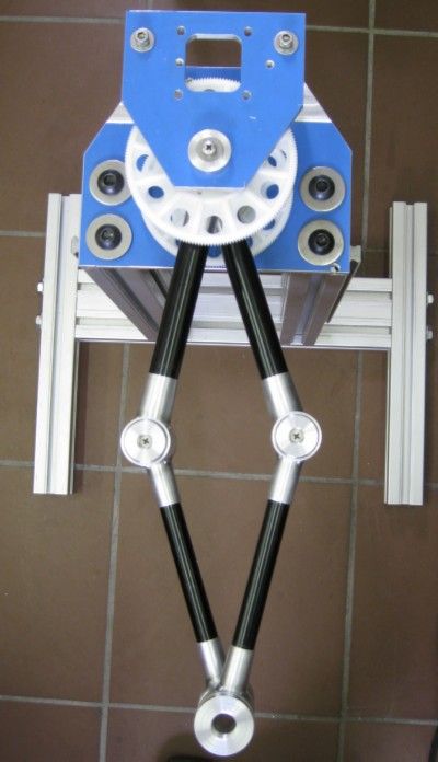

                                                More assembly mockups:
                                                Arms closed
                                                Arms open
                                                Then start on the support frame work to which the drive pivot mounts, as well as the two drive motors.

                                                      Some further progress on this thing..
                                                      Built up the main frame and mounting plates, and fitted the arms and motor. Bored out the drive gear using, for the first time..the Bison Set-True 5C collet chuck – worked a treat!
                                                      The Z axis is still to be done, but not going to do that effort until I have got the maths and Kinematics working, and that the control software can position the arms correctly and accurately. If I fail, no time wasted on Z!
                                                      At least the arms and the whole frame is very stiff and rigid!
                                                      Side view – Z slide rail is visible.
                                                      The gear train and drive head
                                                      View from top, arms almost fully open
                                                      and closed a little
                                                      A video if, and when, it swings arms..
                                                      Joe
